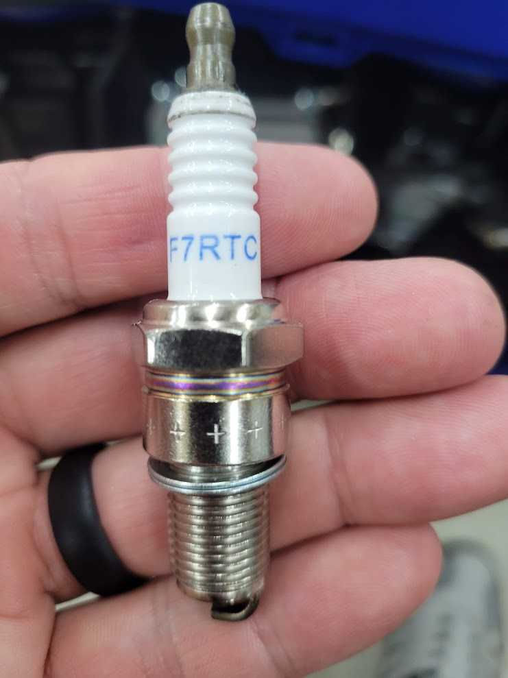

nah, it has a carb. I think the "i' is two fold, people think anything with an 'i' is cool, and it's also an inverter generator, and I think that's really what it's for.
And it's odd, that it lists the plug as a resistor type. F7RTC with also crosses to other resistor types.
/ Your last generator Maintenance Run #6,802
yeah, definitely a resistor plug installed. The manual contradicts itself. Specifically lists (and has installed) a resistor spark plug part number, while also saying not to use a resistor plug.
I emailed the company, last time it took them several weeks to reply.
Thanks.... let us know what the Response is !
Rgds, D.
