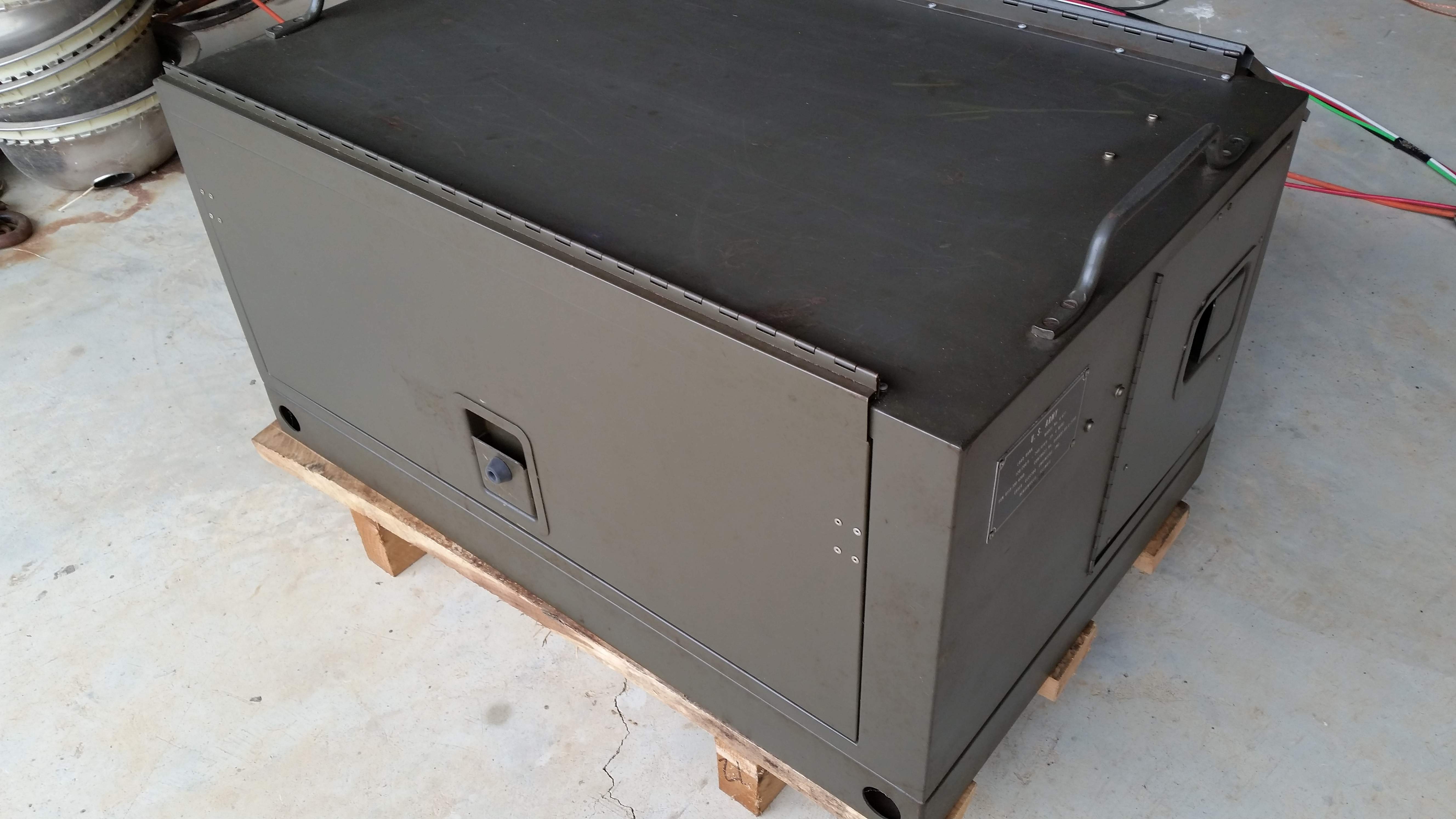

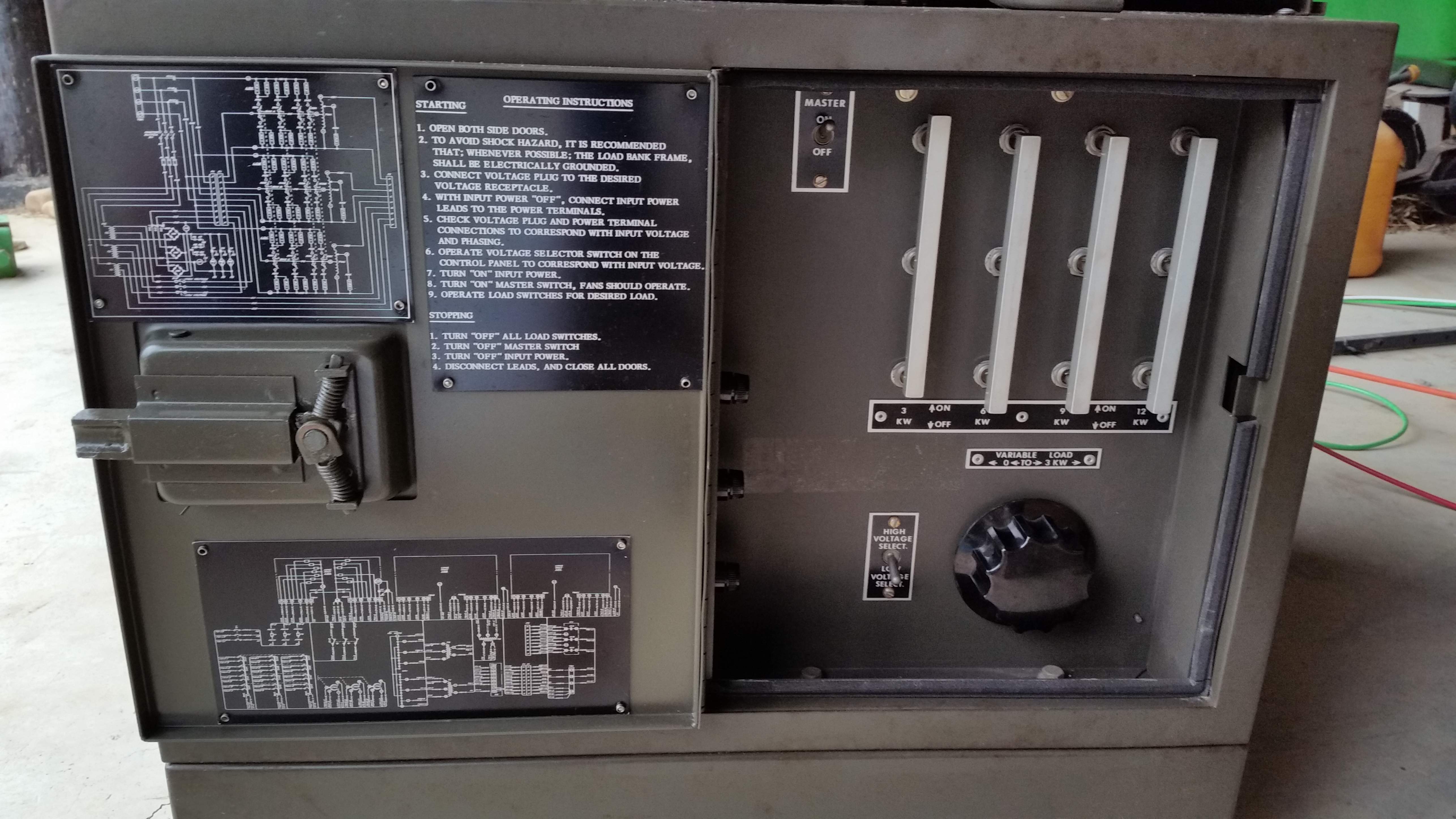

Howdy,
A surplus military load bank (Essex Electro Engineers A427 0-33kw) single phase and 3 phase
   / Your last generator Maintenance Run
#477
Howdy,
View attachment 433526View attachment 433492
Now, that's a load bank !
One downside to hanging on TBN is that I keep finding New Toys I Want :shocked:
aka..... Critical Maintenance Tools.... depending on who is listening :)
All drooling aside.... it is fun to see what you get to play with when budgets are virtually irrelevant. In past for-hire work, I've made do with everything from dead batteries, light bulb arrays, and even a carbon pile..... watts is watts, but pushbutton at that power level would be fun.
Thanks for the equipment details and pics Mike !
Rgds, D.
