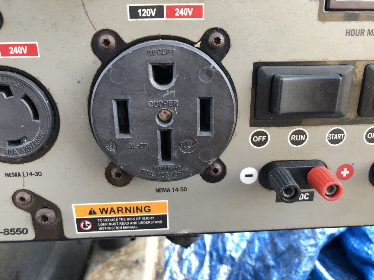

Mine is wired to the panel and on a cheap HF plastic dolly that only two of four wheels pivot. I roll it to the edge of my shed (basement extension) to be sure the exhaust vents outside.
Really need to fab a custom dolly. I have the casters and the metal... just need to draw up a plan and weld it together. A hood would be a nice option. That project just keeps falling lower on the priority list.
Weight of mine is about 375lbs before fluids. With no dolly it’s a struggle to move by myself. I rely on my tractor to help me move it. It stays on the pallet, I just slide my forks into it. A doghouse is the best option for me.

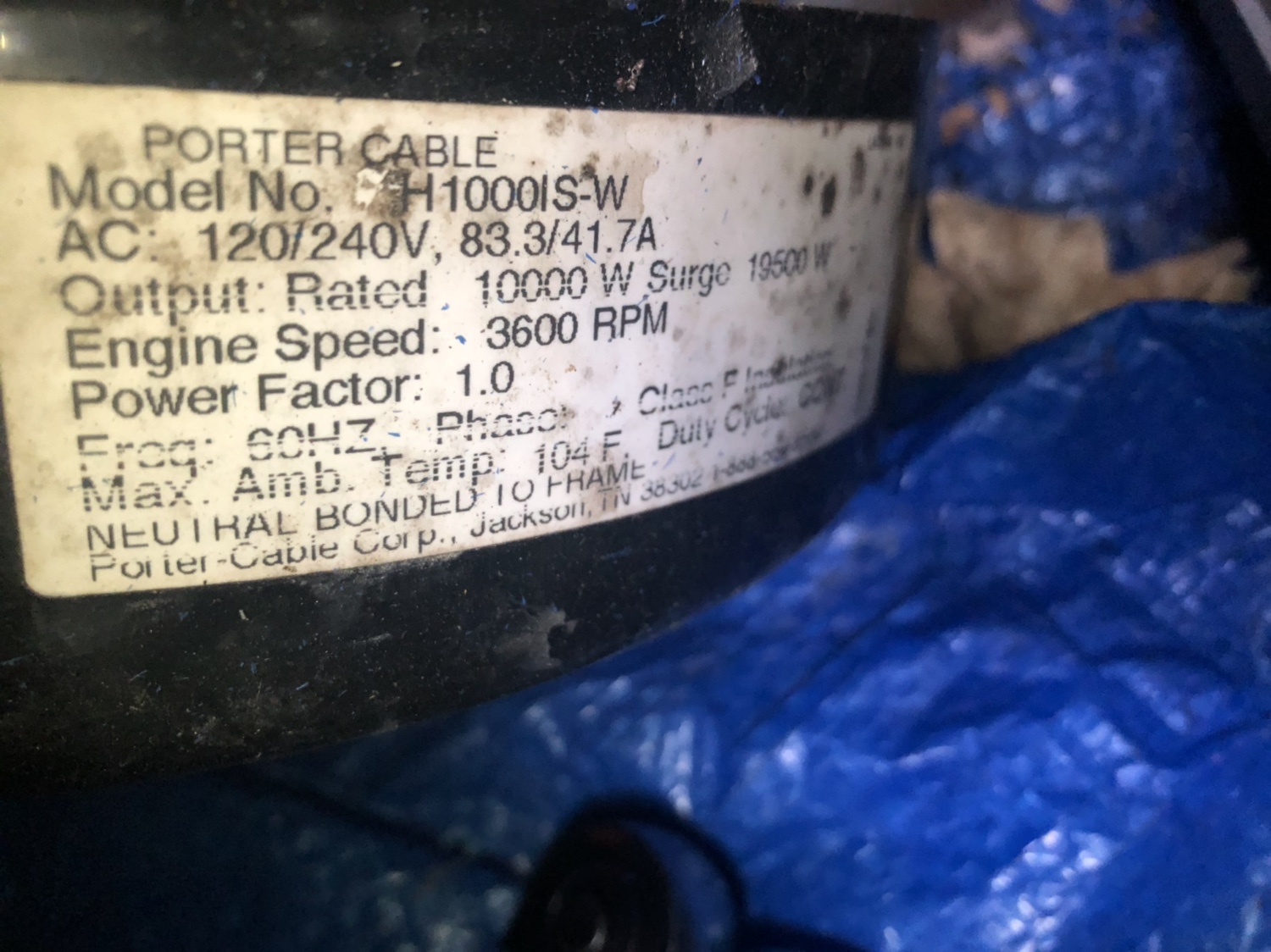

Side note- I just found out that this genny is a bonded neutral, now I gotta figure out if I need to break that bond for my setup (4 wire, two hots, neutral, ground) or if it’s ok to run it to my panel like that. The 240v outlet isn’t a GFI so it *should* be ok wired as is, but I need to do more research. Cloudy subject.
Side note2- tested output yesterday, only getting 100v from the 120v outlets, and only 200v from the 240v outlets. This is a brushless gen head, so I pulled the 55uF capacitor, measured it on my multi meter and it’s only showing 25uF. Porter Cable discontinued the caps, so I found one that very closely matched on Amazon. I’ll wire that in and retest my output. Hoping that fixes the voltage issue.
I’m getting 5v to the capacitor which makes me believe that the gen head is still good. (3-5v is what it’s supposed to be)
There should ONLY be ONE place where Neutral and Ground are bonded together. If its bonded anywhere else, you need to unbond it on the generator.

The plug is four wire, but on the end of the generator head in faded writing it says “neutral bonded to frame” which I assume means bonded to ground since the frame is also ground.
The plug is a 14-50. Pics attached.
I have the panel wired to the generator plug as two hot, ground, and neutral. I believe this to be incorrect since my panel has ground and neutral bonded already. I’ll need to break the bond at the generator. Maybe I can put in a lockout switch for use when the generator isn’t powering the house (very unlikely)
Luckily I haven’t used this generator for the house yet. Still sorting the details.

If the ground is the same gauge as hot or neutral & insulated, you should be safe (can't comment on the to code aspect). The danger comes from having exposed or insufficient wire that overheats or could be touched as a shock hazard.
That is not why they say only bonding point.
The risk that you run with multiple bonding points is that the neutral breaks and now the ground wire (and the metal frame of anything connected to the ground) gets 120VAC running through it, waiting to shock someone.
