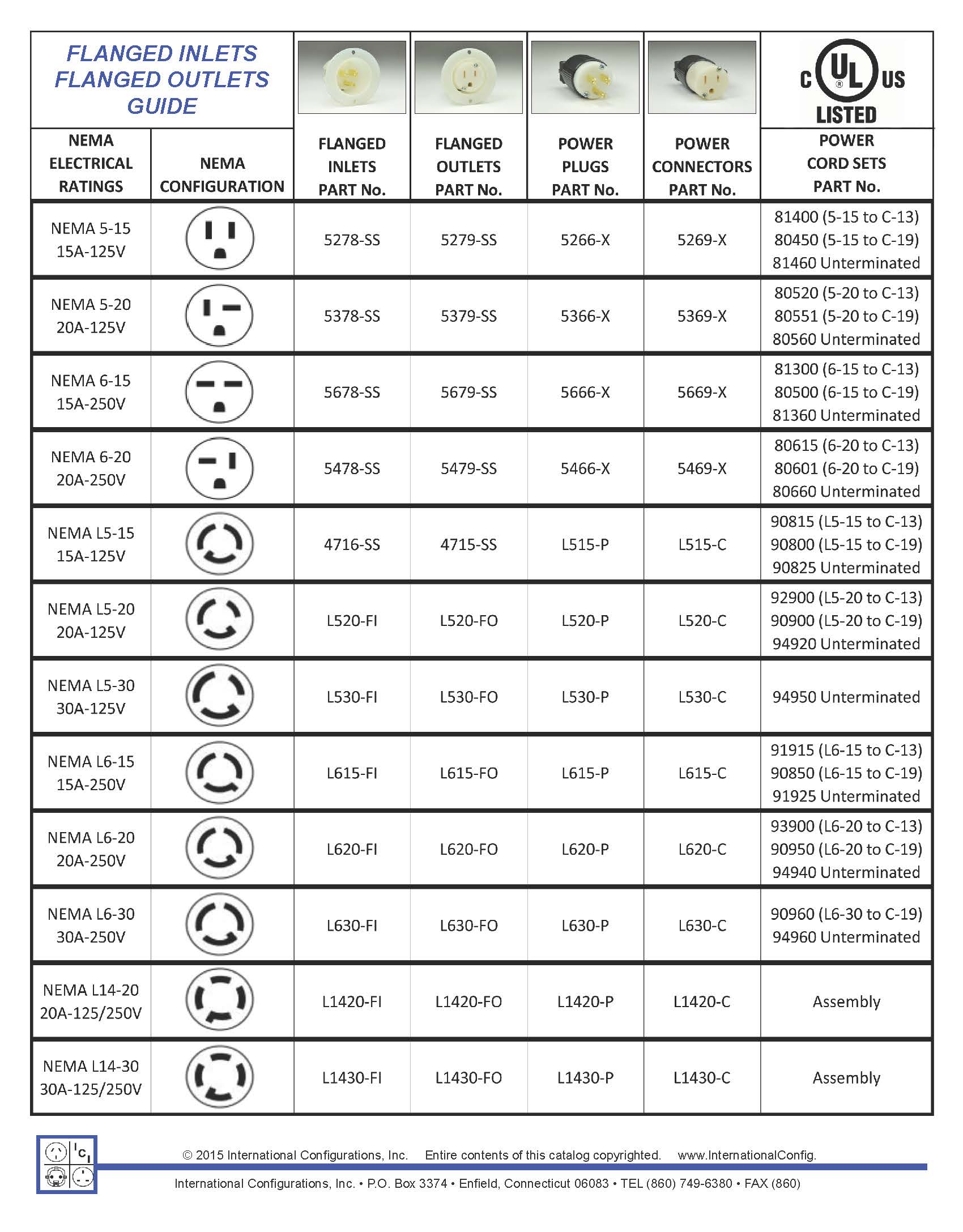

So is the 3rd prong on say the 6-20 ground or neutral?
   / Your last generator Maintenance Run #2,254
A nema 6-20 is a 240 volt plug. It had 2 hots and a ground only, as there is no neutral.
   / Your last generator Maintenance Run #2,255
And the L14 series is hot-hot-neutral-ground. Personally I put in L14-50 outlets only for my welding gear or what not. More flexibility if I ever need to do something stupid like back feed the house. But also matches the outlet on my PTO generator so I dont have to swap plugs to go mobile.
Some old stuff like dryers & stoves used ground as neutral for their control boards, but used the 2 hot legs properly with no neutral/ground for heater elements. Not compliant with modern codes for valid reasons.

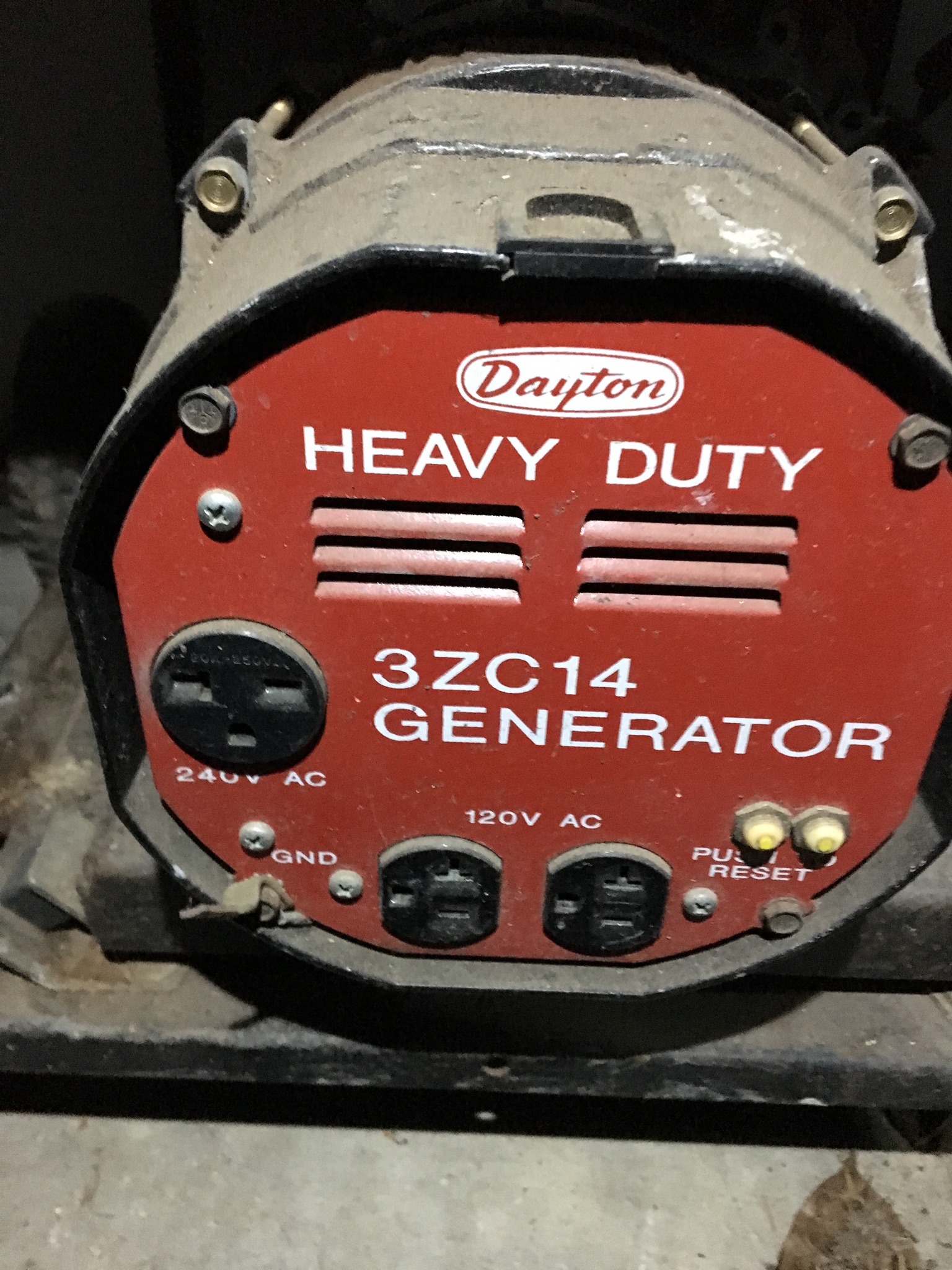

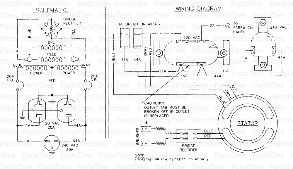

So using a generator that has a 6-20 240V 3 wire outlet, the neutral only bonds at the breaker panel where you have all 4 wires?
   / Your last generator Maintenance Run #2,257
I have never personally seen a 6-20 recepticle on a generator. Most generators 5,000 watts or above have a L14-30 twist lock (4 wire). You have to supply the panel with a neutral wire. The 6-20 recepticle is used to power a device not needing a neutral.
   / Your last generator Maintenance Run #2,258
Here is one. Not over 5000, just rated at 3500 watts
