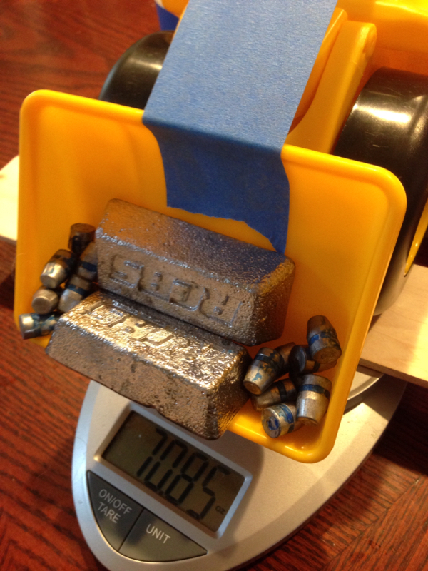

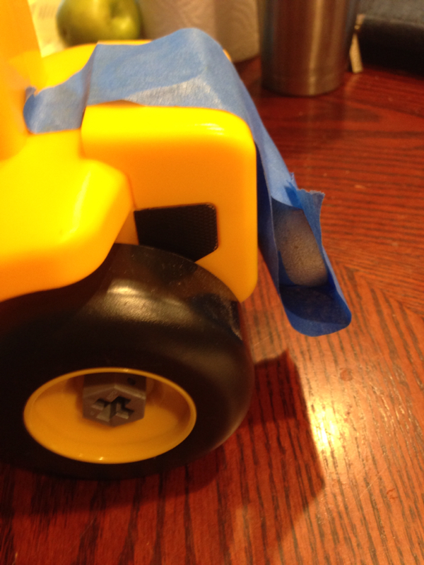

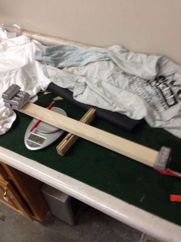

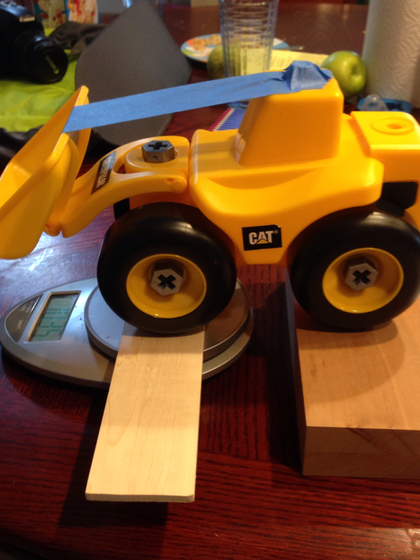

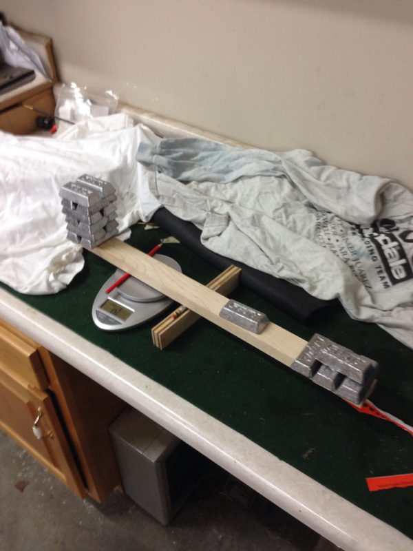

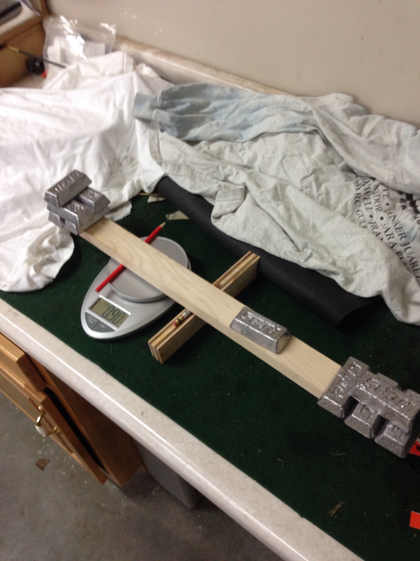

I did a small scale test using a toy loader and a kitchen scale. Let's pretend the lift capacity of the loader is 1 pound.
Machine weight with no ballast 17.1 oz
Front axel weight with no ballast 10.3 oz
Front axel weight with bucket loaded to tipping load with no ballast 27.1 oz
Tipping load was 9.2 oz. this is pretty accurate since most tractors will tip before maximum load is reached.
Now I added 11 oz of ballast.
New front axel weight 4 oz.
weight of front axel with previous tipping load 21 oz.
Here is the problem, I can now lift much more.
Weight of front axel with 1 pound load 34 oz.
weight of front axle with the ballasted tipping load 70.oz
Weight of tipping load 41 oz.
