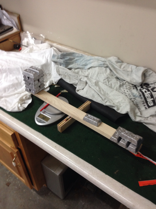

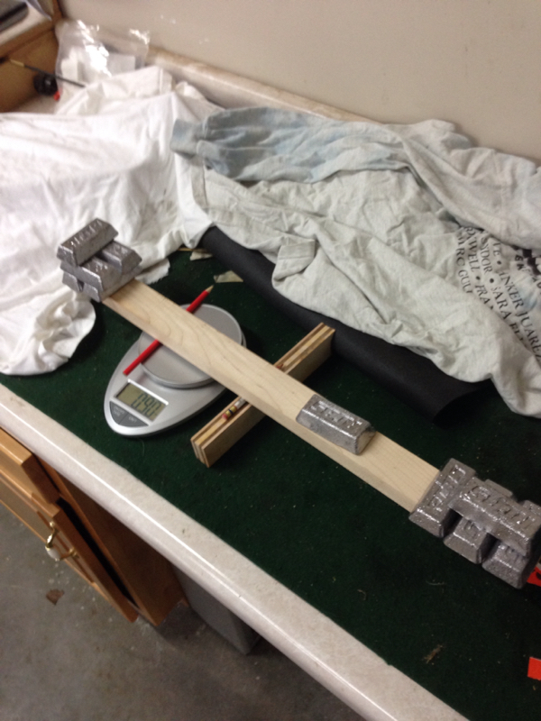

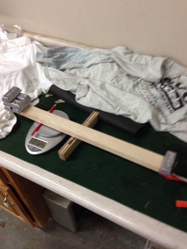

Here is a simpler experiment. The fulcrum over the scale represents the front axel.
In this picture the load is close to balanced with 107 oz over the front axel.
Now without moving either fulcrum or reducing the front load I can reduce the load over the scale to .9 oz.
The problem comes in is now I can stack way more weight in the front bucket without changing the fulcrum or changing the rear load I pegged the 10 pound scale.

Hard to trump an empirical demonstration like that. Very nice!

Well, there you go. If he don't get it after seeing this, he is never going to get it.
