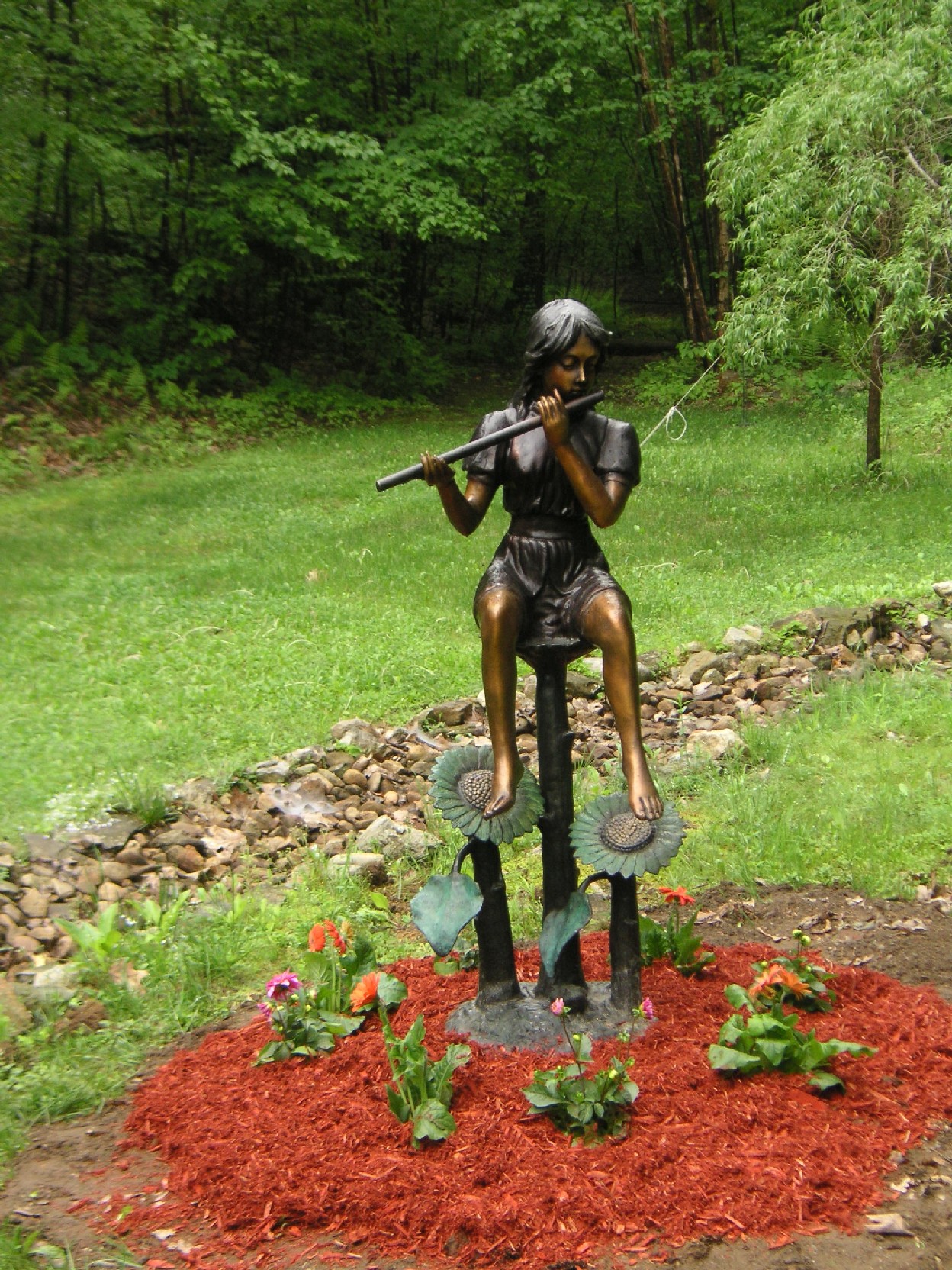

My wife and I are at the stage in our life where we really struggle to come up with Christmas present suggestions. We really don't want nor need anything. We have skipped exchanging gifts a few times due to this. This past Christmas we decide to get a statue for the yard. Our daughter is a flutist so we chose a girl playing the flute.
We wanted to mount it to a piece of granite. But even a hammer drill and a very expensive bit made little progress. So we built a form and set some rebar to make a base.
Pic one is mixing the cement. I purposely keep the hose away - i have a tendancy to make soup. The watering can works fine
After filling the form(pic 2) my wife smoothed out the concrete (pic 3)
After a week to cure we mounted the statue. She is bronze and weighs a bit so she got a ride in the tractor bucket while I drilled the mounting holes (pic 4).
She has nuts welded to the bass. So 8 inch long bolts and epoxy in the drilled holes and she was set tight.
Pic 5 is how she looks.

No matter how you made the base, that statue is a beauty.:) The red bark mulch just doesn't do it justice. You almost need a rock garden with a flowing waterfall to complete the scene.

Phil, beautiful statue. I'm a Landscape Architect, and we use similar statues on many projects. Your idea is exactly how we detail for contractors to install for us. It's about the best solution for security purposes. A thief would either have to ruin the statue to take it, or spend time busting concrete. Either way is not attractive to the thief. :)
The last project we did like this, the contractor did manage to get through about 18" of granite boulder. I'm pretty sure he used a hammer drill. But the mulch over concrete is a nice solution none the less.
