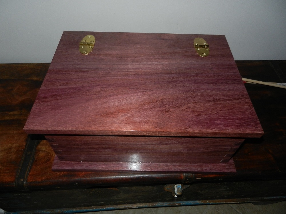

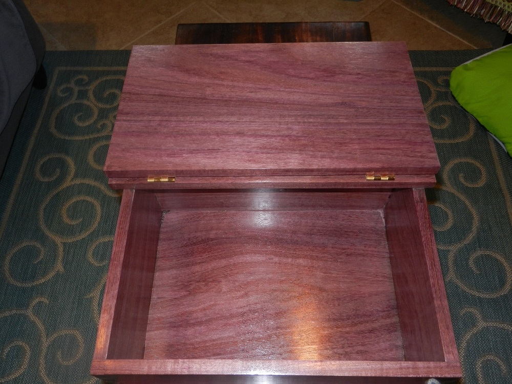

Number of years ago, I made a box for my wife's niece. She wanted it to be purple, so I used Purple Heartwood.
Think of similar dimensions but slightly bigger AND distinctly deeper for an upcoming box.

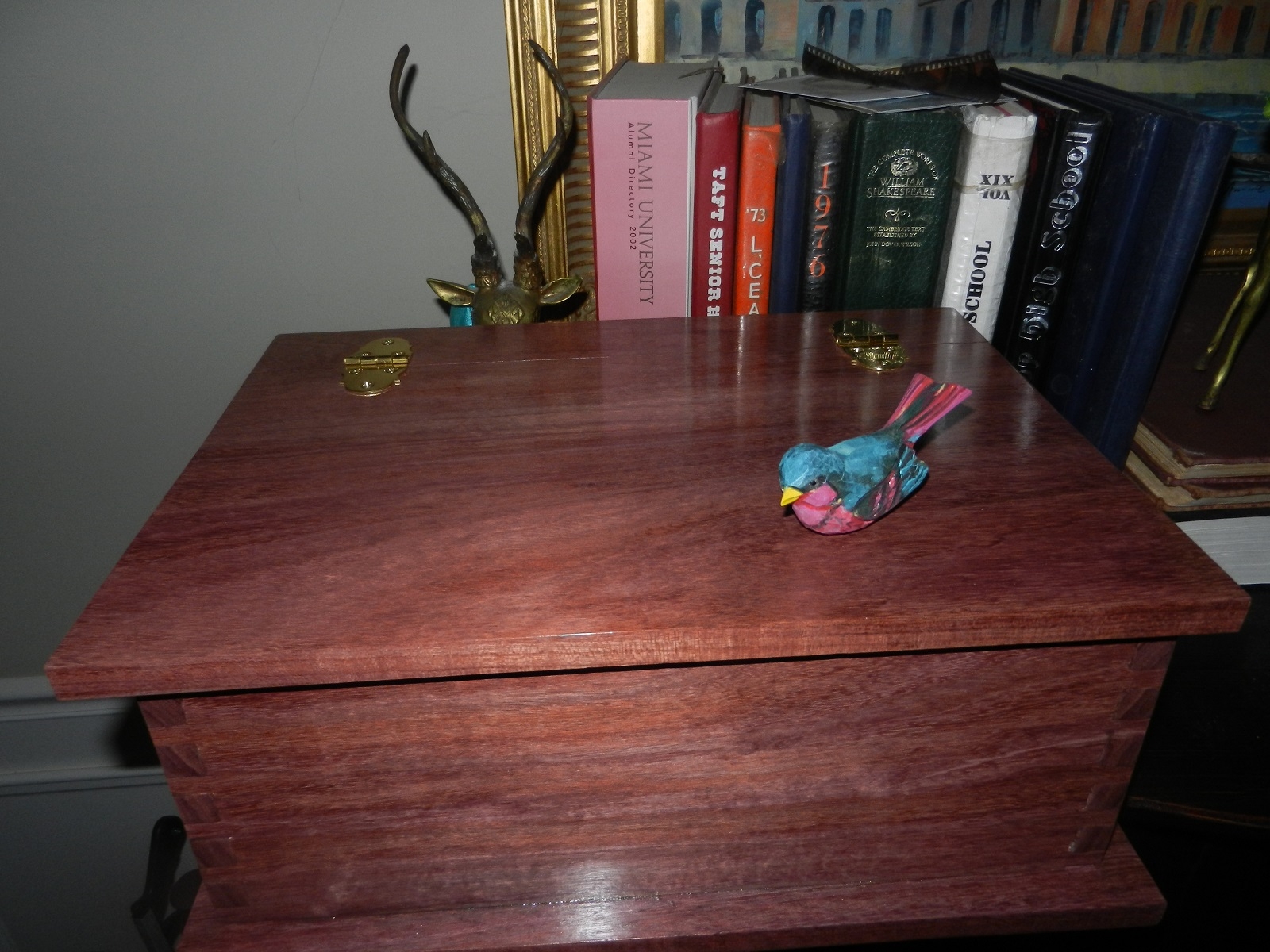

Here is the first box I made for my wife's niece. She also wanted to attach a bird to it so we set the bird into a hole. The bird is removable so it can't be smashed if you are moving the box.
What I didn't account for was her love of unicorn stickers. Gave her the box.....she got it home and she's plastered it with stickers, much like you might see a car with 45 bumper stickers plastered all over the back side showing where it's been. Oh well.... they can be sanded off if need be!

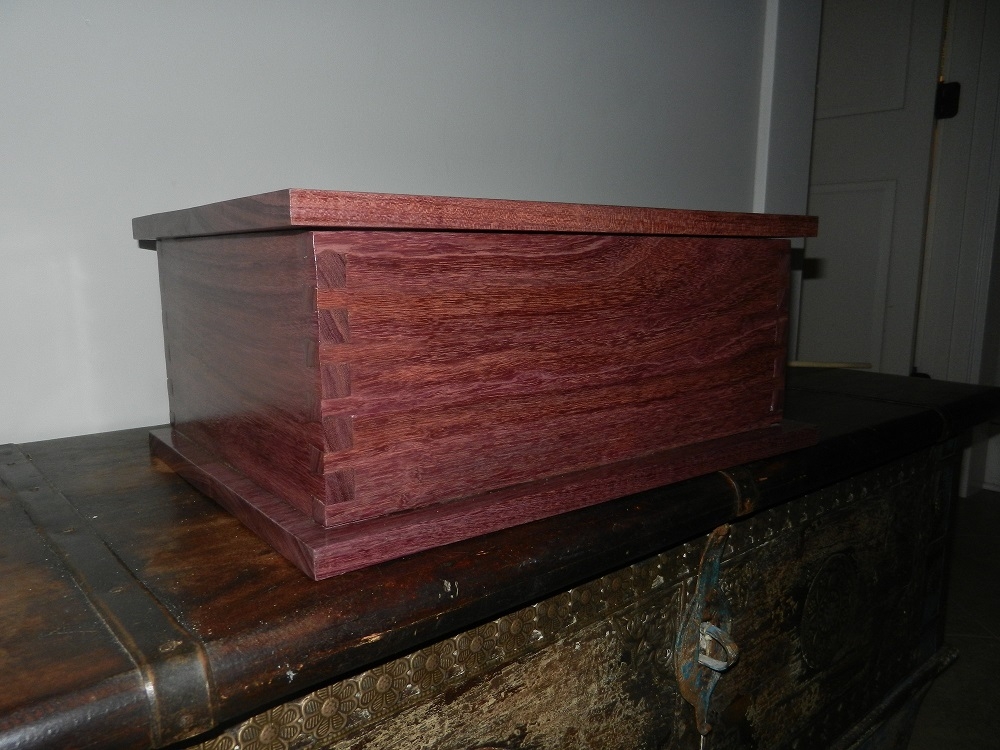

might also consider heartwood red cedar as well. nice work on the dovetails

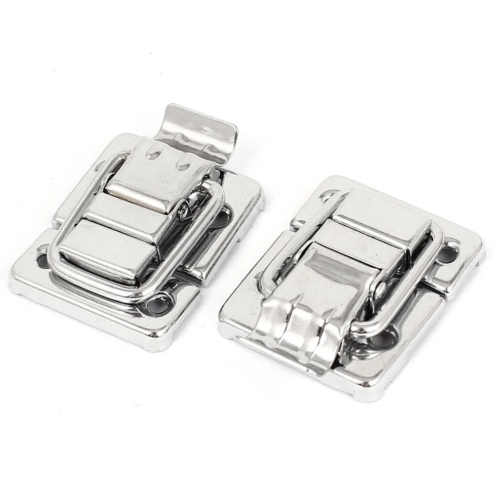

Similar to above but now, sides ARE attached to the top which would be exactly like a cake plate. But now, how do I fasten said wood to base so it would hold together or do I just leave it as two distinct sections where the top could be knocked around, relative to the base?
use a trunk clasp to hold the top to the base. That way the entire top can be removed just like a cake plate.

BTW, if you can build a box as pictured, you are most certainly a wood worker ! ;)
