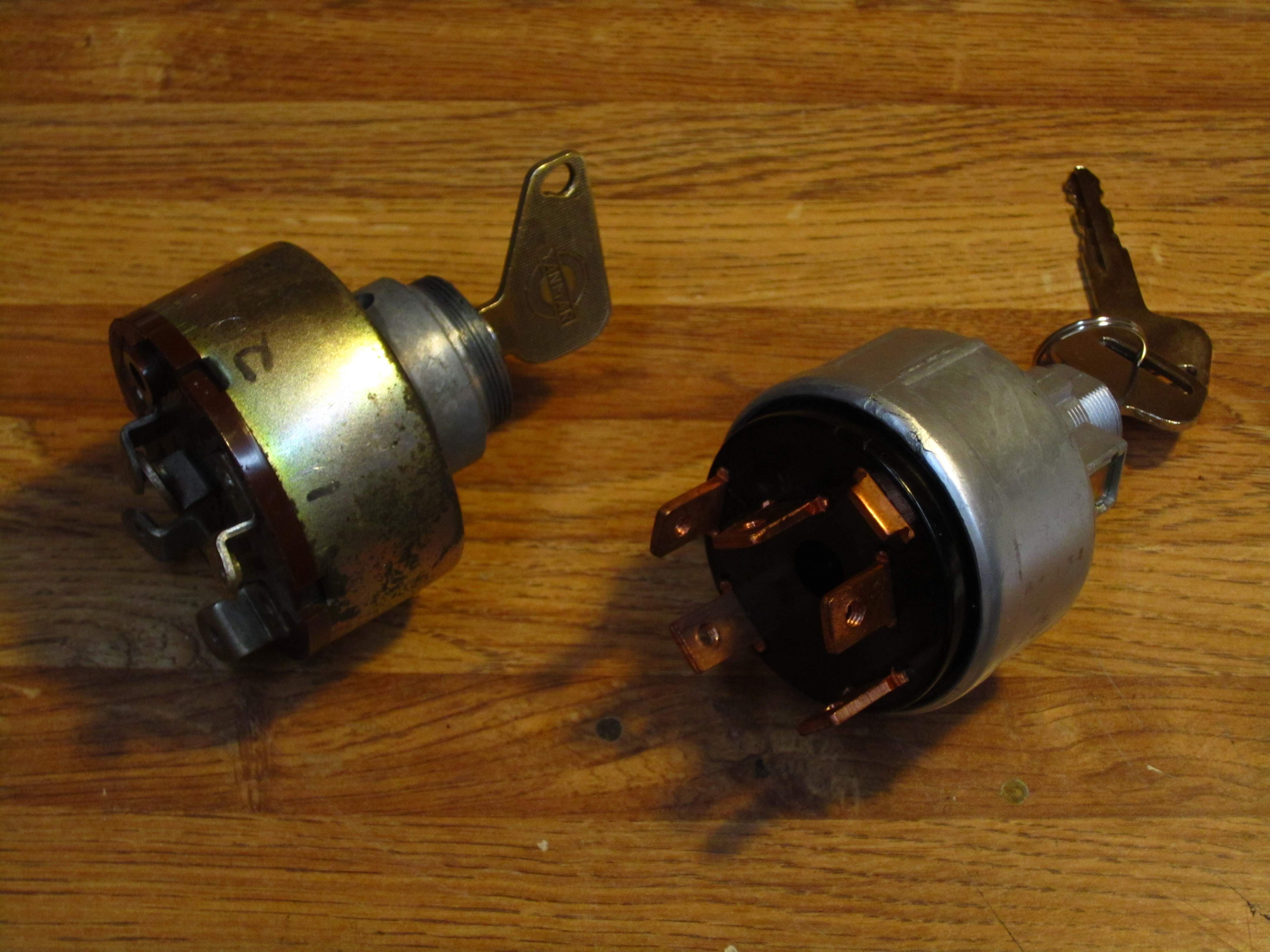

Just got my new switch in from Hoye. Only problem is it's completely different from the old switch. Won't even fit in the hole that the old switch came out of. No prob, I can do some filing and grinding and make it fit. The big problem is figuring out which wire goes where. I've got 2 of the 5 wires figured out. Got to trace which one of the 3 remaining go to the starter. The last 2 go to the glow plugs and I think are interchangeable. I think. I hope.

Wonder if you got the right part?? The one they sent to replace my key switch was a direct replacement. Terminals were exactly the same, marked the same, even the same key fit the lock. Might want to call and ask just to be sure. I just transfered the wires, one terminal at a time to the new switch, no guessing where anything went, worked perfectly. Safety, be sure and disconnect the ground wire from the battery before doing the change or even removing the old switch. I remember getting a nice burn arcing my watch to one of the hot terminals. Just remove the bolt where the wire bolts to the engine on the front right side of the engine.
This. Auraaura if the one they sent doesn't fit the hole and the wires don't match up - its not the right part. Send it back and try again.
The correct part they should have sent is a perfect replica.

Your new switch should have looked like this --
Yanmar Tractor Parts: IGNITION SWITCH - ORIGINAL YANMAR STYLE
It should be an exact replacement as stated above.

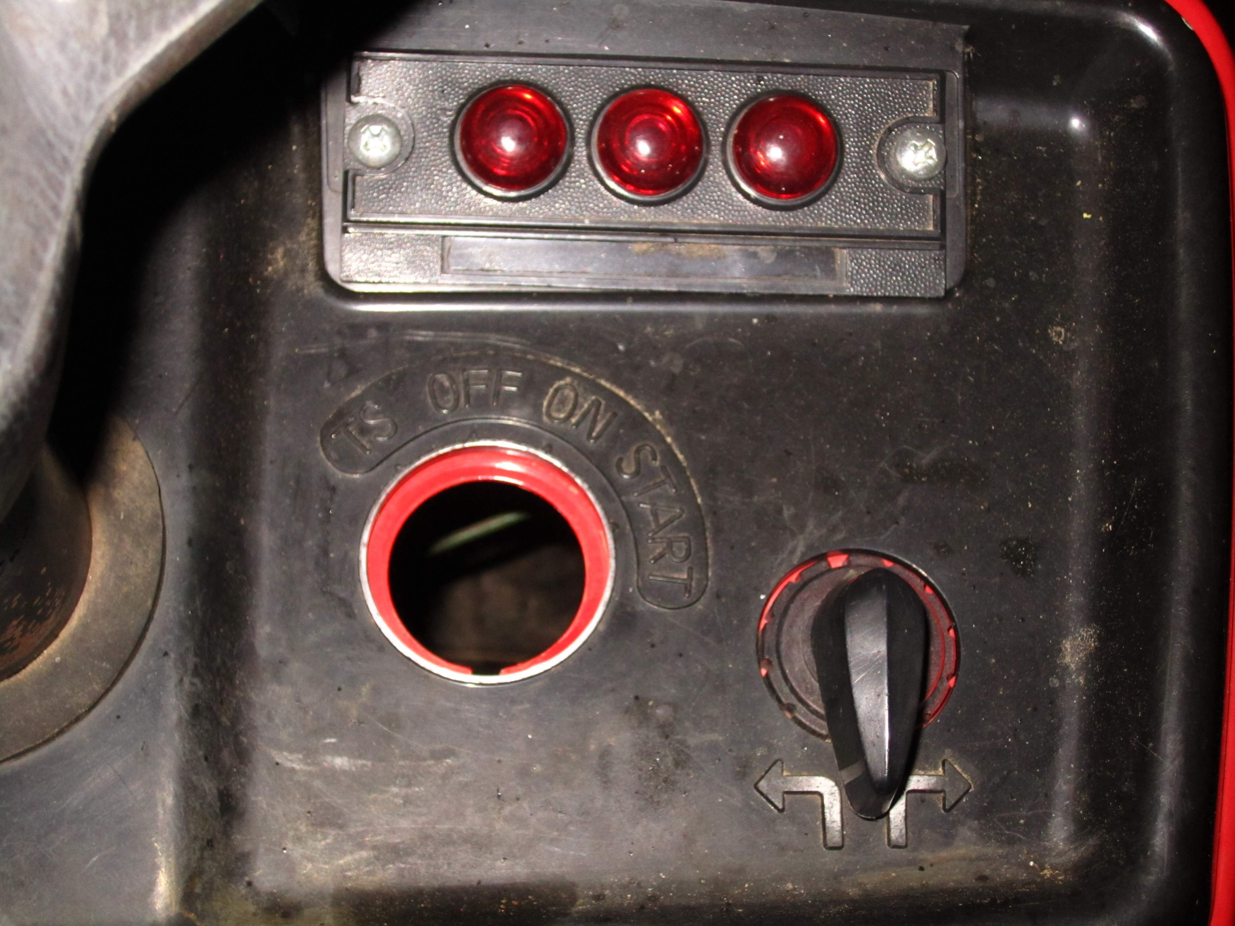

Do you think that someone may have already mounted a universal type switch in a different spot the dash? Maybe the correct switch hole is empty or has been replaced by a gauge or something? Any way to see a picture of your dash?
Edit: Is you switch located in the same spot as the attached picture?

OK, pics attached. Old and new switch side by side. Also pic of dash with switch removed. I'm not really thinking someone has already installed a universal switch because the new switch will will absolutely not fit the hole in the dash. If you'll notice on the pic of the dash there is a cutout in the bottom of the hole that matches a protrusion on the original switch. The part of the new switch that fits in the hole in the dash is shaped nothing like this. I could grind some on the new switch and make it fit, and don't really mind doing this as long as it works "electrically". DeepNdirt, you said I could order a new key.....where could I get one? I'll try it for sure. Markings on the back of new and old switch are completely different also.

OK, wired up the new switch like I think it ought to be done. Tractor fired right up, but now I'm worried....if I hooked it up wrong could the glow plugs be "glowing" all the time the tractor was running. I'd just unhook the things if I could figure out where they were. I live in south Mississippi and it rarely gets cold enough here to need them anyway.
