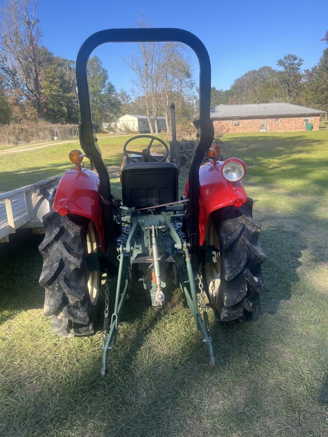

What do y’all think about the reflectors on the rear fenders?
They’re a little bigger than the original OEM “Cateye” brand reflectors, but I still think they help bring out the little Yanmar’s beauty!

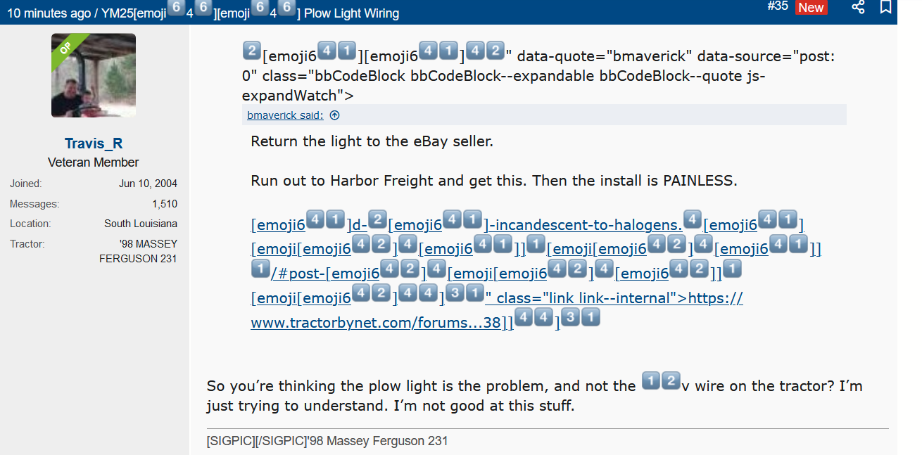

Return the light to the eBay seller.
Run out to Harbor Freight and get this. Then the install is PAINLESS.

So you’re thinking the plow light is the problem, and not the v wire on the tractor? I’m just trying to understand. I’m not good at this stuff.

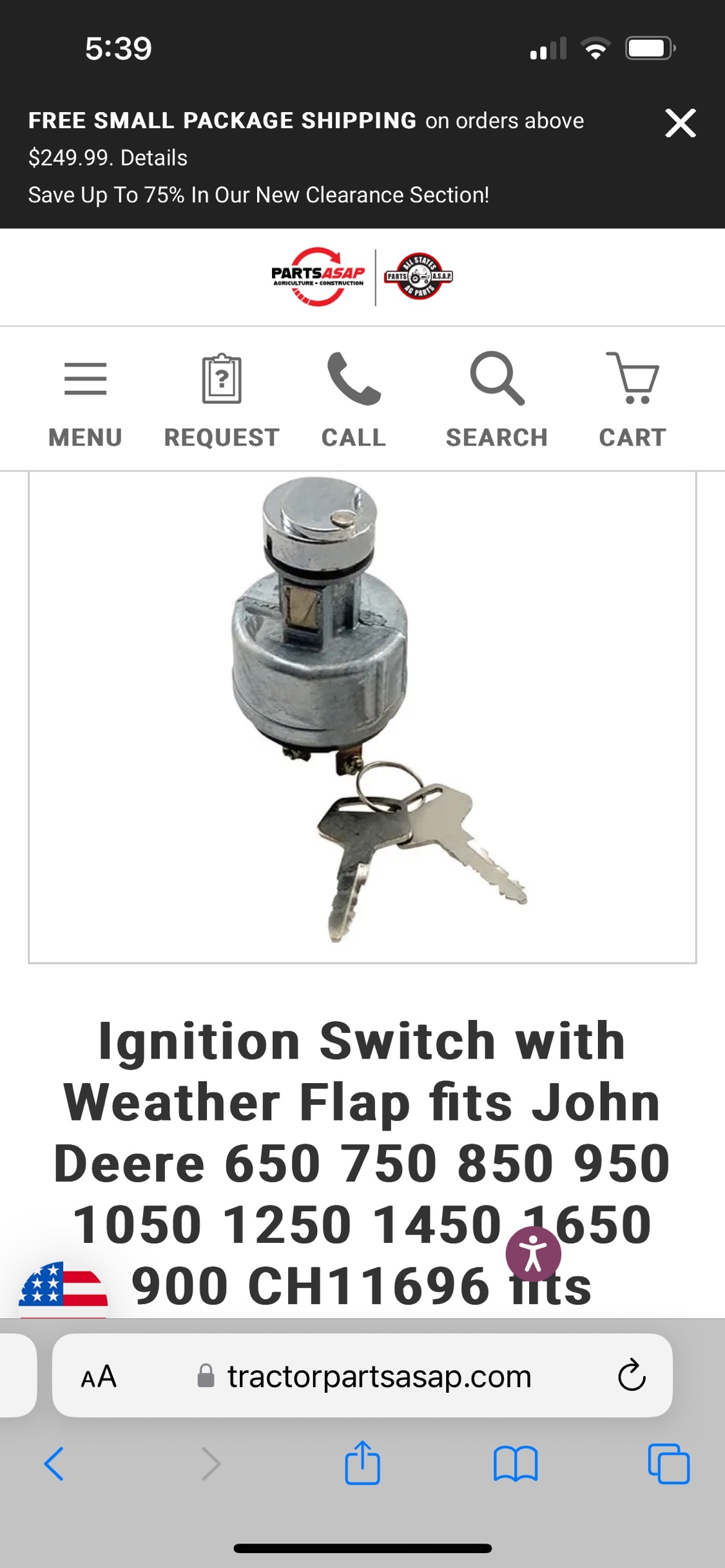

The Brown wire on the light is ground. Green is low beam, White is high beam.
I think something is going on with the 12v wire that goes to the ignition switch.
Does anyone have a wiring diagram of the key switch? I may need to run a new wire.
The ignition switch that’s on there now is an aftermarket switch made in China.
