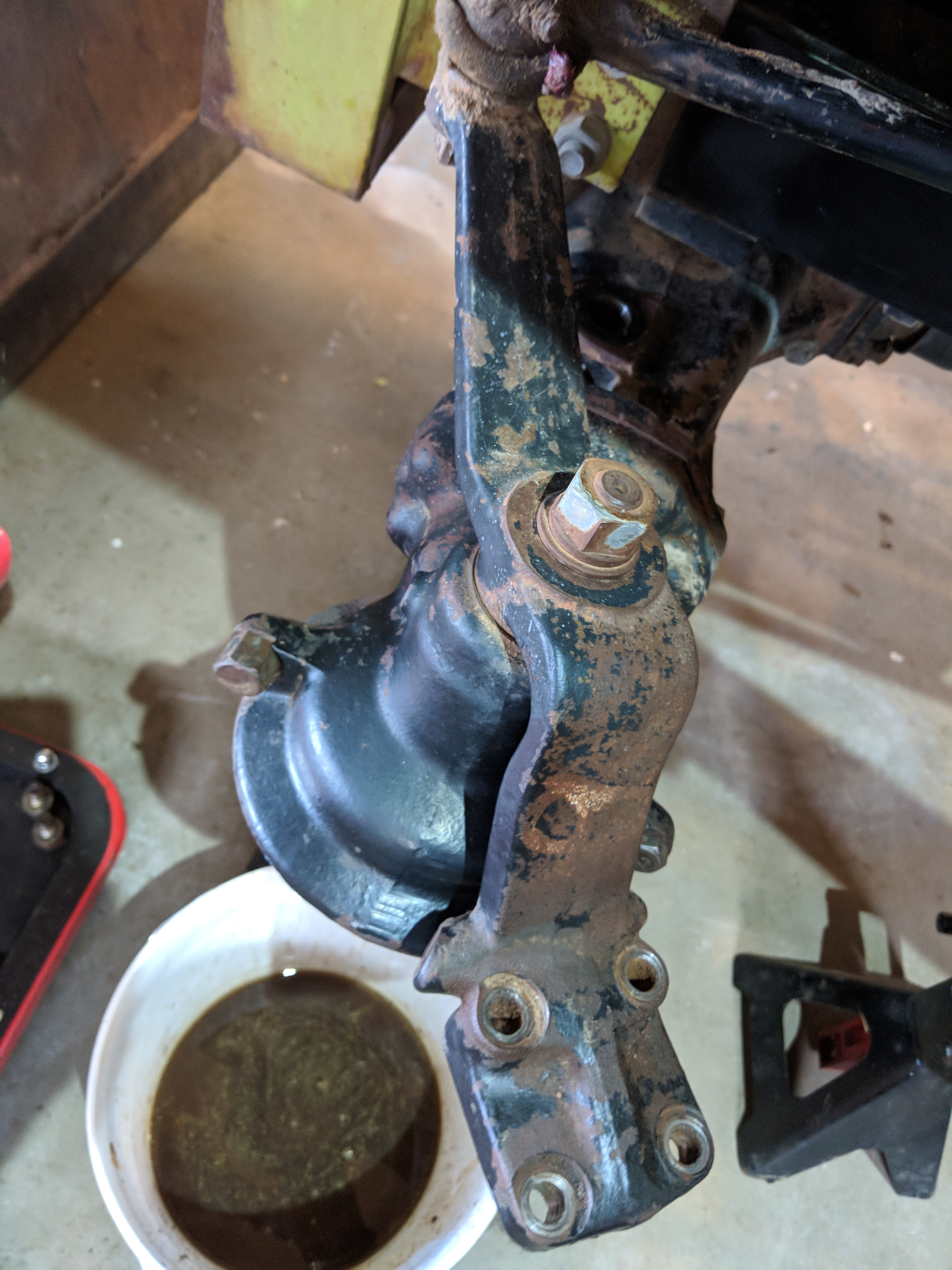

Got a YM240D with FEL over a month ago - it looked very used, but worked great, and I really did not want to pass on a green one. I have been asking questions in another, more specific, topic, and figured I'd share overall progress here.
The 240 came with a long list of issues and, from lurking on the forum, I figured I could try to fix them (worst case scenario, I thought, I'd tow it to a nearby shop). I started with the worst problem on the tractor - wobbly and very leaky front end. Having the help I have got so far on the forum is very helpful and encouraging as the most mechanical experience I have had previously was working on old German cars 15 years ago.
It also came with an I&T manual, but I liked the original parts and service manuals that the YM155D came with, so I found those on eBay. Once I got the Service Manual, I realized that it doesn't cover 4WD front end at all, and I&T felt a little too condensed for me. I found a drivetrain manual, but have not received it yet - hopefully it will teach me some secrets not covered in the library I collected.

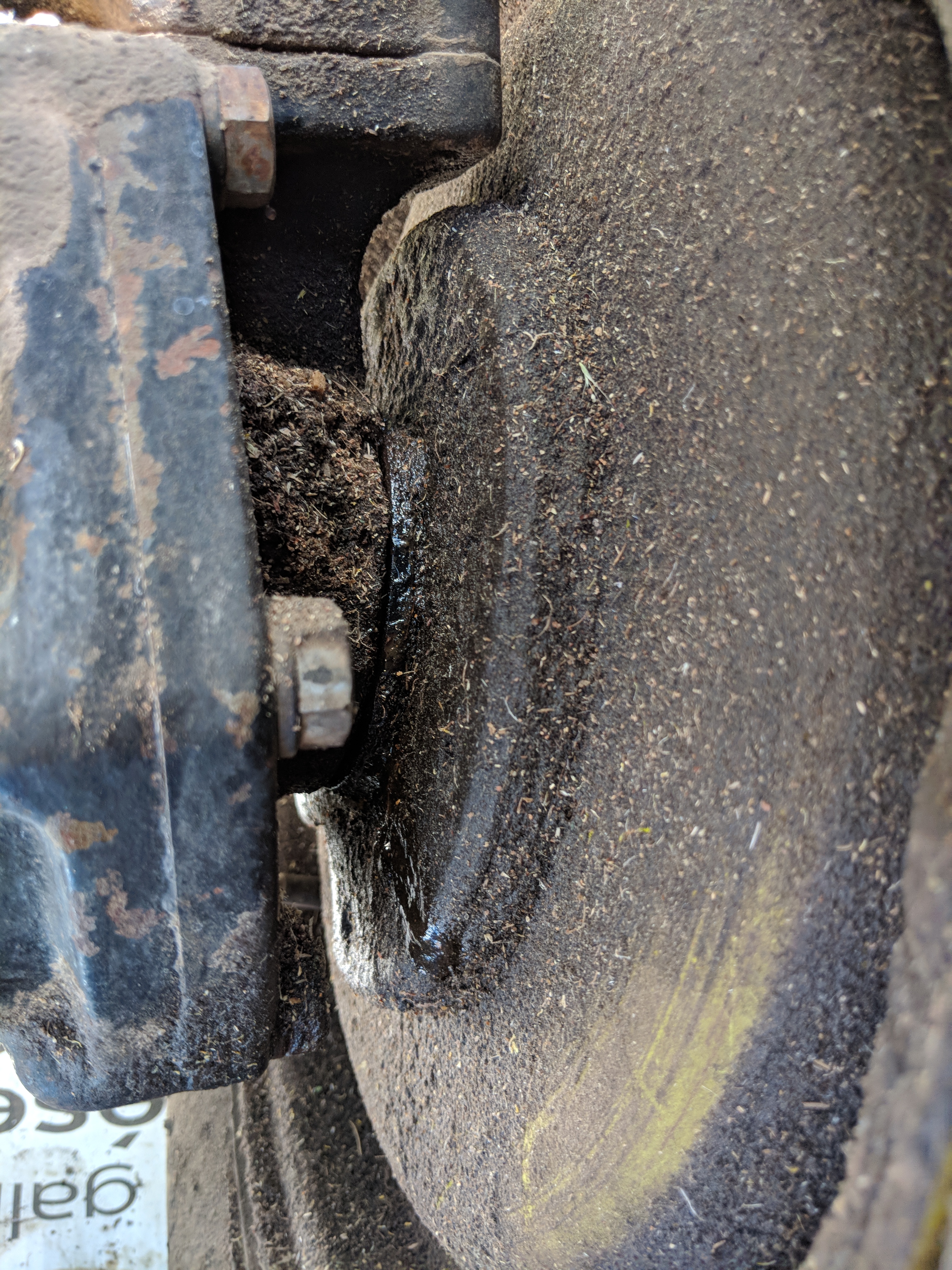

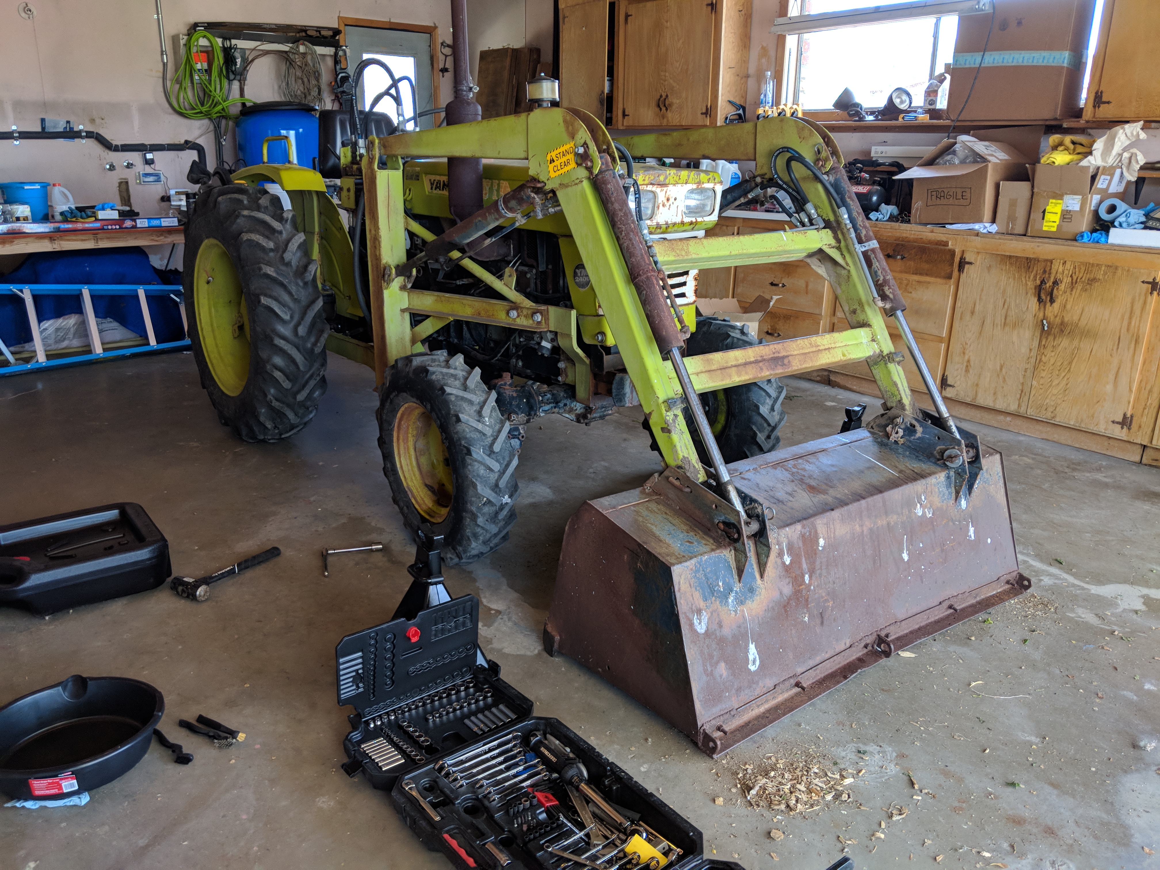

Here, in the garage, it looks a little bruised but in general nice and dry.
The inner side of the wheels:

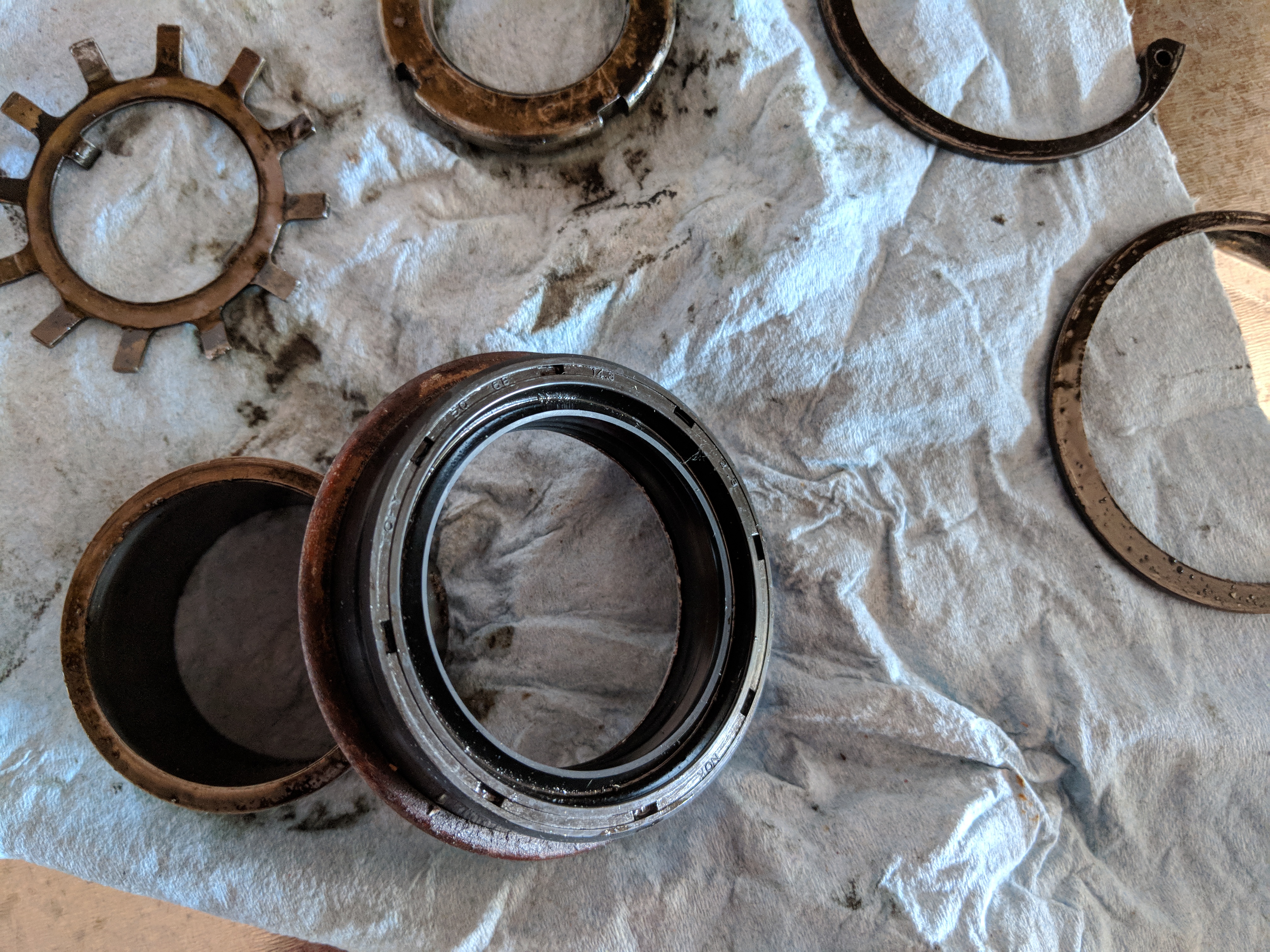

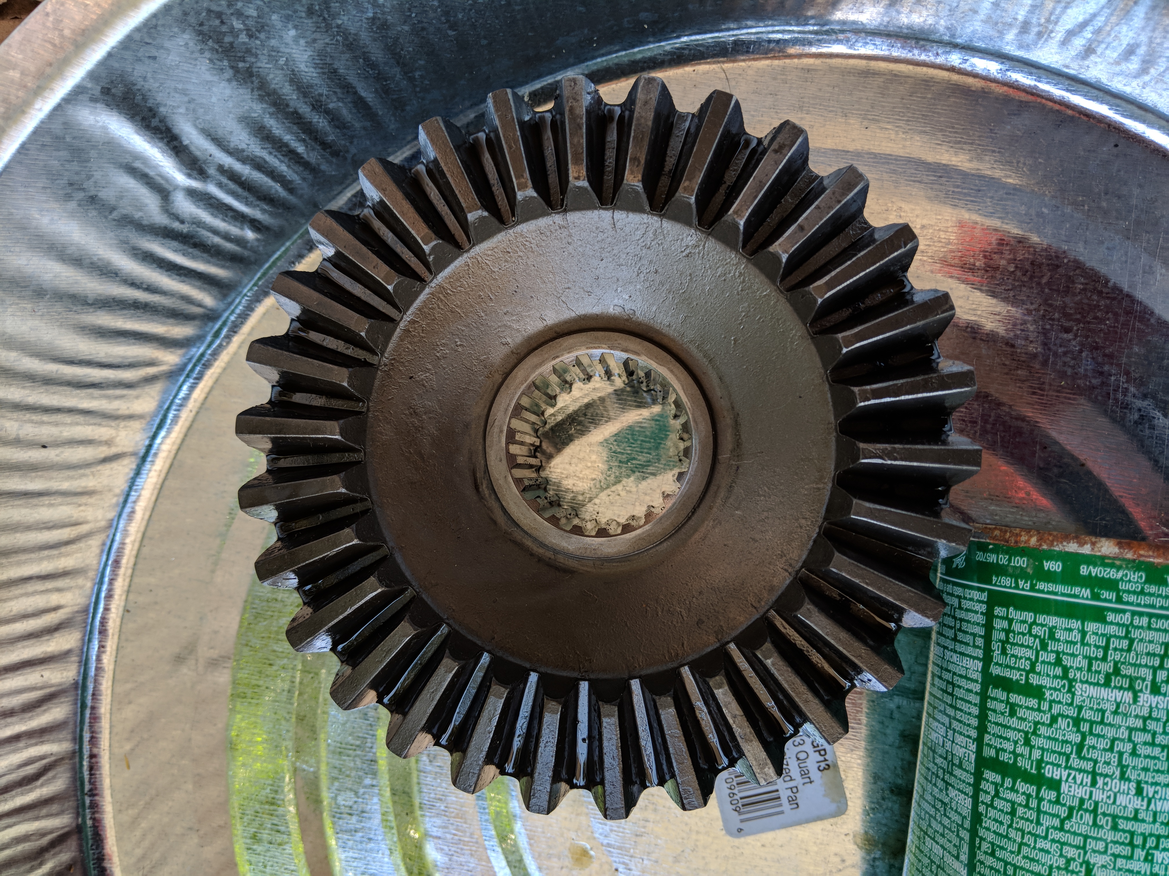

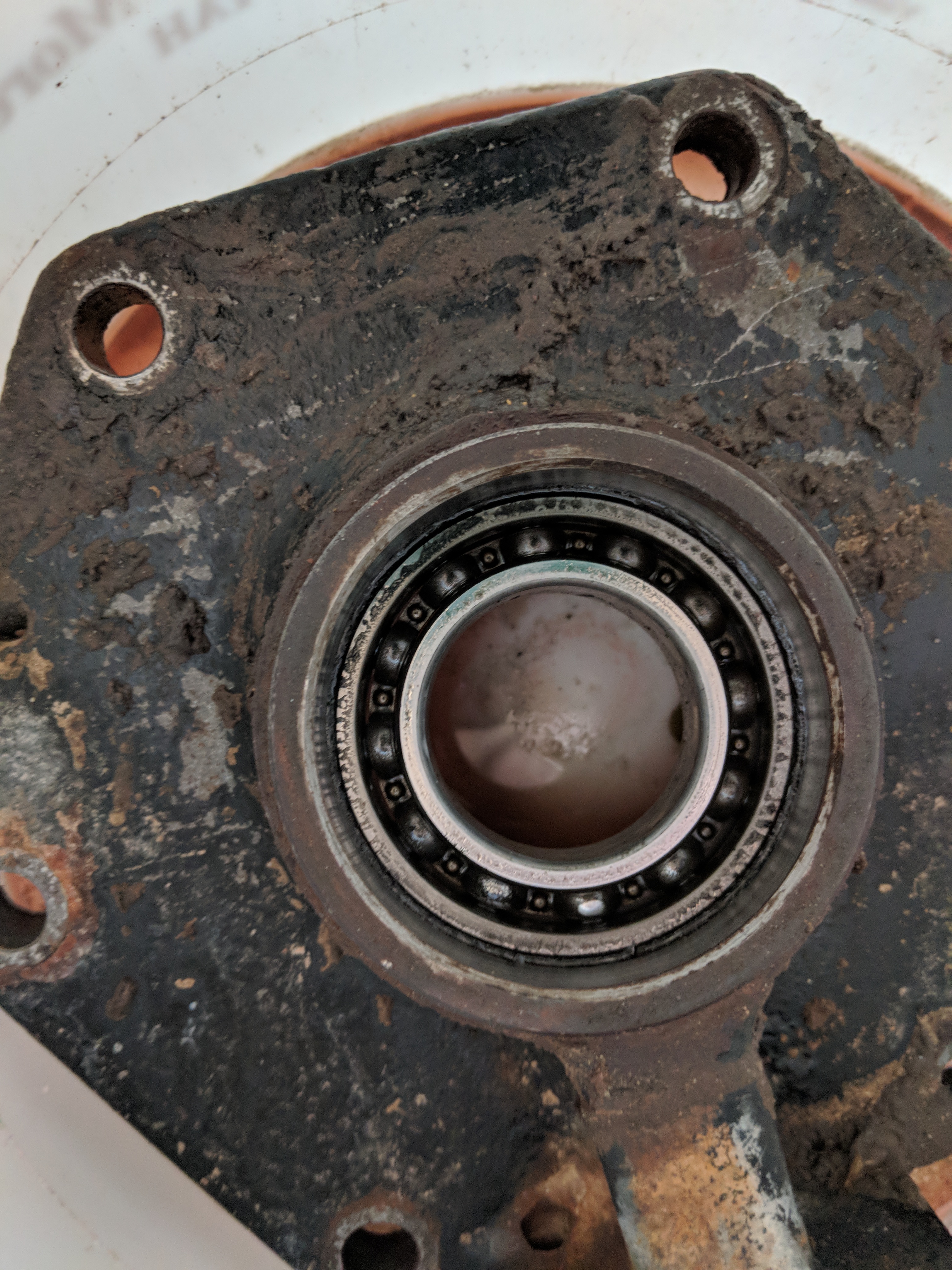

I preemptively got some parts based on the parts diagram and tried to deduce how to take apart those hubs. PO probably did not realize that the front axle had three separate reservoirs and only checked level in the center because very little oil drained out of the knuckles (I've only had the tractor for 2 weeks prior to putting it on the stands). Not knowing that the knuckle comes out all at once and comes together like a puzzle, I did not order enough replacement seals/gaskets. Good thing that Hoye's shipments always make it in by Friday. :D While waiting we tried to clean up the parts and make sense of what we saw.

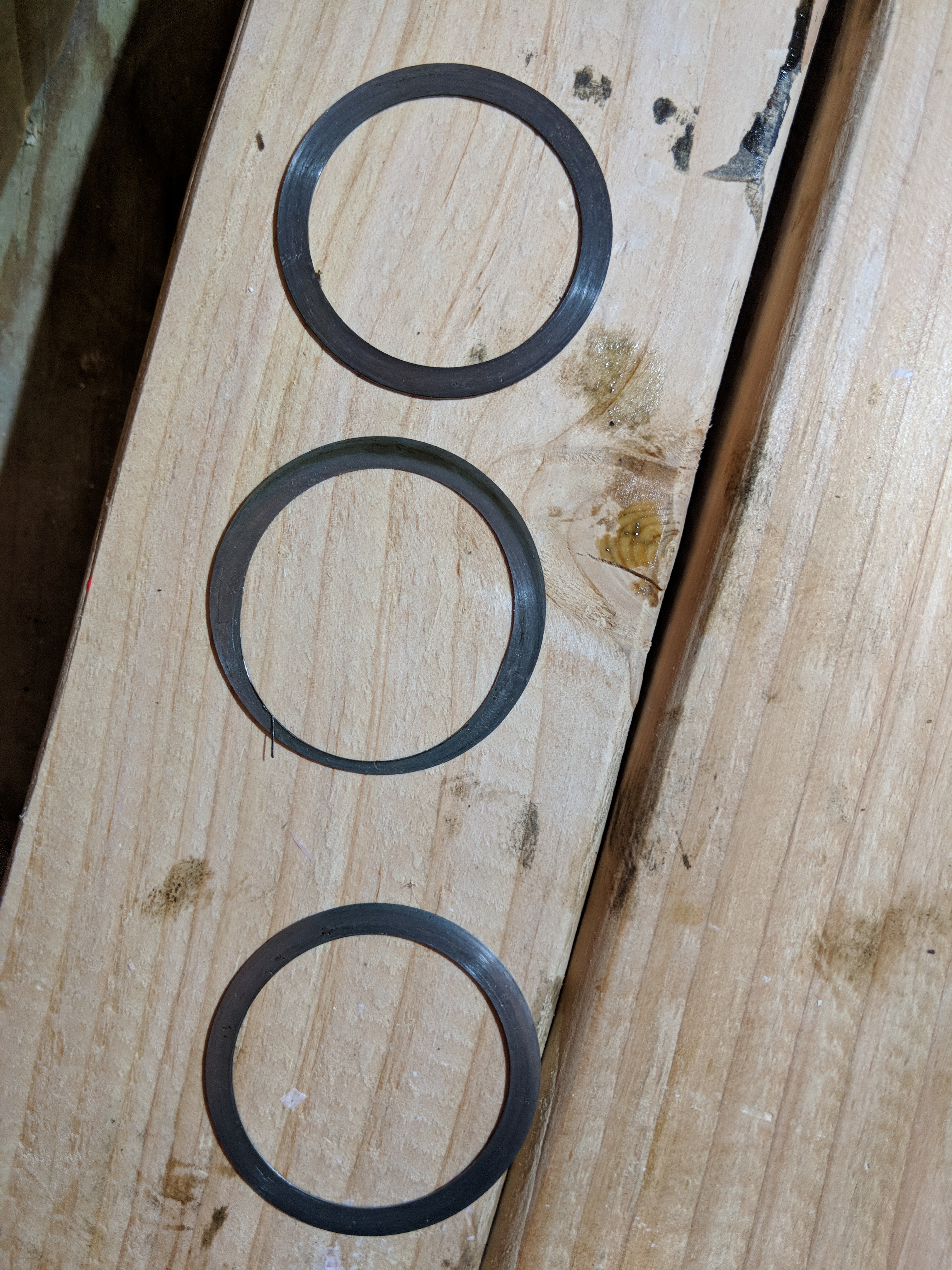

The unusual wear in the shims seemed very wrong, I posted about it, and there was a very insightful discussion here: http://www.tractorbynet.com/forums/yanmar/397659-ym240d-front-axle-shim-wear.html . So based on what I learned in that thread, I thought that I probably will need to re-measure and add more shims. I decided to do this without the knuckle body to get a nice clear view of how things were meshing together.

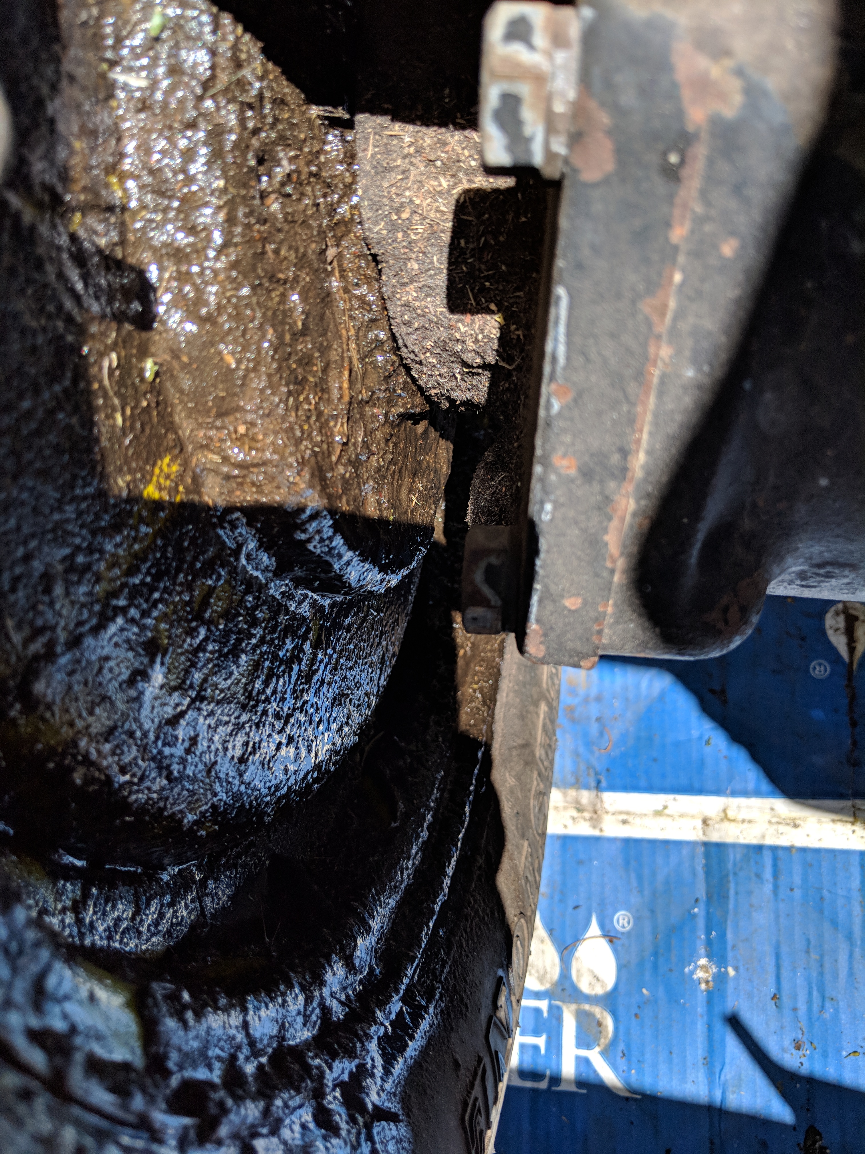

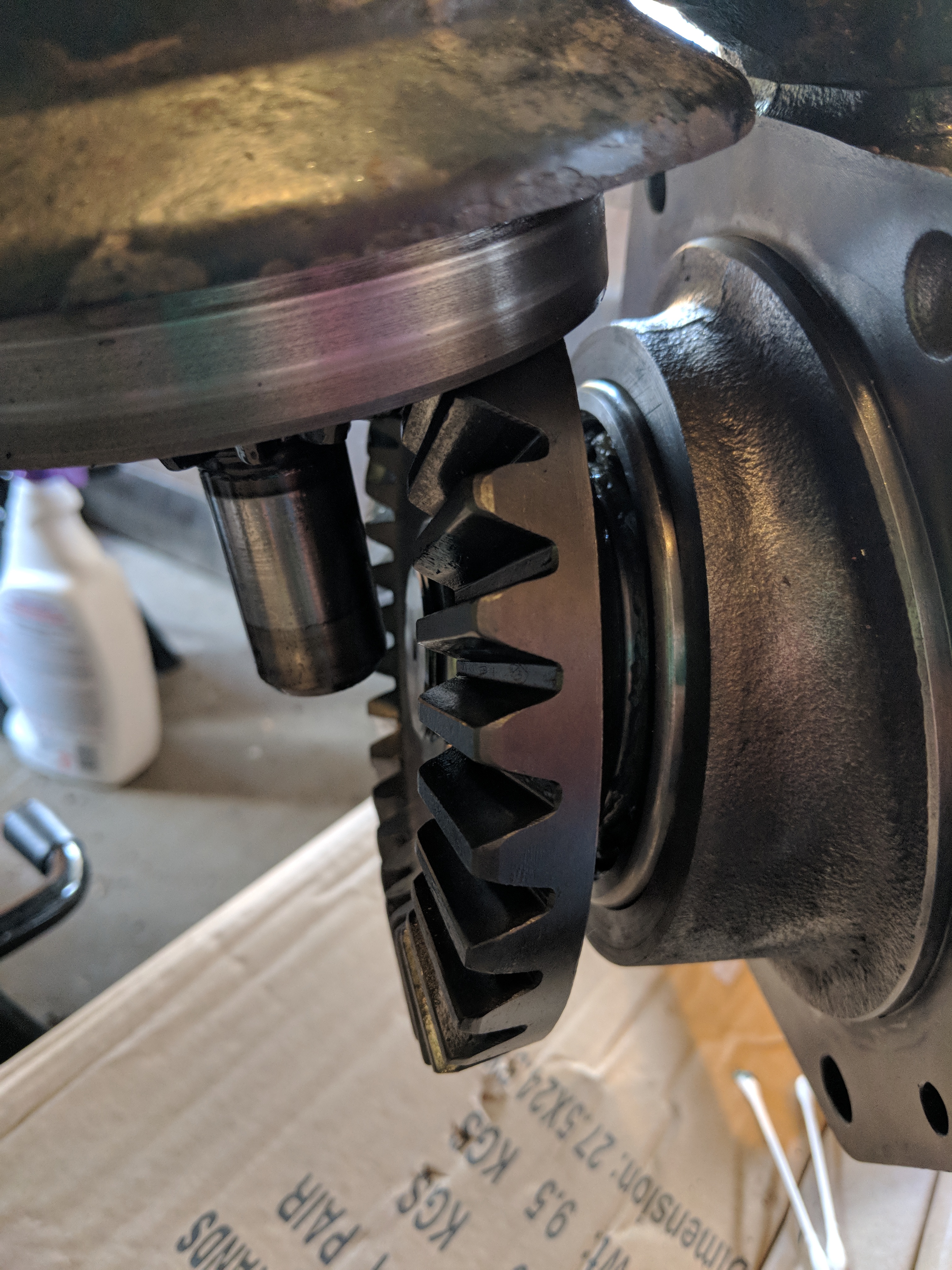

I cleaned up, painted, and re-assembled the knuckle cover with the stub axle to see how the gears are aligning (thanks to encouragement and advice from rScotty, winston1)

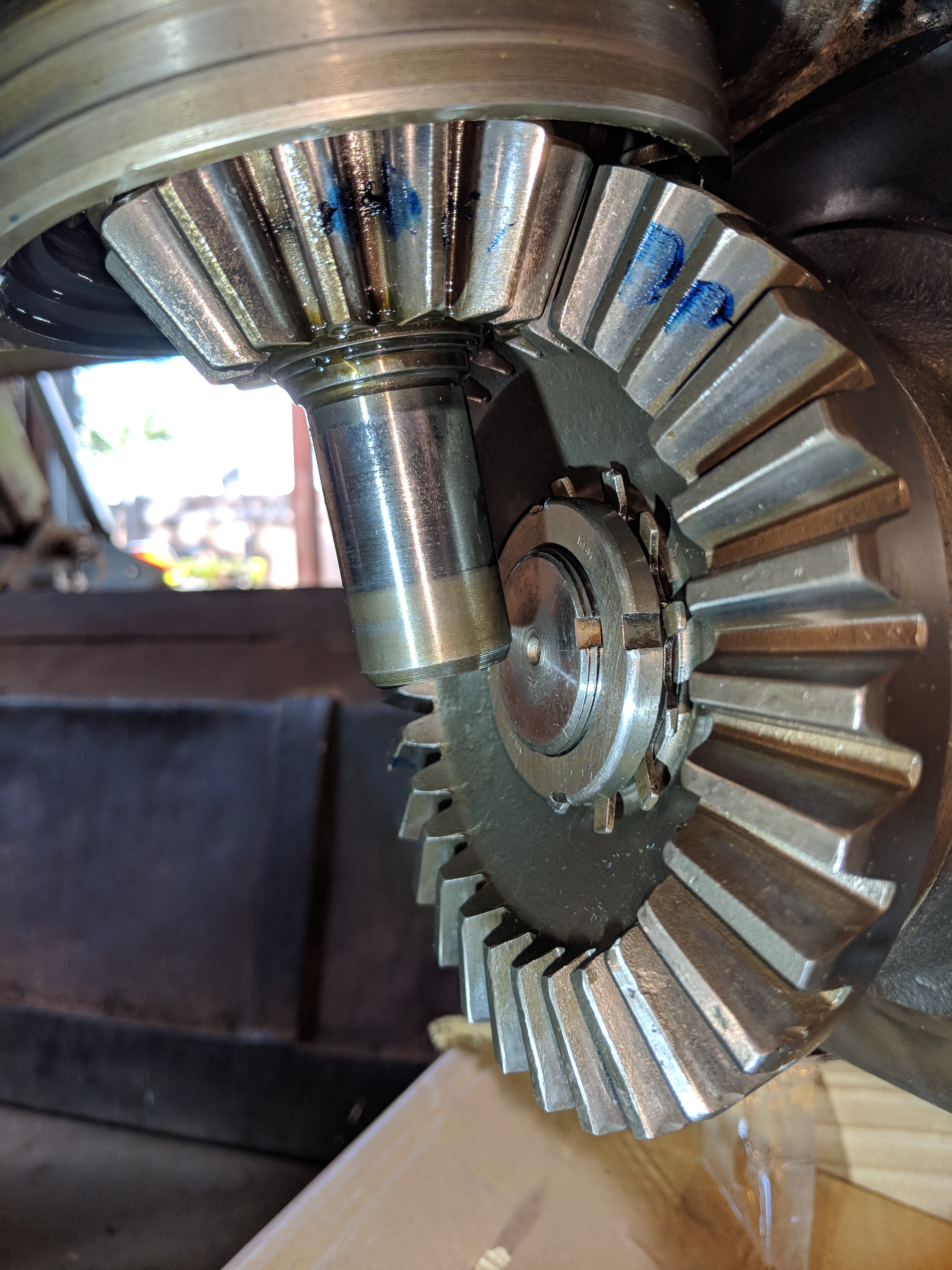

Here is the result of trying to figure out how mechanic's dye works. Not quite sure how to read this yet, to me it appears that the vertical gear could be closer, ie need more shims.

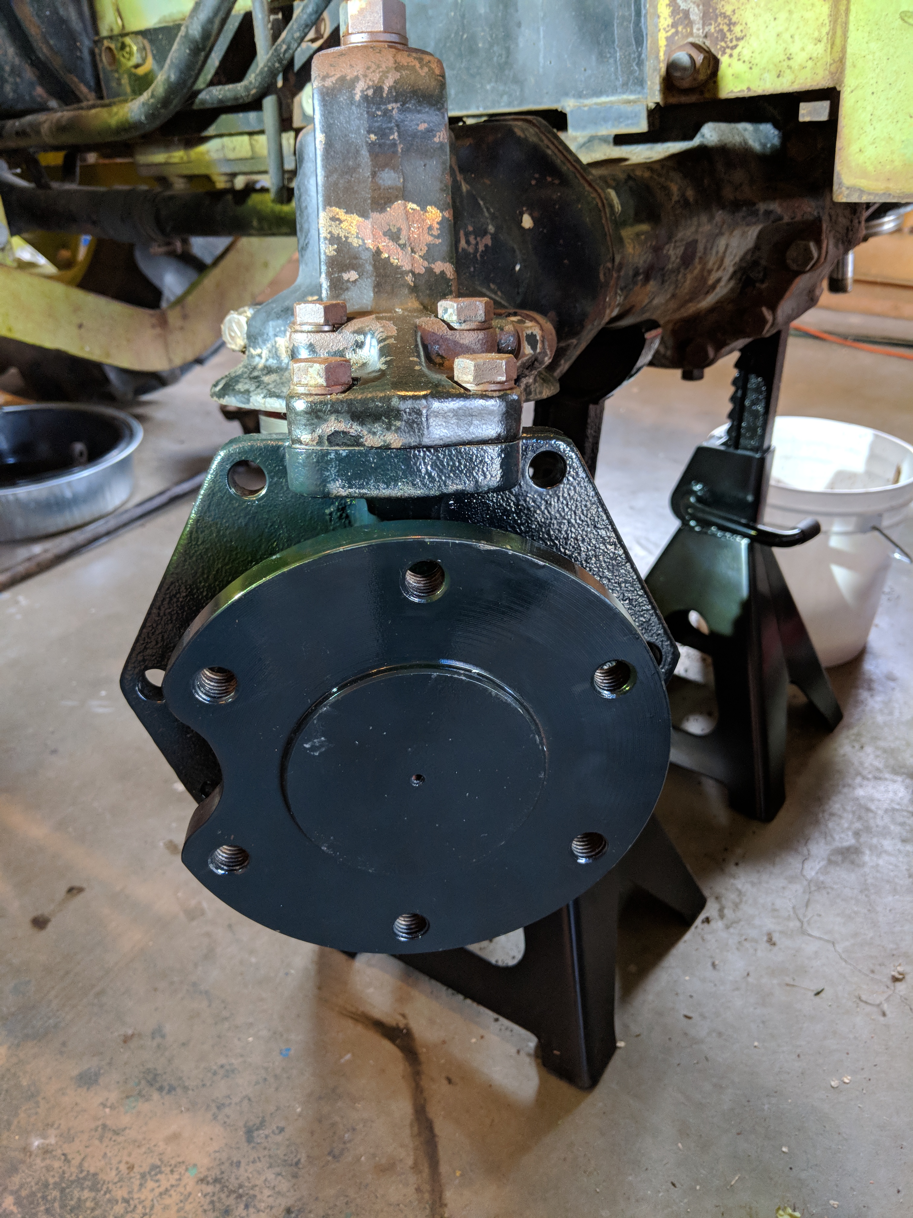

And cleaned up/started on the other side (this used to be a ball of oily dirt):

Looking at your photos reminds me that I never did have good luck with that type of grease-based mechanic's dye. It was always too little, too much, or too difficult.
I prefer to use something similar but non-greasey. Something that dries fast, leaving a very thin coating easily rubbed away. My favorite is Dykem brand blue layout dye. It is basically blue dye in an acetone base. Dries in less than a minute, runs everywhere, and permanently dyes anything it touches. It rubs away easily. I find it easier to "read".
As a cheaper and more controllable alternative I've also used black or blue felt tipped pens. Give it a try.
Do any of your shop manuals show the typical wear patterns for bevel gear engagement? Some Yanmar manuals did, others did not.
If the backlash is a couple of degrees, that will work too. If you can set up a degree wheel you could convert degrees into thousanths of inches. It's doable, though dial indicator would be more accurate. I agree that what you are looking for mainly is to have some clearance and no binding - but if you can accomplish that while also putting the gear tooth torque onto the proper part of the gear then why not do it?

And just realized that there were 4 shims on each side (2 were very stuck together): 2 x 0.2mm and 2 x 0.3mm. That added up to 1mm!! And still left what feels like a lot of backlash (still don't have a tool or correct service manual with directions to measure this properly). I have a plethora of shim choices now, so I am wondering if adding (a theoretical number) enough shims to add up to 2mm sounds reasonable?
I think that 2 mm is reasonable. As Winston say, you may have to assemble it many times. Shims don't have any upper limit, they just gradually become known as "parallel face ground washers" as they get thicker. But I've seen them considered as "shims" all the way up to about a quarter inch (6mm) thickness. Basically I would shim to whatever it takes for the engagement backlash to be loose ... but small.
I like to think of the thickness (width) of the ball bearing shell itself as being part of the shim thickness - and it's a pretty thick shim itself, often being in the 15 to 20 mm range. Designers use bearing width as part of the shim calculation since bearing width is very, very flat & consistent.
Don't forget any paper gasket thinkness. Thin paper gaskets can be as thin as .1mm thickness (.004") and the thick black fiber gaskets with the punched out holes can easily be .5mm (.020"). Hmm... Are there any paper gaskets in there? I've forgotten just what combination of gaskets and seals Yanmar used.
