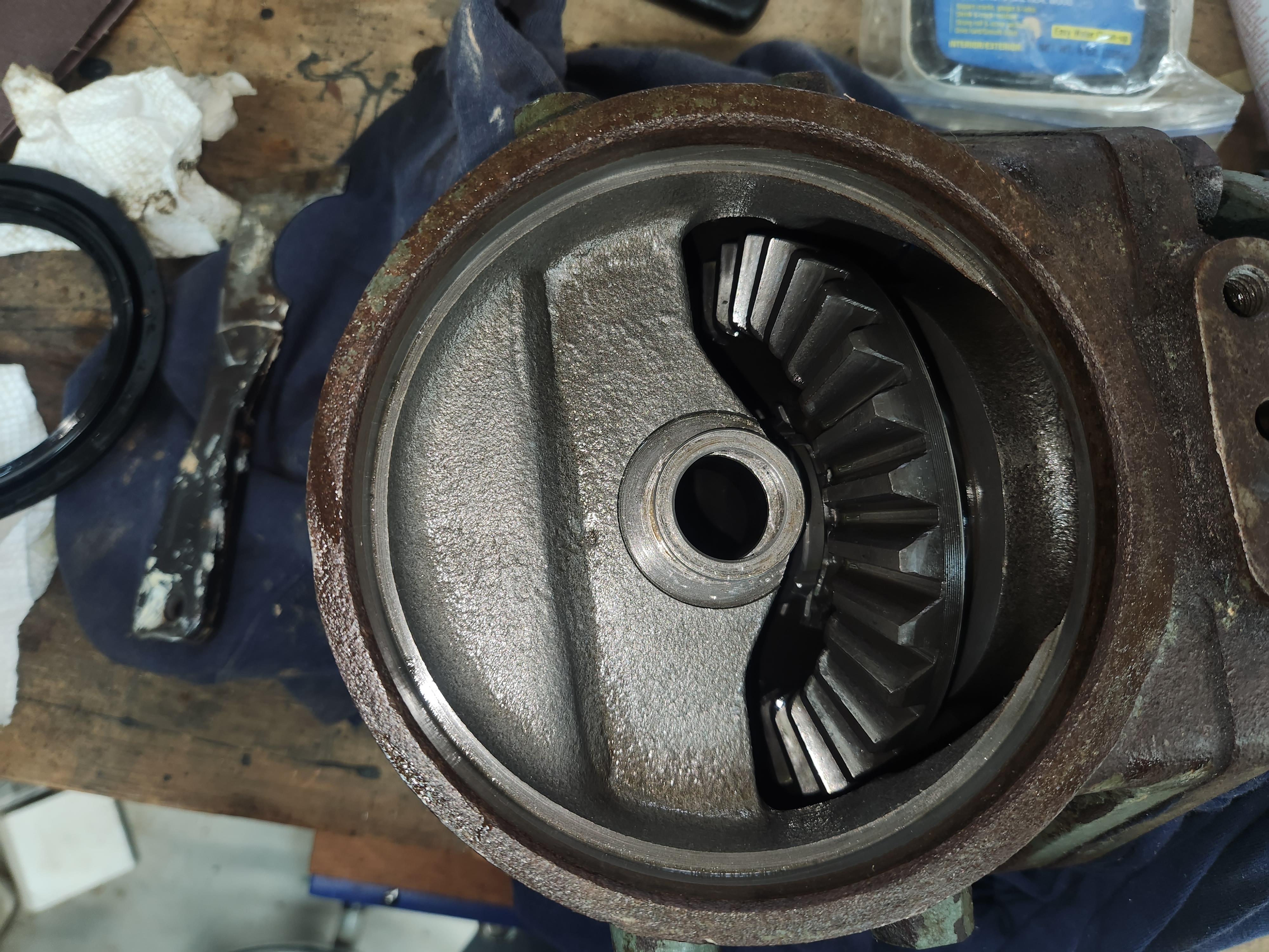

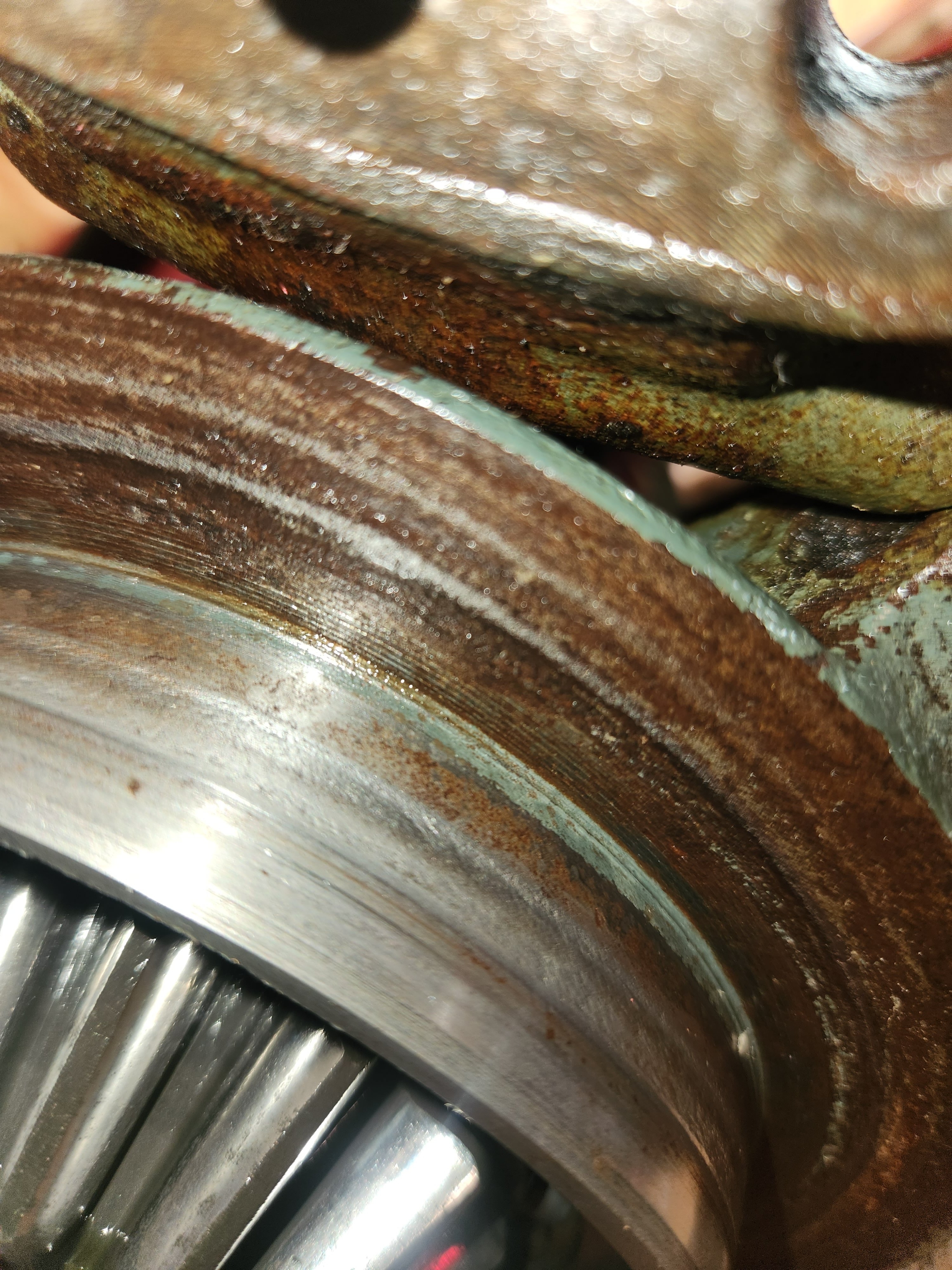

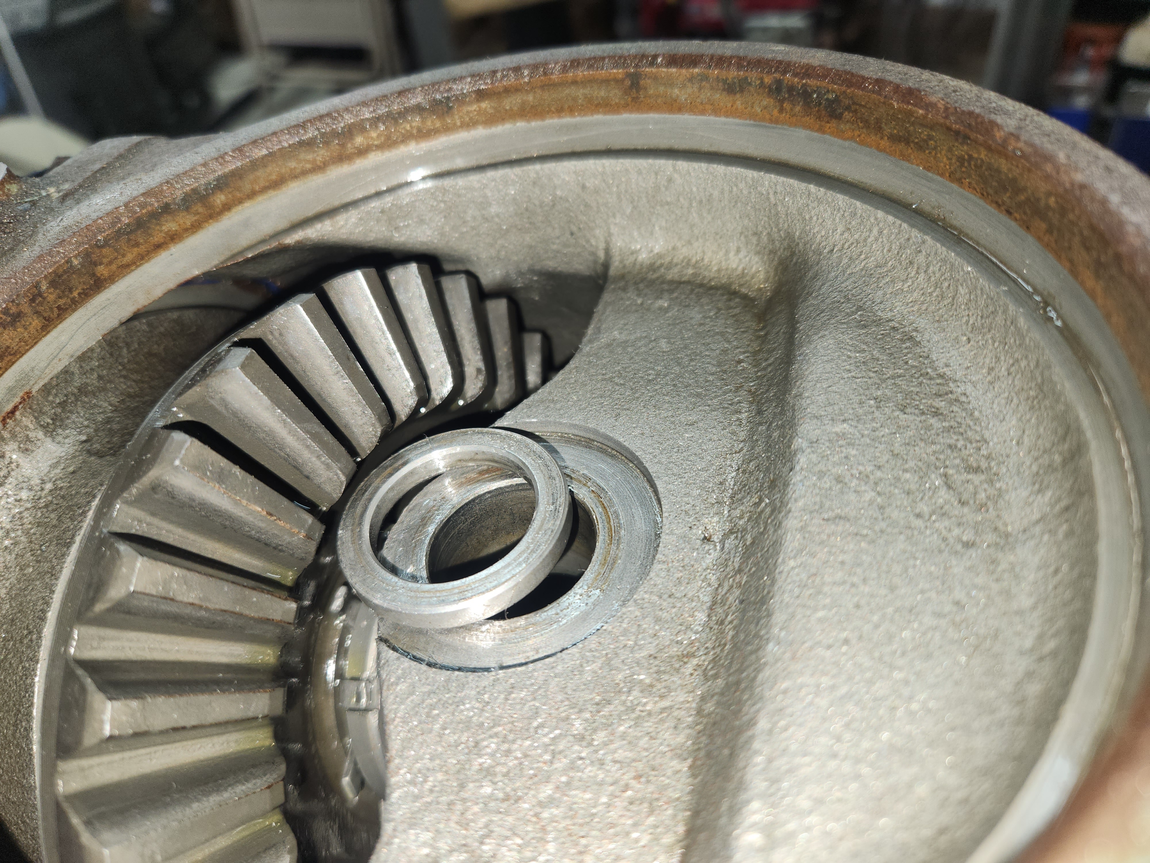

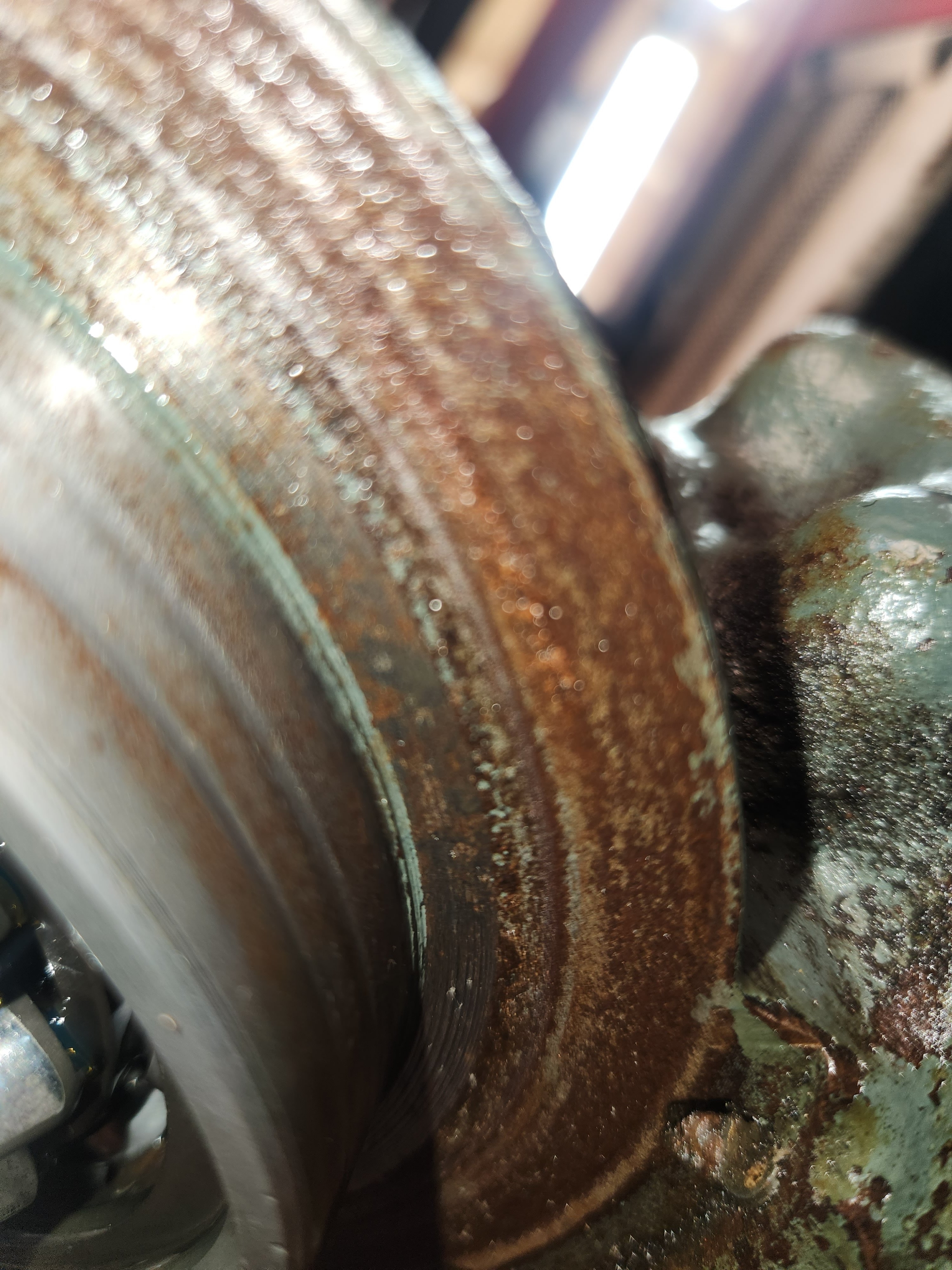

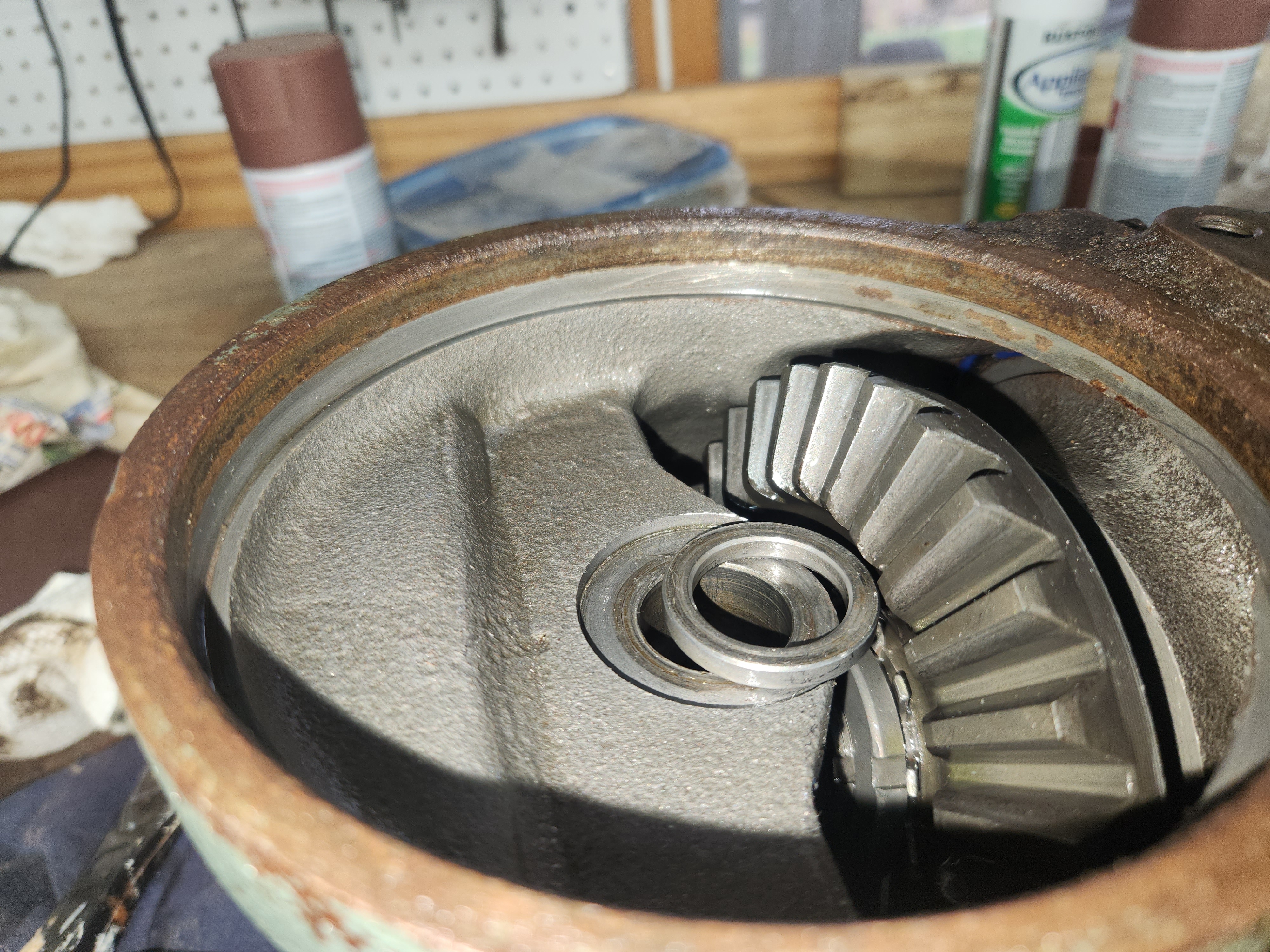

I have been limping along with this leak and have taken it apart about 6 times....what the old saying??? the definition of crazy is doing the same thing over and over again expecting a different result? I installed a new gasket /oil seal where it is leaking from. Everything looks solid to me. some wear on the mating surfaces but cant imagine the gasket is defective especially since its leaking from the same place as the first one. The seal is the TCS 115 - 145 13.5. (Size: 115mm ID x 145mm OD x 13.5mm thick). Oil Seal, TC-115-145-13.5. The seal sits good and tight onto the lower housing - I have to admit it looked like the gasket wasn't sitting perfectly so there could have been some debris keeping it proud and leaking from there. What does concern me is the inner part of the gasket is just snug enough on the upper housing to not fall off, but there has to be movement when the hub makes a turn to left or right. You can see in the images that is shows a slight groove of wear. Wonder of this is the problem? Love another couple sets of eyes on this to see if I am missing something

These vintage machines could have hairline cracks where you are not seeing things. The surface rust could be hiding this fact.
I would cut-out a round disc of cardboard, lay it flat over the bevel gears, then wire wheel clean all of the surface rust. Then come back with an emery cloth to polish the surface clean.
Shop-vac out all of the particles, pull out the cardboard, shop-vac once again.
Now do the mating parts too. Keeping things clean as you go.
With material gone by a hundredth or thousand, you might need to make a gasket shim.
Leaks can also happen if you are overfilling. The top bevel gear sitting more vertical should splash up the lube oil/grease. Look at a few of the YM service manuals in the 4WD section to grasp the fill levels for these axles.

Those grooves where the seal rides can definitely cause a leak. You can get a repair sleeve that presses on there and will give you a nice new surface for the seal to ride on. We have done that MANY times and works great.

AaronM - I honestly think thats the issue....where do I find this repair sleeve?????
   / YM 2020D - Front Axle Leak - Gasket part number needed #18
That one Winston posted would probably fit just fine. I have another version too that works well. Im not really setup to post links quite yet though but will be soon if your not in a huge hurry.
   / YM 2020D - Front Axle Leak - Gasket part number needed #19
Fixing it wasn't that's for sure from the size of those groves? Doing it for a few Yrs..
#20
I'm interested in your version Aaron ....my concern is the inner portion of this is 113mm assuming this from the measurements of the gasket. the one Winston listed is 115mm....wont that just flop off?
