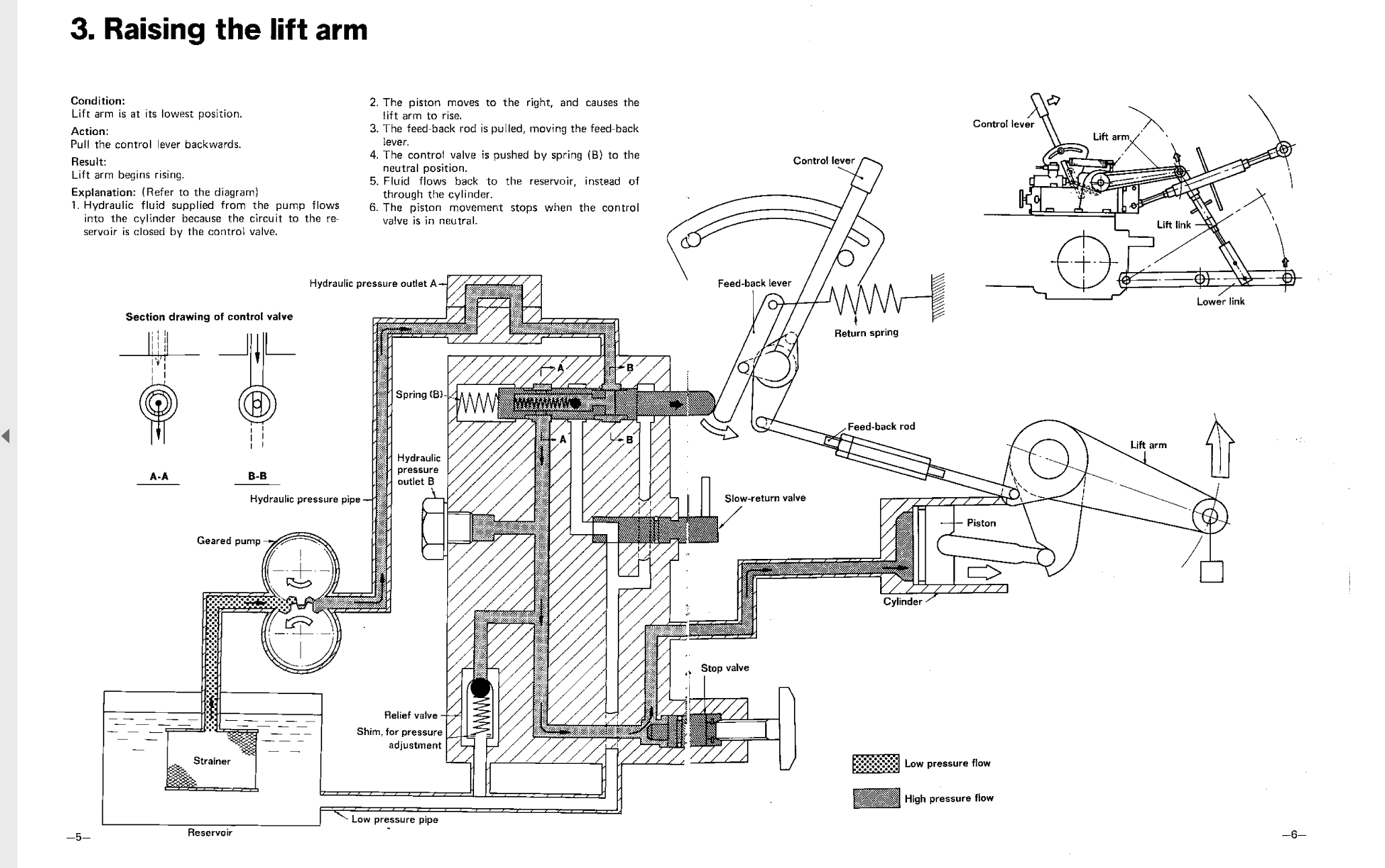

Yes, I have heard heard of it happening when the 3pt was forced high or low past where its internal stops. Usually by by backing into something while raising or lowering the implement and I guess it could happen by hitting a bump in transport with the implement lifted. In either case the lockage is said to be caused by the arms trying to move the piston farther than it is supposed to move.
Now keep in mind this is all hearsay; I've never fixed one that happened to.... or even seen one with that problem. So take it as a suggestion but not with real knowledge on my part. But the mechanical scuttlebut I have heard that it turned out to be either a broken return spring (simple) or else unfortunately something having to do with the piston push rod inside the 3pt cylinder falling out of position or somehow jamming the piston from moving.
The first is simple, the other one is more work. Neither is all that difficult. But don't force things. If it is the latter, you can break the piston and have a much larger job.

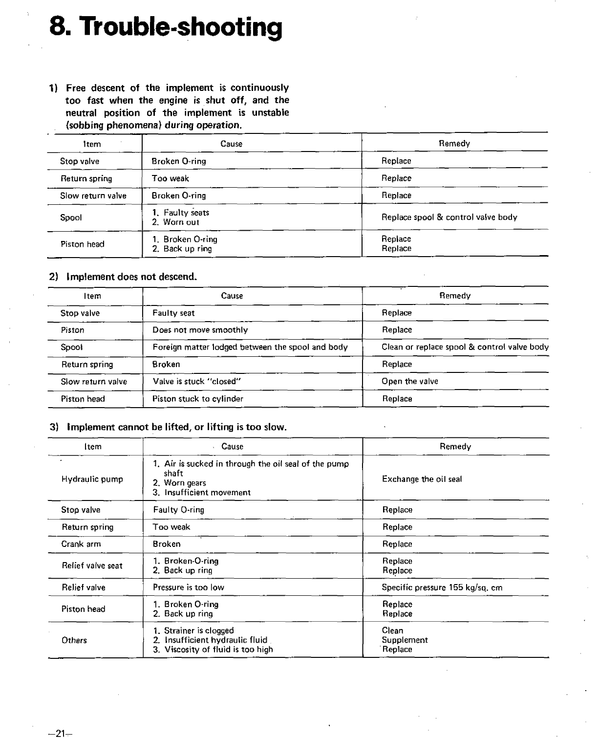

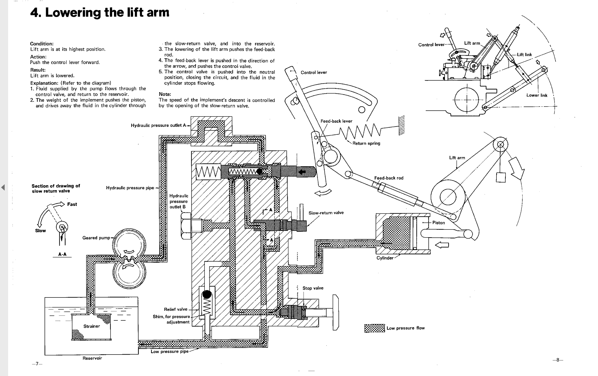

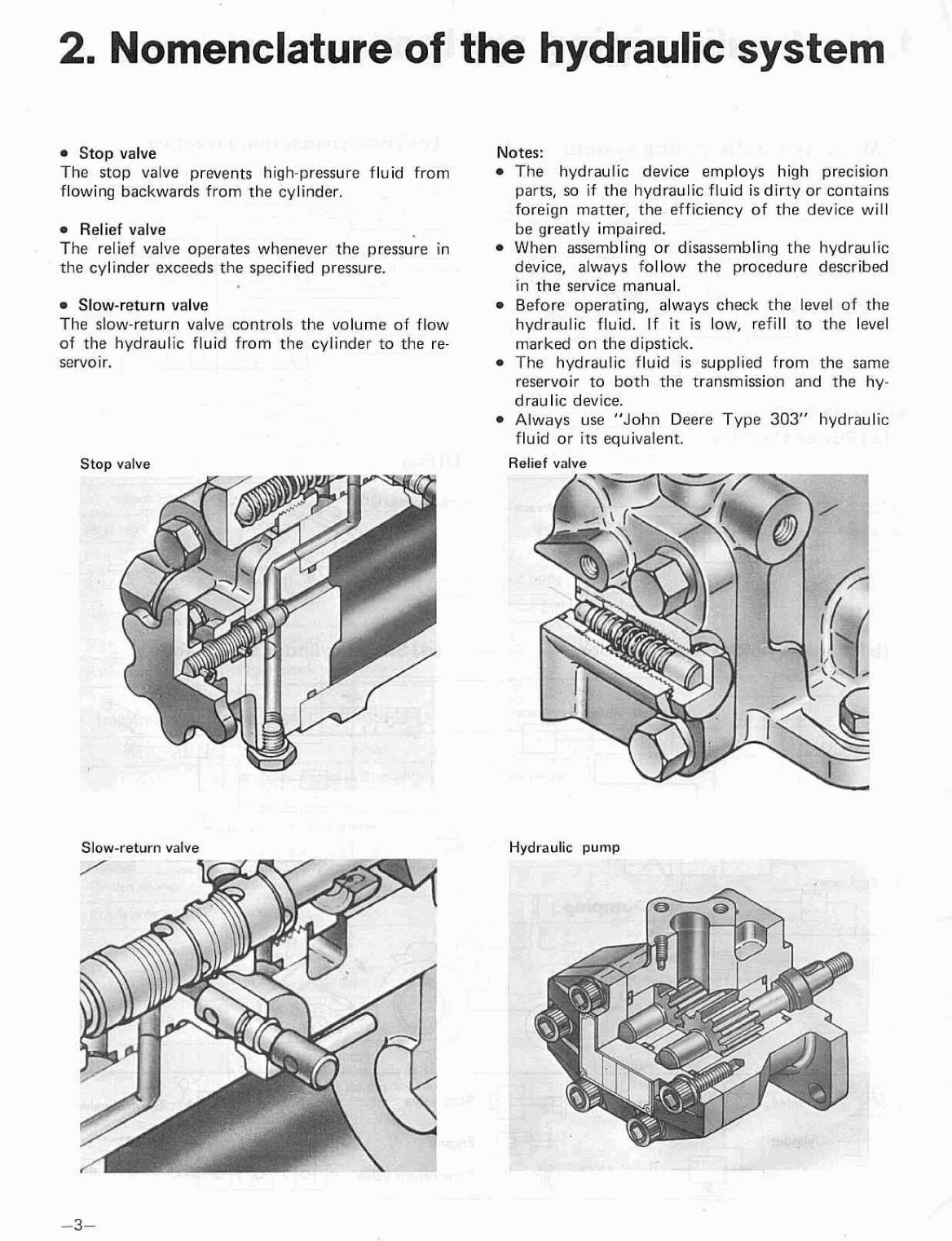

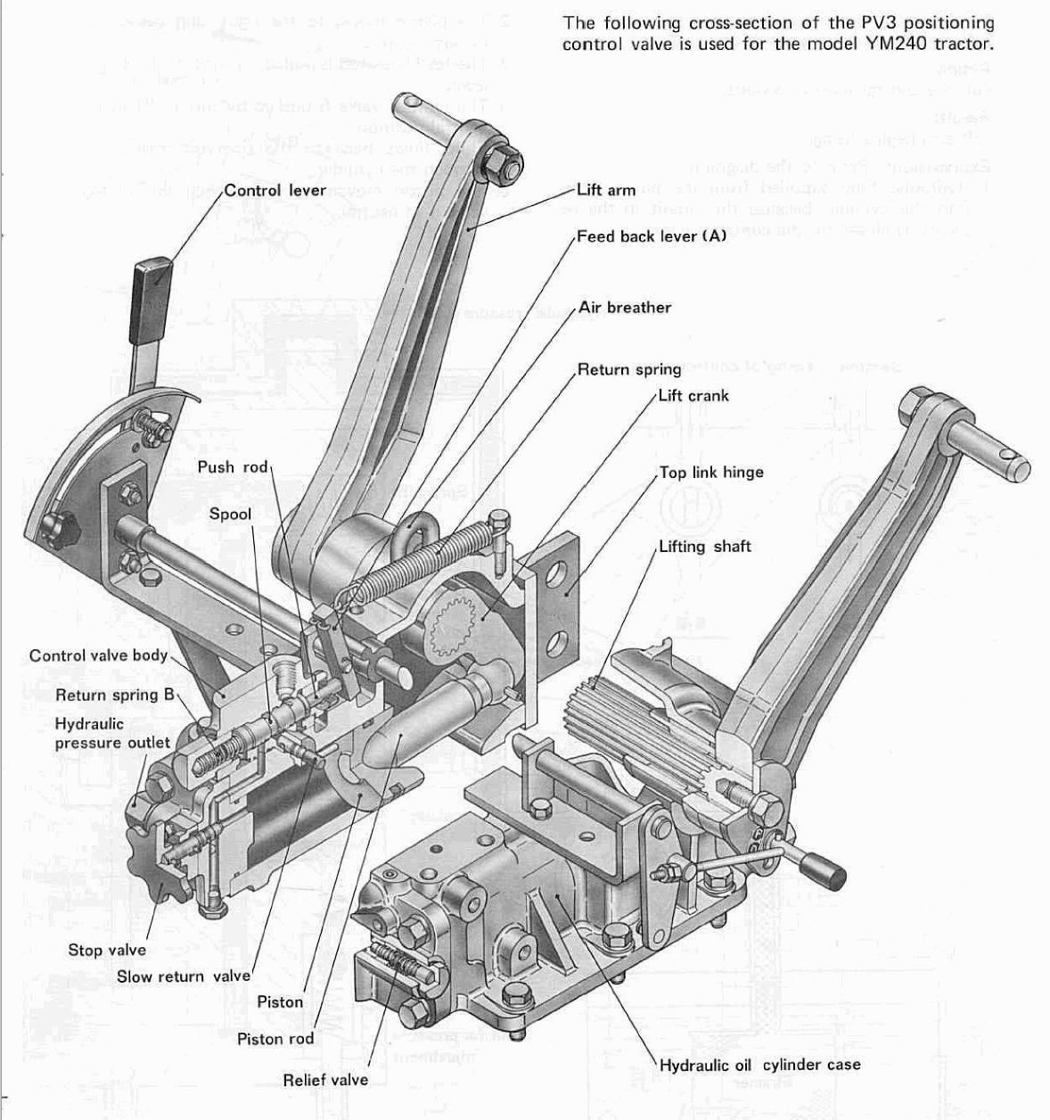

Here are some pages from the YM240 Hydraulic Repair Manual that you might not have seen & they might help.
There's hours of study material here, but if you understand one Yanmar 3pt lift you understand all vintage Yanmar 3pts. And like a lot of the vintage Yanmar designs they are among the best.
For that matter, the artistic work shown in the exploded diagrams from those old workshop manuals are the finest ever. Worth framing, IMHO.

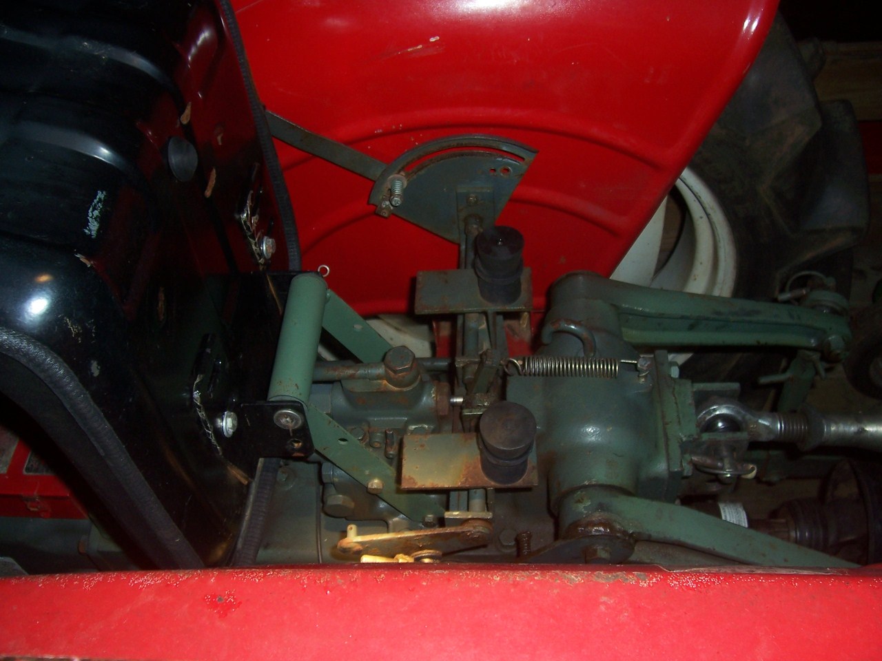

I'm with rscotty on the push Rod. Pay Attn. to the Feed Back Lever. The way it is showing in the Dia. I'm sure it is in the down position. Arms are all the way up but they will actually be falling. To Raise the position pushes in. Which your see the contact to the plunger is done by the bottom of the Push Rod Lever. That push rod should be moving so make sure it's not stuck in causing it to be stuck in the up position. My guess. The Arms In a bind is doubtful. :2cents:

I found a couple threads on a similar issue last night.
I cracked #8 in the photo. With the engine off, nothing happened. I fired it up to see if I got any flow. Nothing. But suddenly the 3 point dropped like a rock.
Tightened it back up and now it痴 working great.
I知 thinking maybe I pulled the raise lever all the way back, which is the wrong location. I suspect having it all the way up, and the drive home allowed the 3 point to bounce up enough to bind the piston.
I think maybe I got lucky. I値l be adding an adjustable stud to keep me from pulling that too far back and loading up the hydraulics. I致e got no reason to have the lever that far back.

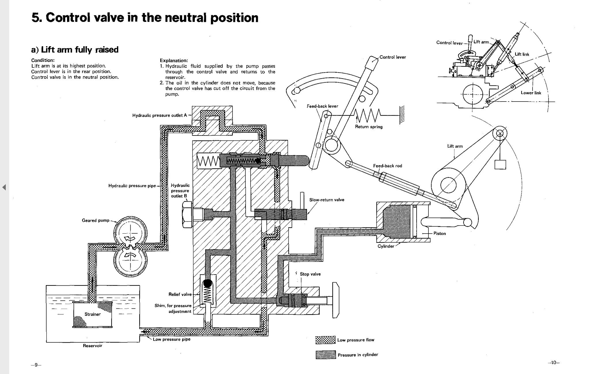

I underlined the parts of your message that seem to me to be the most significant. I have no idea if the FEL is hooked up right. That could be the problem right there.
But it does sound as though the 3pt hitch valving isn't working right.
Where I would start is describe how you have hooked up the FEL so we are all on the same page.
Most hydraulic problems on TBN come down to either a plugged up suction filter (cleanable in the Yanmar) or else it is how the FEL is plumbed. In this case we may have a 3pt valve problem too.
A hot pump is caused by restricted flow. Usually it is restricted return flow. That sounds like the FEL plumbing to me.
Yes, hydraulic pumps do run very hot. If it is boiling hot, the transhydraulic fluid is most likely been debased and will need to be replaced - but keep that old fluid until we find the problem. The fluid will be OK that long. You can use a light motor oil as your hydraulic fluid if you need to for diagnostics. 20w-20 is good.
Then for the 3pt problem - which may or may not be related .... or might even be dirt.... You go through the flow diagrams and artist cut-away illustrations in message #2 and study them until you understand how the valving is supposed to work. I think that you can then figure out exactly which valve it has to be since you found out that it lowers slowly and raises quickly.. those are key points.
Then having identified the probable valve, the cut-away illustations will show you how to find that valve on the tractor.
To help in your studies, I've also included the neutral postion flow diagram below.

Also see if one of those will help with the resolution of the drawing you posted.
There are some other settings that might help too.
For instance no matter whether you are Mac or Windows based, there is usually a "develop" or "User" tab somewhere in the tool bar that gives you a choice of how a forum editor relates to which web browser you are using.
OK. Back to Tractors and hydraulics.
The picture in message #14 came through clear enough, but it doesn't make sense to me hydraulically.
I would rather see it plumbed the way I described.
And BTW, make sure your return line running from loader control valve back to the sump is larger diameter than your pressure line to the loader. The return line should also be as short as possible. The idea is to reduce back pressure on the return line.
Also, I'm not clear if your loader valve has a power beyond port or not. Message #14 seems to say no PB port and #15 plus one of the drawings says it does. The other doesn't.
The power beyond port is NOT the same as the outlet (return) port. PB goes to another valve, return goes to the sump.
But you should always think about the following when using a new loader control valve:
Even when a loader control valve set has a power beyond or PB port, that port can be configured with plugs to fit two different types of hydraulic system. When you order a loader control valve it generally comes with both types of plugs that screw into the body of the loader control valve down inside the PB port. One plug is for an open center hydraulic system like you have. The other is for a closed center hydraulic system like some JDs have. You have to have the correct plug installed. If it's from Hoye, you probably do have the right one... if you have one at all....
Another piece of hydraulic scuttlebutt to think about.....When trouble-shooting or starting from scratch building a system you aren't familiar with..... you may find it easier to use a two lever FEL control valve with Open Center PB rather than any compact single joystick type. The old two lever controls are an older and simpler valve. So if you are buying by price, you can search around and get more control for your money with older two lever types. But that's probably NOT the problem here. Just saying......
luck, rScotty.

Hmm.... In message #15, the photo posted fine but doesn't help much. We need more views and larger. The drawing might be more helpful, but the resolution is illegible. EDIT (AN HOUR LATER: I CAN SEE THEM NOW. WHAT HAPPENED??) Also when you use contractions in the text it goes weird on my computer screen, making it hard to figure what you mean.
luck, rScotty.
I’m working on my phone and for some reason anytime I add photos, any punctuation of any kind gets all jumbled up after I post. It only does that when photos are added. Sometimes I have the patience to go back and edit it so it’s proper, other times it’s overwhelming :)
My verbiage was incorrect in an earlier post when I stated I plumbed the outlet of the valve to the 3 point.
It wasn’t until I posted the Hoye’s control photos I realized I actually used the power beyond port and the outlet port was plugged out of the box.
I simply trusted how Hoye had the control setup with the temp plastic plugs for shipping was the proper ports to utilize.
Their control didn’t come with any instructions at all and the photos I posted were all I had to go off of when installing it.
I don’t suspect the loader valve to be the culprit as when I tested the output directly from the pump, it had filled a 1 gallon jug within about 30 seconds. Then when I tested the output of the control valve utilizing the hose that would be plumbed into the inout of the 3 point, it appeared to flow a similar rate.
As I understand, this valve is not intended to use both the loader and the 3 point simultaneously.
Also, this 3 point got stuck up like this once before on be before I ever installed a loader valve.
I suspect something is amiss within the 3 point itself causing pressure to flow into it, but not out. That’s where I get stuck since I have no real world experience with hydraulics to be able to reliably diagnose what the issue is.
It appears these are fairly simple mechanics, but without the knowledge of exactly what each piece does, it’s hard to break it down.
I’ll make a video tomorrow of exactly how I have it plumbed, and what I’m finding so as to better illustrate the condition.
