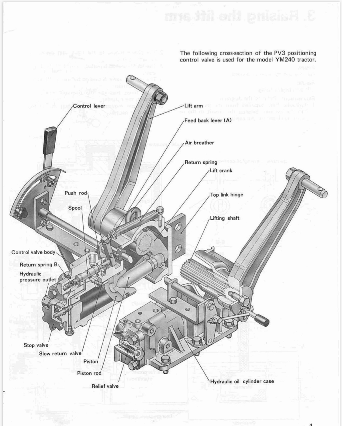

I have the 240痴 hydraulic diagrams and briefly looked at them, but they made my head spin.
I will look more closely at them.

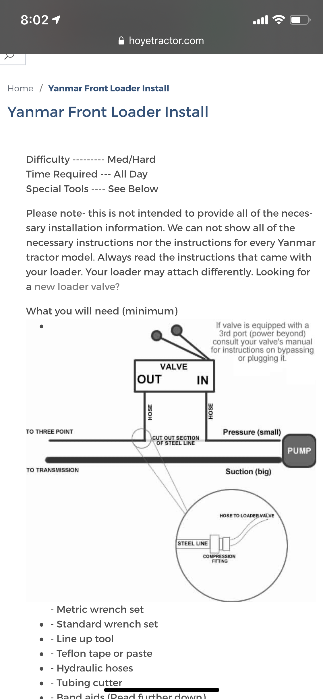

The way the FEL is hooked up:
The previous owner replaced the inlet line from the pump to the 3 point with a hose. I took that hose and installed it on the inlet port of the FEL.
I then took the outlet hose from the FEL and plumbed it to the inlet of the 3 point.
BTw, the FEL valve is the one from Hoye. As I understand, this is the proper one for this machine.

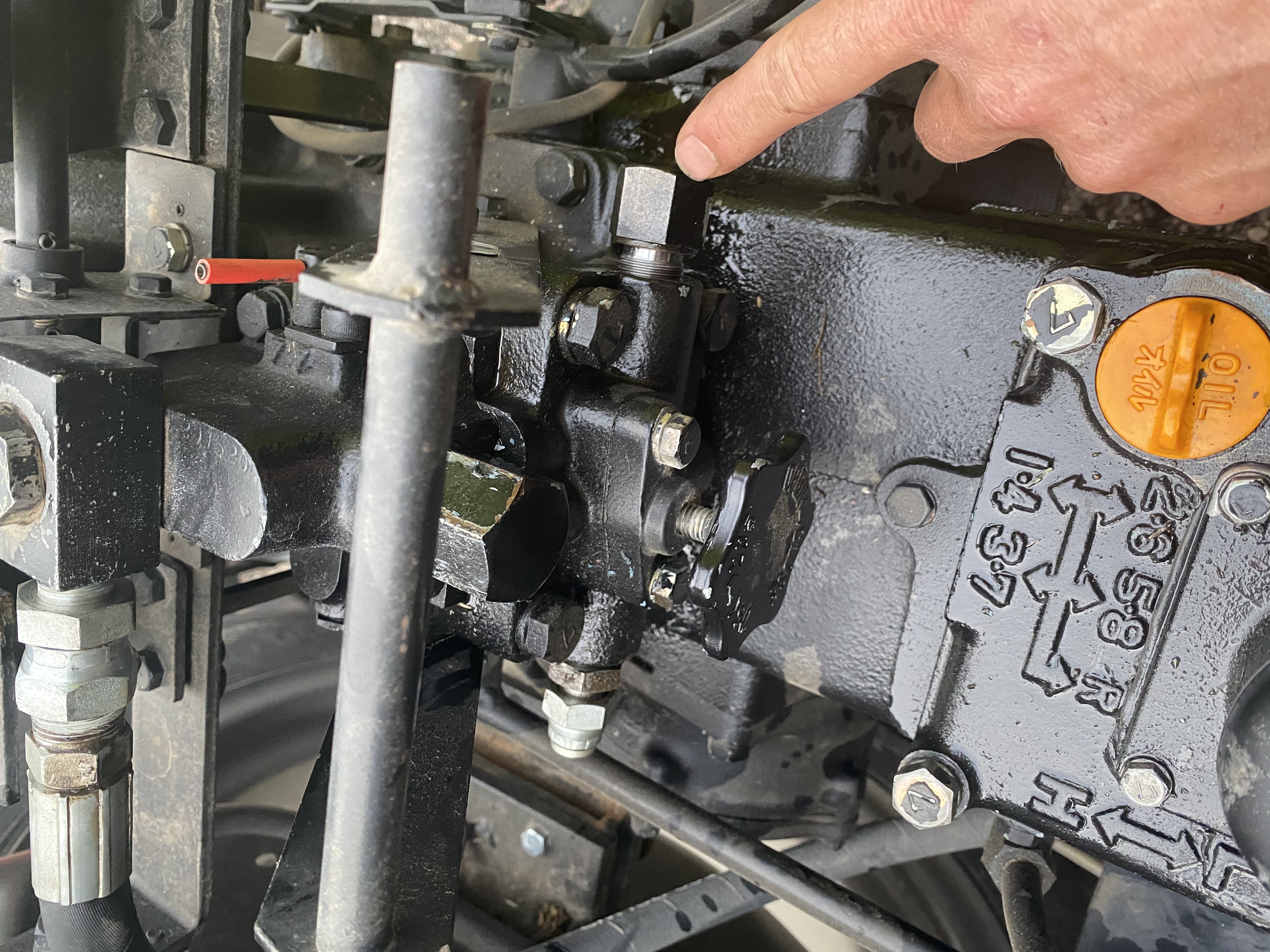

Looking at a cutaway of the 3 point, I noticed the 塗igh pressure outlet and the relieve valve are swapped on my machine. The relief valve is located on the passenger side of the machine.
Out of curiosity, I wanted to remove the two and see if there was and differences internally that would prevent me from swapping the two back to match the cutaway.
Upon unscrewing the High Pressure Outlet cap, the 3 point hagan to lower. With each turn, it lowered more and more until it had zero pressure on it at all.

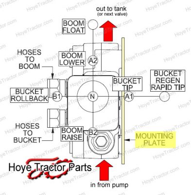

Perhaps I知 reading how the loader valve is intended to be plumbed then.
This one does not have the power beyond cartridge.
Has 6 ports. 4 for loader up/down and tilt/curl. Then one inlet and one outlet.

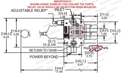

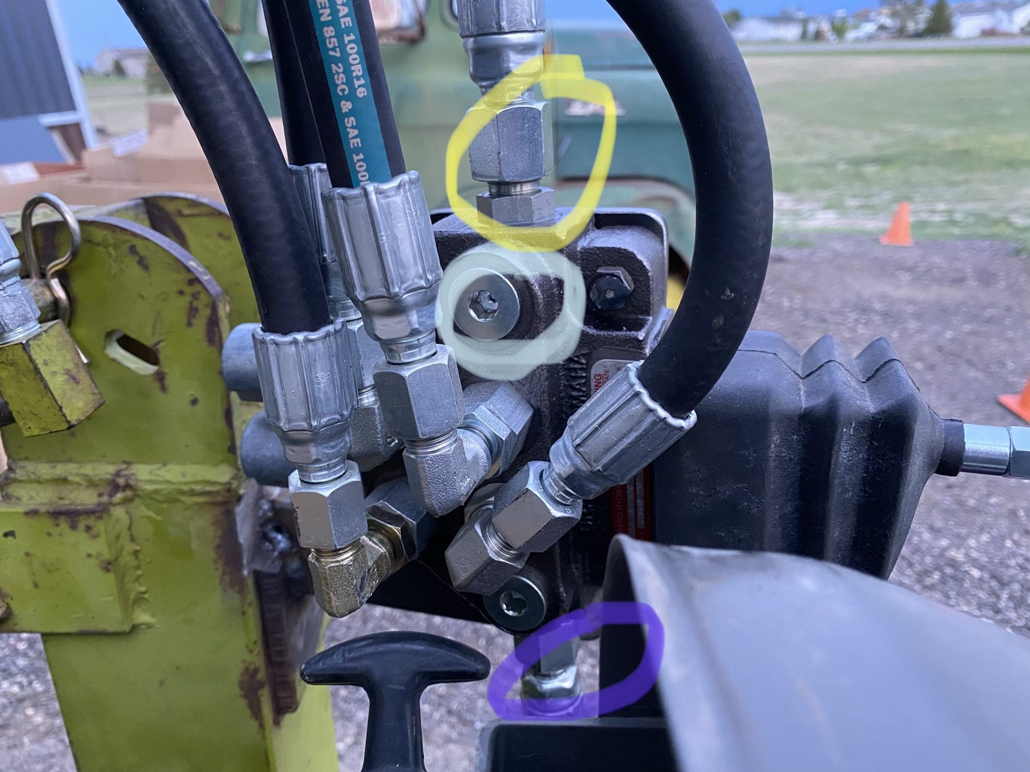

F1572644-5FBF-44FF-A9DA-869D47A7435C.jpeg730B56D1-7461-48E5-9FEB-9344DD4247F8.jpegFD2987F6-6DEA-41BE-A393-9F54170DA664.jpeg
Here is my valve.
Circled in yellow is the 菟ower beyond port which goes to the 3 point.
Circled in white is the 登utlet which is plugged.
Circled in blue is 妬nlet which comes straight from the hydraulic pump.
Also attached are the photos of the Hoye diagrams.
I think I plumbed it right?!

Hmm.... In message #15, the photo posted fine but doesn't help much. We need more views and larger. The drawing might be more helpful, but the resolution is illegible. EDIT (AN HOUR LATER: I CAN SEE THEM NOW. WHAT HAPPENED??) Also when you use contractions in the text it goes weird on my computer screen, making it hard to figure what you mean.

The picture in message #14 came through clear enough, but it doesn't make sense to me hydraulically.
I would rather see it plumbed the way I described.
And BTW, make sure your return line running from loader control valve back to the sump is larger diameter than your pressure line to the loader. The return line should also be as short as possible. The idea is to reduce back pressure on the return line.
Also, I'm not clear if your loader valve has a power beyond port or not. Message #14 seems to say no PB port and #15 plus one of the drawings says it does. The other doesn't.
The power beyond port is NOT the same as the outlet (return) port. PB goes to another valve, return goes to the sump.

I’m working on my phone and for some reason anytime I add photos, any punctuation of any kind gets all jumbled up after I post. It only does that when photos are added. Sometimes I have the patience to go back and edit it so it’s proper, other times it’s overwhelming :)
My verbiage was incorrect in an earlier post when I stated I plumbed the outlet of the valve to the 3 point.
It wasn’t until I posted the Hoye’s control photos I realized I actually used the power beyond port and the outlet port was plugged out of the box.
I simply trusted how Hoye had the control setup with the temp plastic plugs for shipping was the proper ports to utilize.
Their control didn’t come with any instructions at all and the photos I posted were all I had to go off of when installing it.
I don’t suspect the loader valve to be the culprit as when I tested the output directly from the pump, it had filled a 1 gallon jug within about 30 seconds. Then when I tested the output of the control valve utilizing the hose that would be plumbed into the inout of the 3 point, it appeared to flow a similar rate.

I suspect something is amiss within the 3 point itself causing pressure to flow into it, but not out. That’s where I get stuck since I have no real world experience with hydraulics to be able to reliably diagnose what the issue is.
It appears these are fairly simple mechanics, but without the knowledge of exactly what each piece does, it’s hard to break it down.
