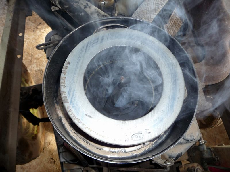

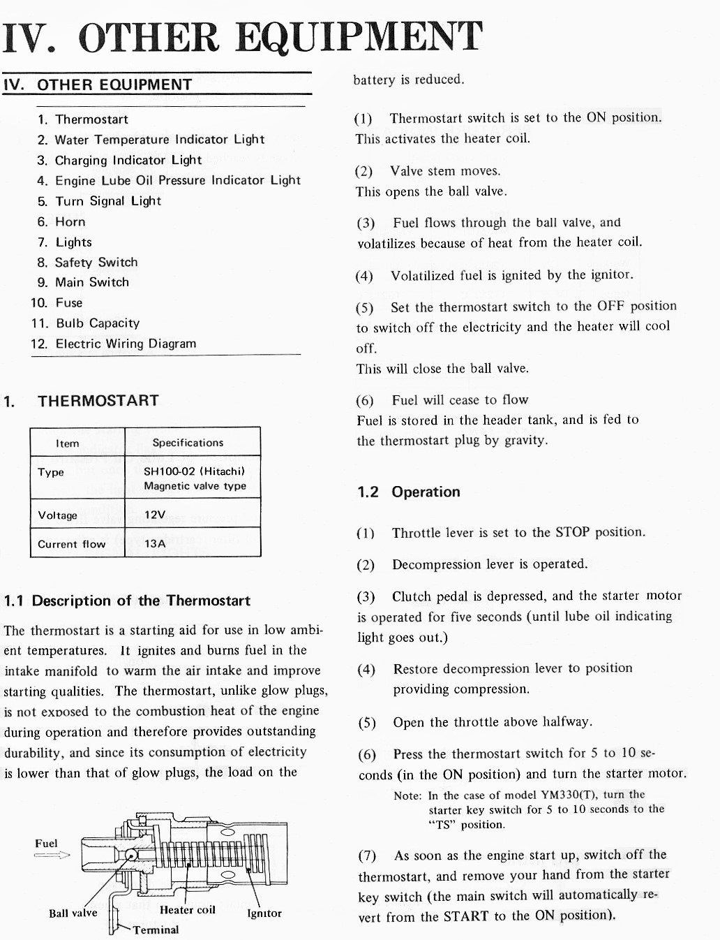

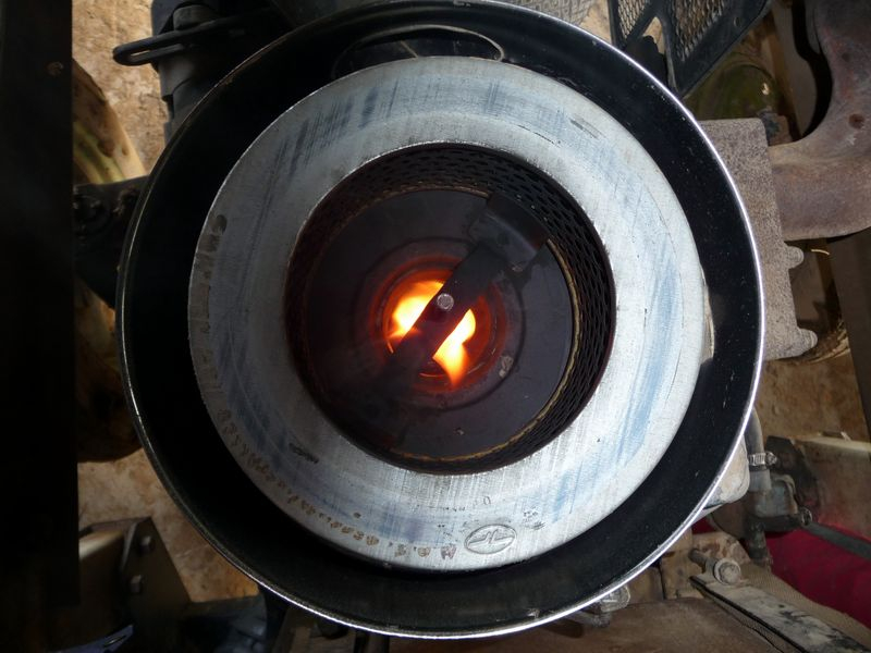

/ YM2310 starting issue? #19
Plug it in and turn it on.
Fire in the hole. The POP.
The burn goes sizzle.

/ YM2310 starting issue? #20
Hey I resemble that remark (or something like that) :D . The Hitachi SH100-02 part # specified in your document, is visible on that dead Thermostart from my YM240 resting on the Perkins box in my photo. Maybe it was original from 1980!
And the Pop and Burn photos? My YM240! I posted them here long ago and told Aaron he could use those in his Thermostart description. I recognize my 'Installed 11-07' and '120 hours' written on the air filter element. Ok, end of personal rant. Well until someone asks my opinion on something. :whistle:
