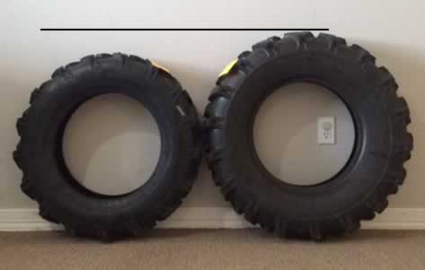

Tire sizes are all over the place and I don't understand why. You would think there would be a standard and everyone would just stick to it. Here are two 7-16 R1 tires with the same exact markings and same exact brand. One is easily 3" taller than the other. A 7-16 R1 Firestone falls right in the middle of the two. A Carlisle is a little different too.
View attachment 460136.
Having shopped the ag tires before switching to turfs i gleamed as much.... Love the turf tire kit I bought from you guys, and have no complaints... I can live with how my shifting is now, now that I know to be extra careful with the 4x4.
