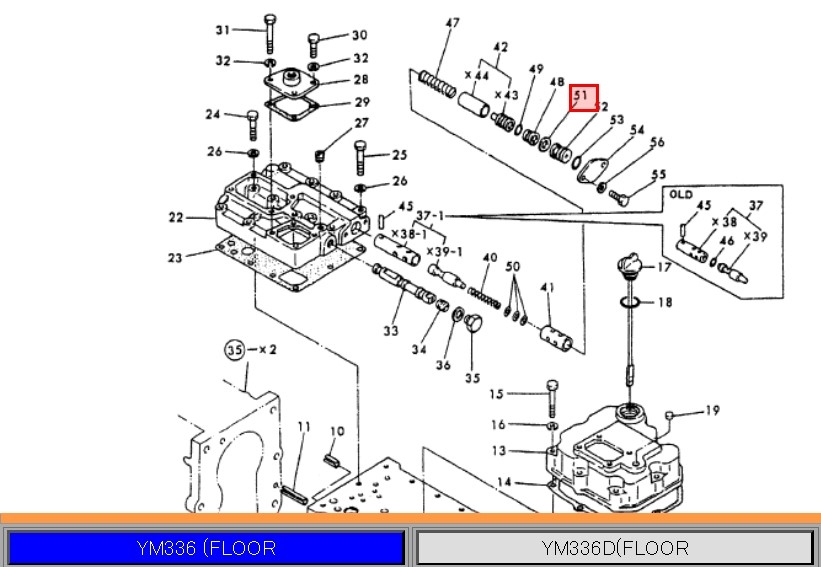

On the parts diagram, section 18 which shows the transmission pump, I cannot see a screen.
Please could you identify it from the parts manual.
/ YM2210 Hydraulics #8
Look for and They call it # TCG-4310 or a # PSG-2451 Regulator Gasket. Rectangle 4 bolt cover on the Valve body. On a the corner of it! I'm showing 2 of them so it's one of them. But this so rare and the screen itself and could be the same!

I have attached a pic from the YM336 showing the screen filter, item #51.
Your 2210 is likely similar and it can be accessed by removing the cover, item #54.
However, this would not effect the 3 point hitch.
The Power Shift system has a separate pump than the hydraulic system for the 3 point hitch.
Your problem is something common to both systems. Which is the oil.
I would suggest draining your hyd/trans oil again, pull out the filter screens and clean by washing with gasoline, thoroughly dry before re-installing them.
Then re-fill with a premium trans/hyd fluid.
Preferably one graded as J20B or C.
