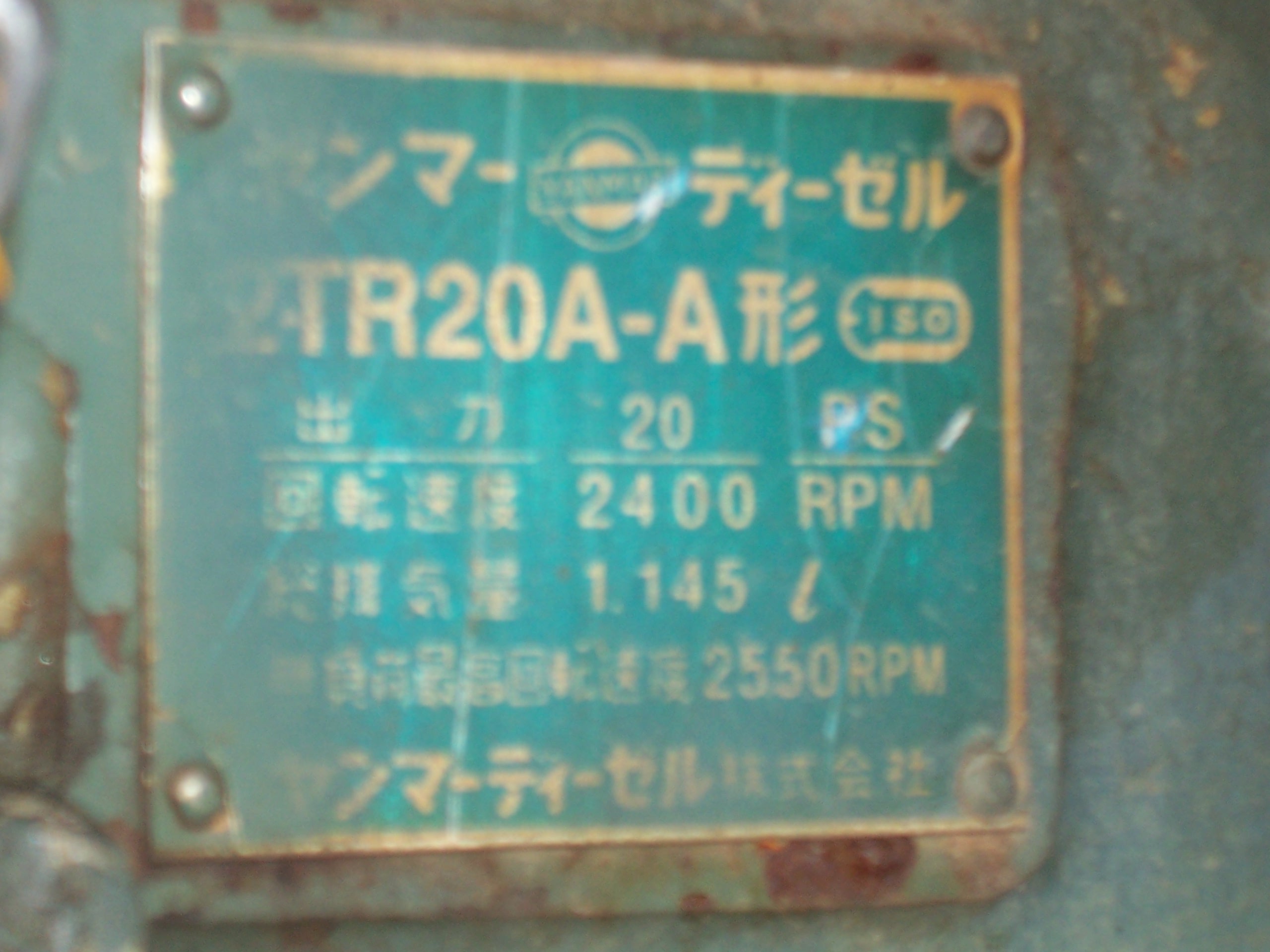

Real interesting to me. Why? I have only heard of 1 other person with the 2TR20A-A. And it was in Ga. Yrs. ago. There were 2 used tractors In Spaldings shop when I bought mine from Steve. So at least now I'm pretty sure what happened to the other one. At least the Eng. anyways. And with more of the Refurbished Grn. In the can overspray. Just happened to look at the Tag. in MTF. and seen the last 2 Dig. and 80. I ran out to check if I could see mine and it's 84.

I'm good Clemsonfor. I would try to contact him. I tried but it wouldn't let me. See if you can!!
You've seen mine run and honestly it's gotten better since you've seen it. I have my 2nd. Gear PTO. working really good. So good I have Rarely even used 1st. much at all this season. And after the last oil change I'm shocked how quick the oil pressure comes up now on a cold start with the Decompression. So try and get those parts. I hate to say it but you may probably need them before I will.
