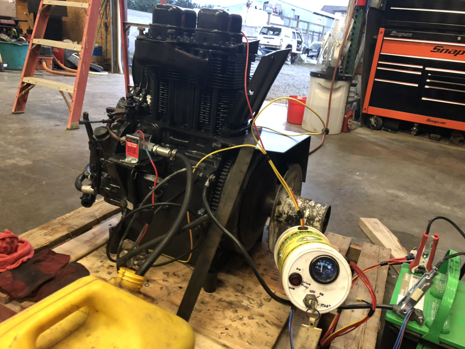

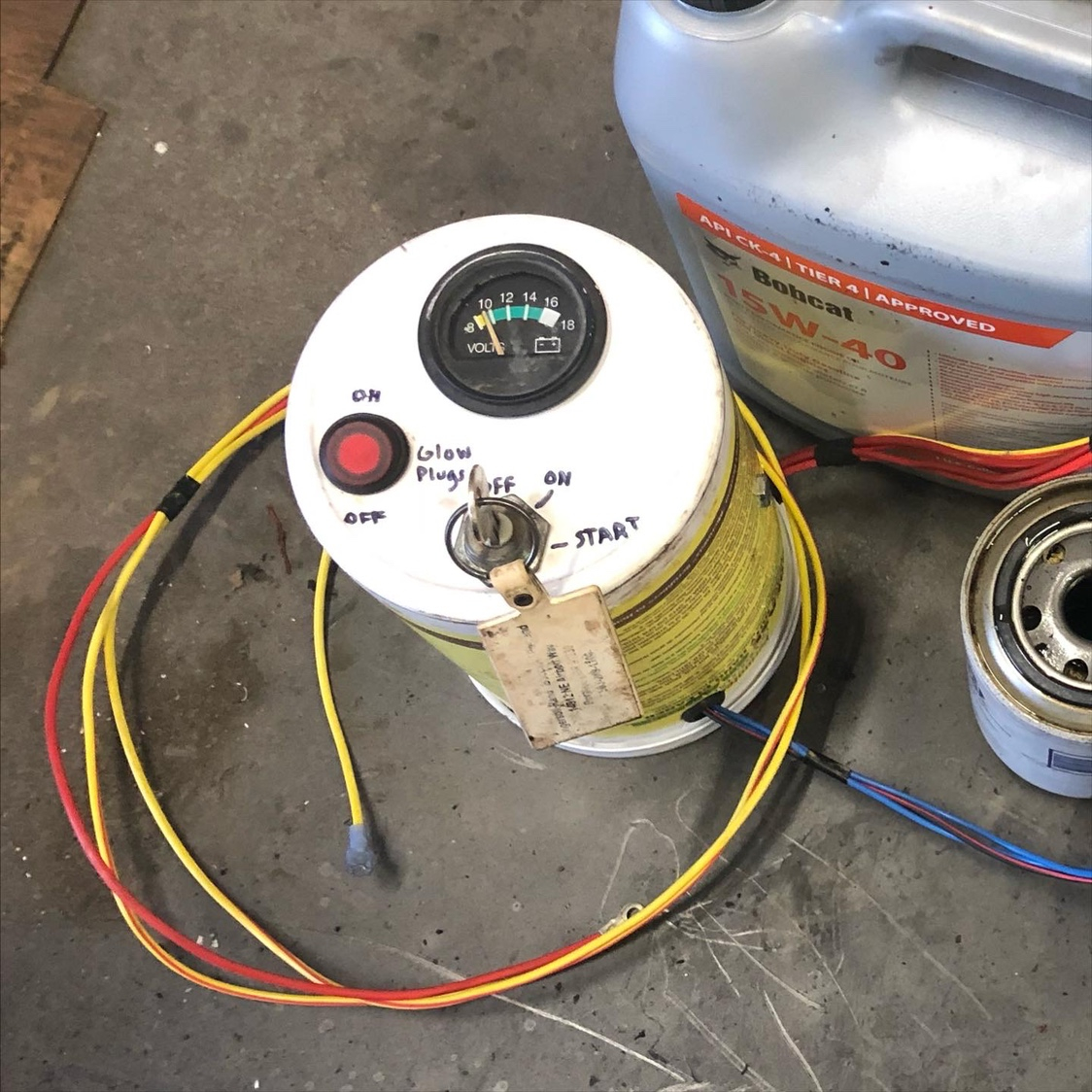

Love your hand cleaner "instant electrical system"! You get so much done so quickly. It is very impressive. Thanks for sharing.
All the best,
Peter
For as simple as it is it sure is handy for engines that don’t have a functioning electrical system handy. I built it for a Duetz F2L410 2 cylinder air cooled engine that I had out of an M600D Bobcat that I got running last year. I wanted everything in a box basically so I spent an afternoon stuffing wires, old bobcat parts (switch and volt gauge) and relays into that old tub of towels until I got the end result.

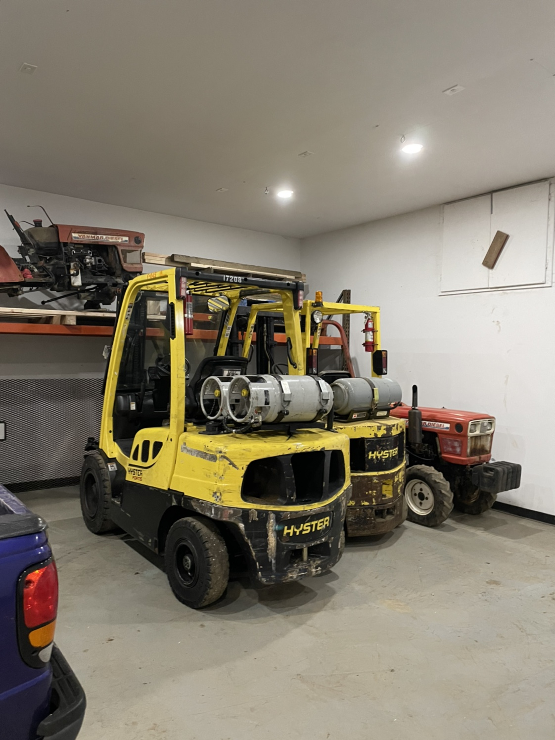

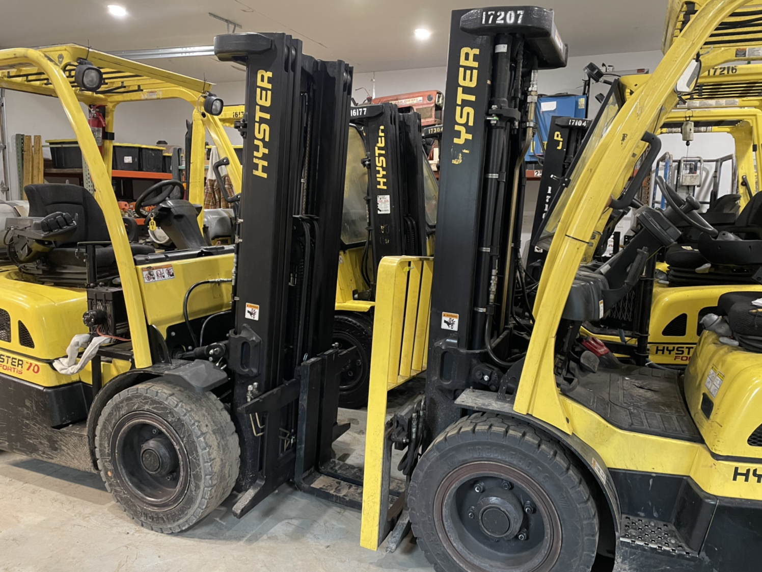

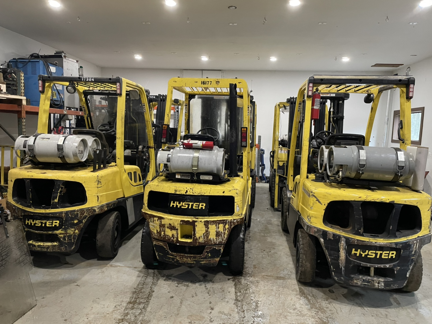

Small update. Havent gotten too far on the 187D, ended up picking up a bunch of forklifts to fix up which has pretty much consumed my shop space. Will be back on the Yanmar once I get these forklifts fixed up.

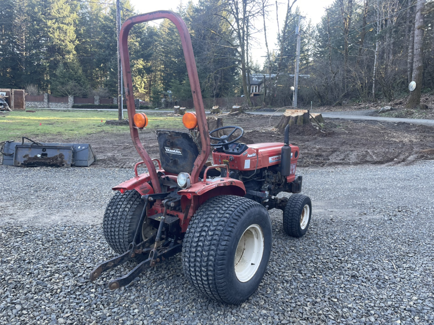

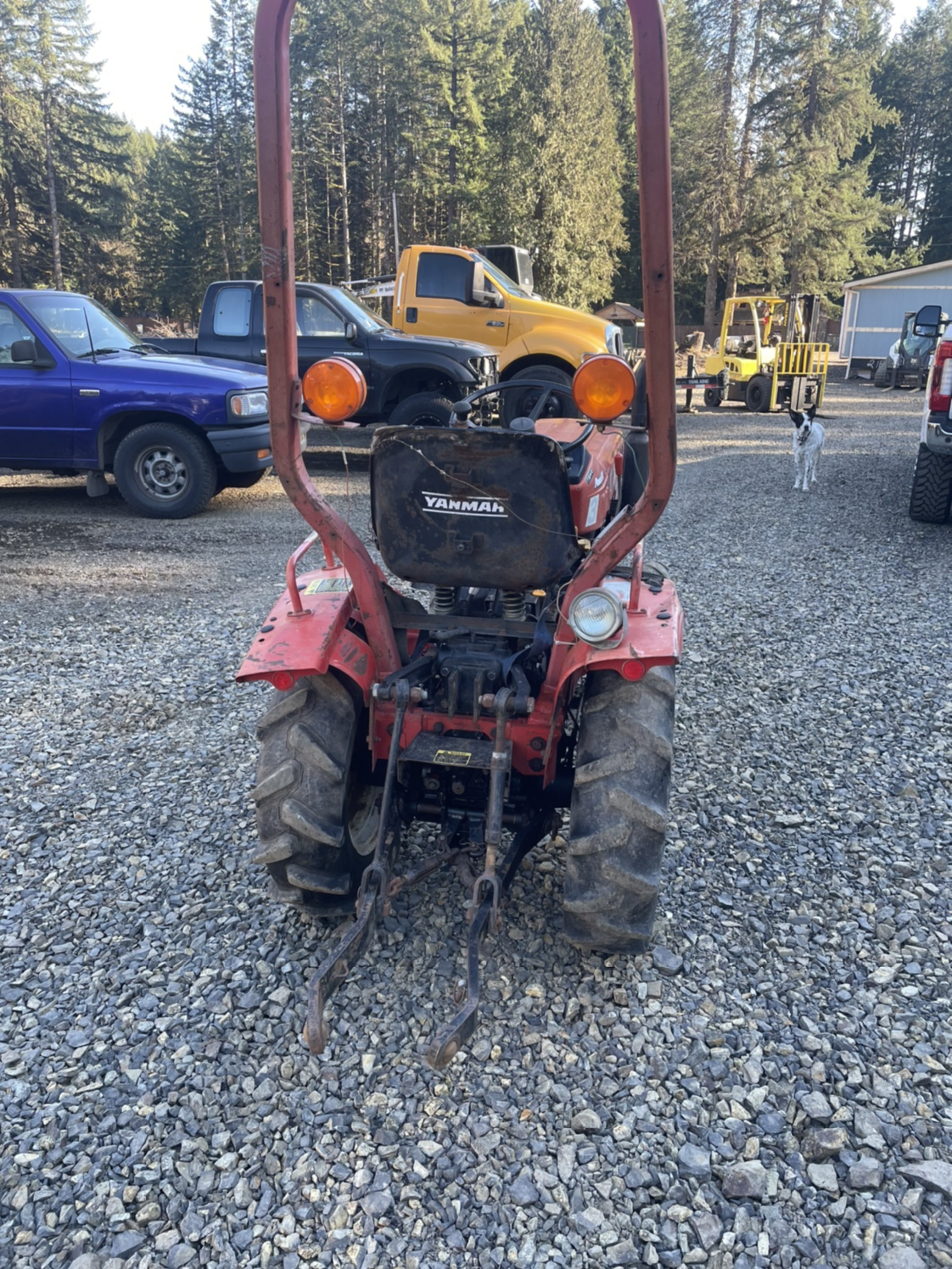

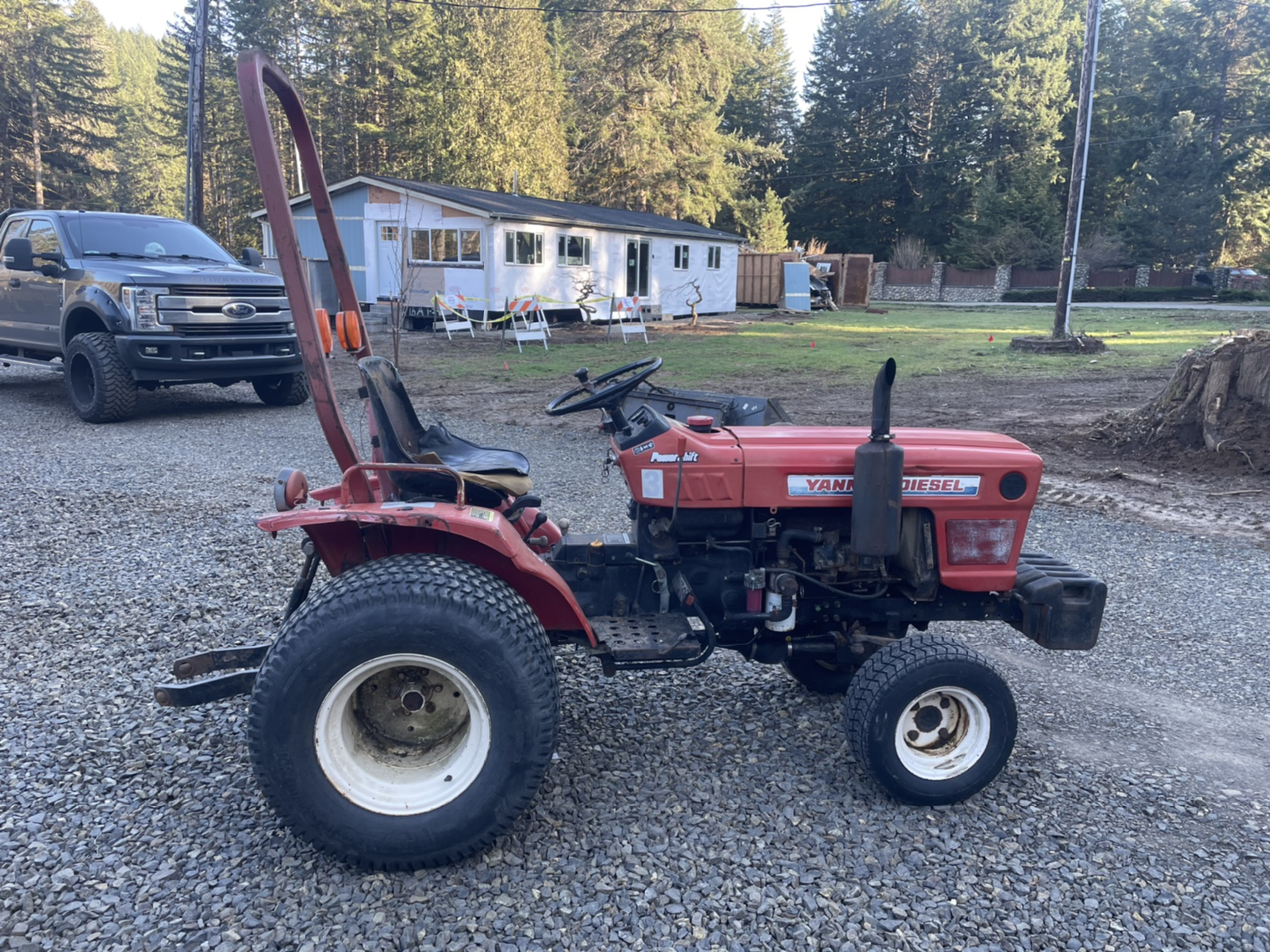

Small update:
Found a set of turf tires off of another 187D yesterday and got them mounted up. Now the drivetrain won’t work against itself in 4wd, the rear tires that were on it were from a 165D.
