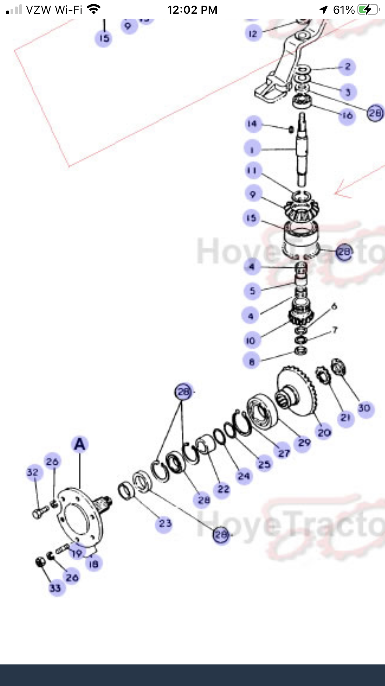

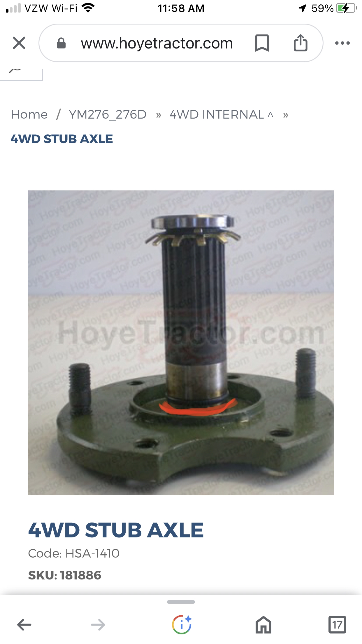

Hi gents,
I’m having issues breaking my front left stub axle. I am on my third one in 1.5 years. It’s getting old dropping 350 on a repair every time. Admittedly it is when I have a load in the bucket but after the first one I have began to be more careful and it keeps happening. Yesterday it snapped off with a load of snow in the front bucket… certainly not so heavy it should have broken again.
Is there anything I should be looking at that may be out of alignment? Tow, camber, ballast weights etc?
I did have the tire ballast removed from my left rear when I got a flat a few years back. I did this so I could get the tire off and to a shop easier for repair when flats occur or anything else. Would that be doing it? I have countered this by making sure I have a heavy implement off the three point when using the bucket… Ie during the summer I have the box blade off the back and during the winter I have a snowblower on.
Any help would be appreciated I sure am tired of replacing stubs. Thank you.

Snaps right where the center meets the hub, See photo of axle.
There are snap rings involved but if I remember right from my last install the top silver piece in the photo threads on last to hold everything together. Here is a parts diagram photo as well and link to hoye to determine what is what.
It does have a differential lock.

Three in a year and a half is excessive. I suspect that you have an underlying issue that is causing the problem.
I would suspect something is wrong in the 4WD set up, unless you drive on pavement or other hard surfaces with 4WD engaged.
Are your tires the correct sizes for your tractor? Is the differential lock on or off? How sure are you that it is off? Is there a chance that the front or rear differential could have been replace with a different gear set?
