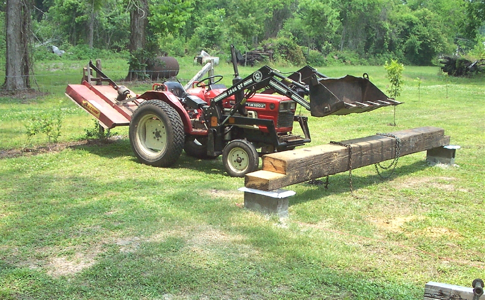

I have a 2wd YM1802 with a frontend loader and am very satisfied with it. You have to use a little common sense with a loader, whether you have 2wd or 4wd, and avoid overloading it when possible and always keeping your load as low as possible.
I have (unwisely) overloaded my bucket many times putting 700 pounds more on my front wheels than their load rating, while trying to keep my load close to the ground and avoiding holes and rough terrain. These Yanmars are extremely tough machines that can handle lots of abuse but they are easy to tip over with a loader if you are not careful.
I just moved a 12x12 creosote beam that weighed well over 1000 pounds before I cut 5 feet off it with no problems taking it slow and easy. (see photo)
Loaders on 2wds are extremely useful and handy to have but just are not quite as safe or able to handle as much weight as on a 4wd.
Wow. Where did you find that beam? Gonna make a bench?:D
This is driftwood. I live on the River Road on the banks of the Mississippi River. I got a few of these last year off the banks. They are probably from ship docks that have been damaged upriver. I would hate to hear how much they sell for. I am building a small building and using them to make a very strong foundation in case I decide to move it to another location. (a little overkill) I will start a thread soon on this building made mostly of driftwood and salvage from Katrina.
