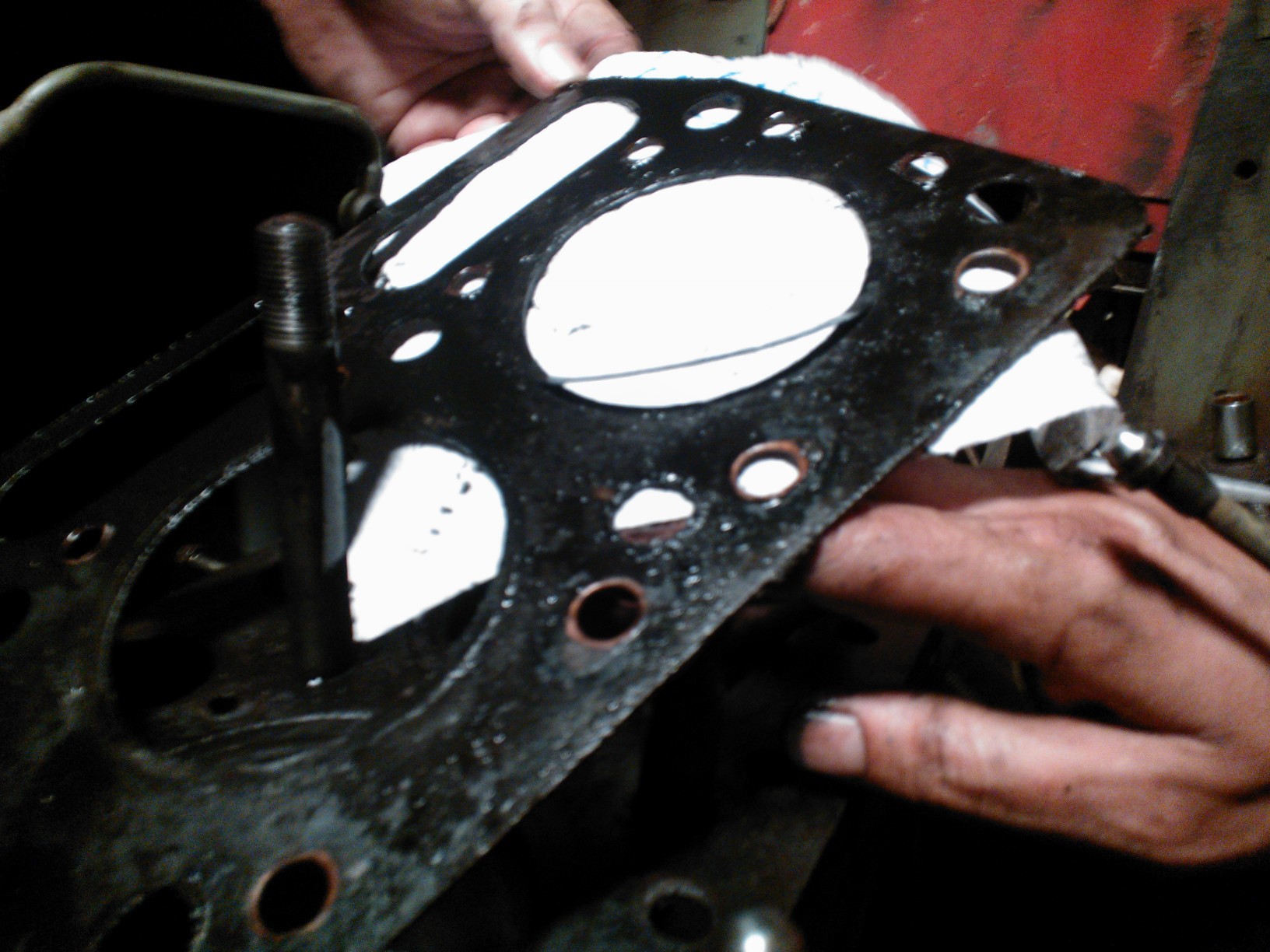

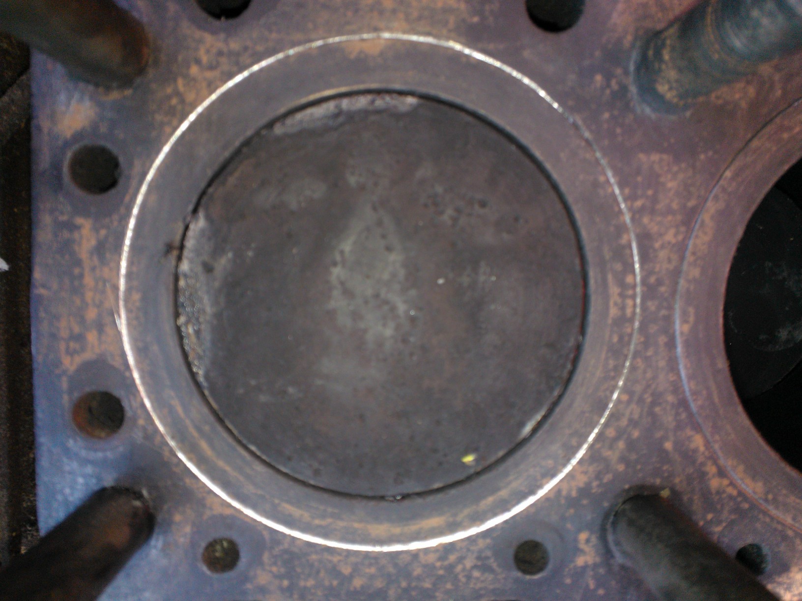

I pulled the head off of my tractor this weekend, suspected blown head gasket. There was no gasket dressing, or so it appeared, put on the gasket. I know it specifically calls for it in the shop manual. Also there was a substantial amount of carbon build up on the block. Is everyone using gasket dressing of somme type? Is heavy carbon build up normal on the top of the block? Could I be so lucky for my problem to be an improperly installed head gasket? The head is in the shop currently being checked for cracks- keep your fingers crossed.

Can you post pics of the things you are asking about? btw I personally would like to see pics of the gasket on both sides. Yeah copperkote wont hurt a thing in this instance its optional though like I mentioned but peace of mind is a good thing.
Here they are if it worked-

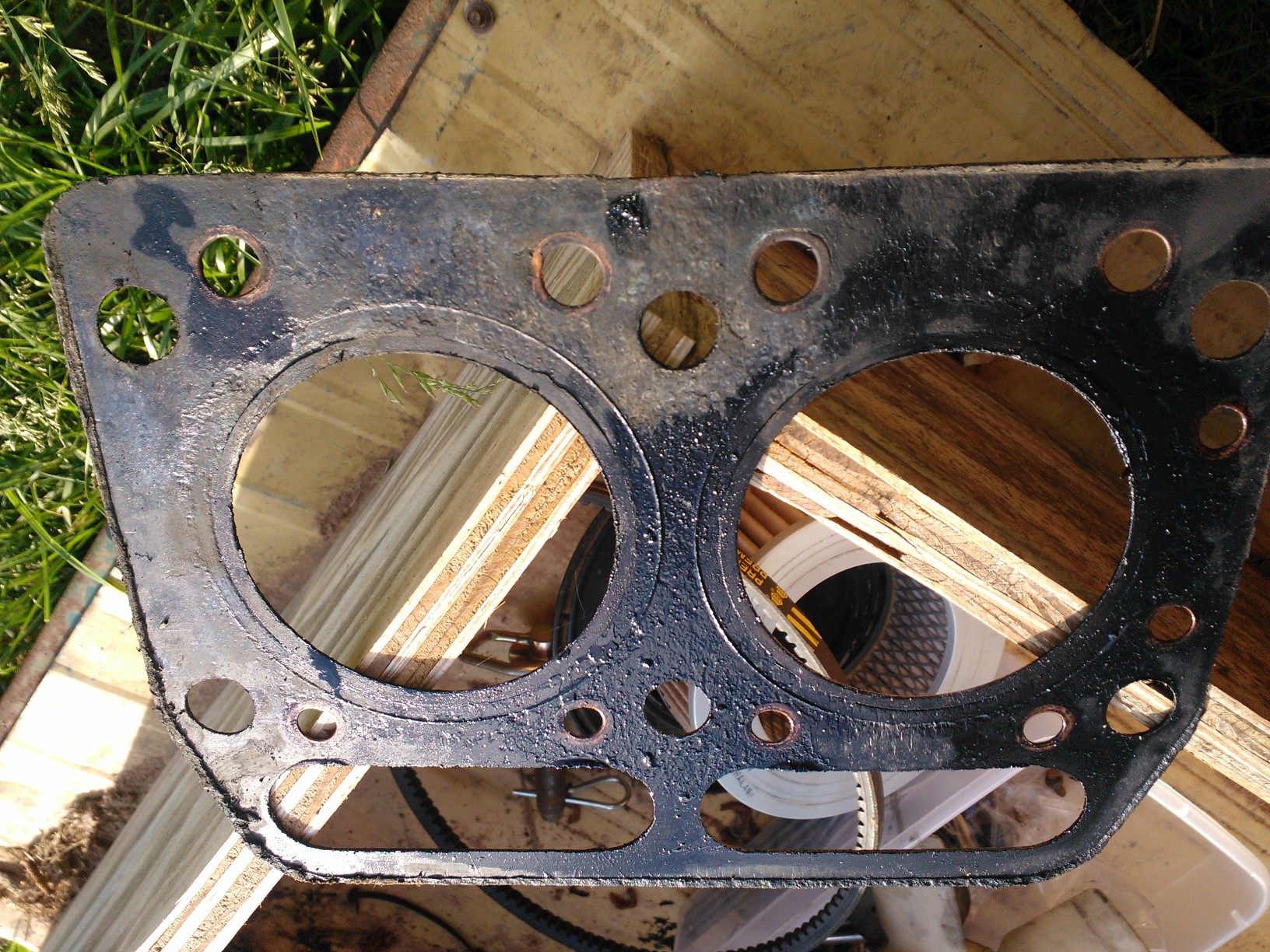

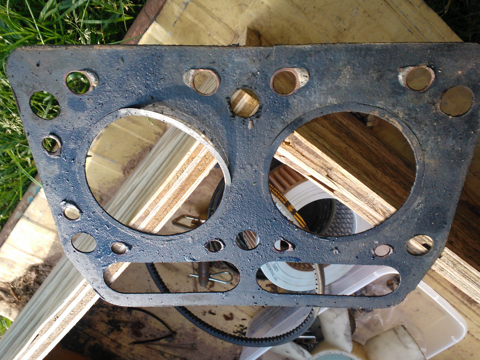

The two picture I sent before are from the night I removed the head, these two I just ran outside and took-Still makes me wonder how good that gasket was sealed if there was alot of carbon under it. If I had the proper instruments it could have been measured in some places- probably 1/32 minimum in places, but to one degree or the next it covered the block.

I agree with you that gasket is in pretty bad shape alright it looks like several places it had leaked besides the cracked fire ring and that was definitely a leak. I didn't see much of the carbon or where it was though but scrape it all off the deck and piston tops you should be good to go.
fwtw I use a rubber sanding block and 80 grit air file sand paper and spray oil as a cutting fluid to finish clean engine surfaces works the best for me.

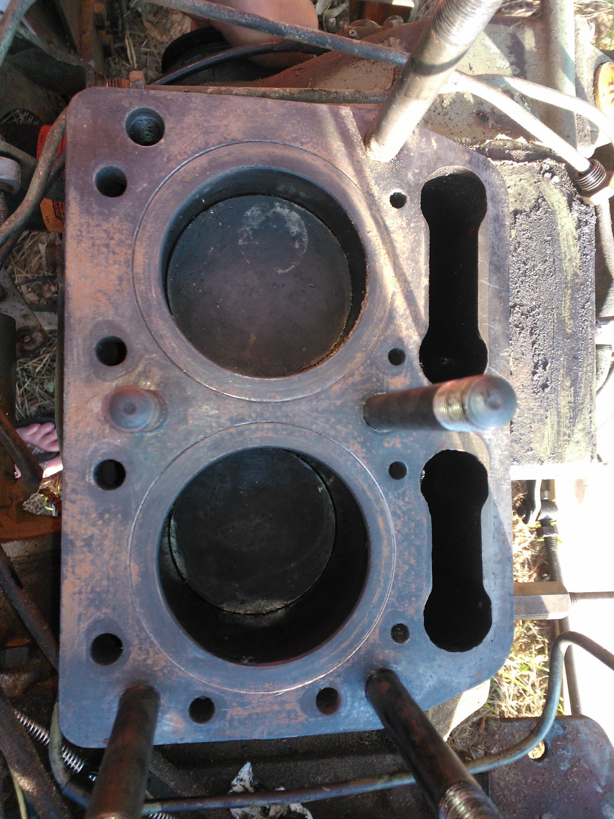

Did I see some crosshatch in that back cyl? The pics were focused on something else I couldn't see real detail no biggy just would mean the cyls are still in super good shape is all.

I didnt feel or see any crosshatch. Cylinders were pretty smooth. I do however have access to a hone. I am going to pull the pistons out and put new rings, I was getting a little blow back before head gasket issue. I plan on having this old girl a while so I want to put some money in the engine while im in there. I will post top of block piston shots tonight. There is some damage to the top edge of the pistons maybe its nothing. I will be interested in getting a second opinion.

I know nothing about hones, except my friend is a fork lift mechanic, and he said if I put in new rings come by his shop and I can borrow his hone. I had no idea why, just know he knows his stuff. Now I know- Thanks. I have learned a ton from this forum. Ok here are the over head shots I promised. Tonight I also pulled the #2 piston (closest to radiator). Not 100% sure but I think I will be buying pistons and rings. WP_000566.jpgWP_000571(1).jpgWP_000568.jpgWP_000567.jpg
I was able to feel the lobes on the cam- they felt good-no noticeable wear. Also felt the crank shaft- felt good to me.

Ok on to the parts I agree on replacing the pistons yikes I hope the cyls are ok! The one piston shows a valve has been hitting it slightly that bothers me. I can think of a few ways that could happen like a weak/broken valve spring or bad rod bearing (you said the crank was ok so this probably not it) or what is more likely excessive carbon build up on the valve and/or piston but w/o putting hands on all I can do is guess sorry.
Id sure have your buddy check it over and see if I am seeing what I think I am seeing to be on the safe side it may not be anything but to see something that is different like that is a red flag to me! hth

If I am looking at the drawing right that is an exhaust valve. Could it just be out of adjustment? The shop working on the head will let me know if I have a worn out or broken spring. The cylinder is smooth- I wonder if that damage isnt a past artifact and maybe there has been some partial work done at some point.

I agree it is an exhaust valve they typically are the valves that hit just because they are open as the piston is going up. As far as being that far out wow imo it would have had to be held open all the time since it only requires .006" clearance but that is just me thinking logically its not an indictment of that idea.
A more reasonable or feasible idea may be worn cam and crank gear set which your buddy could help you with all you need to do is use a bar and socket on the crank and move it back and forth watching the cam.
