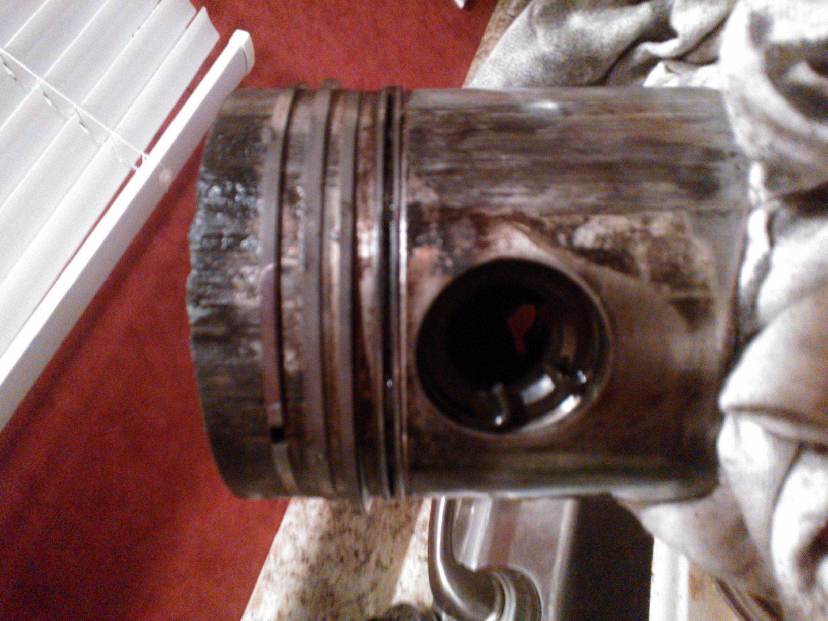

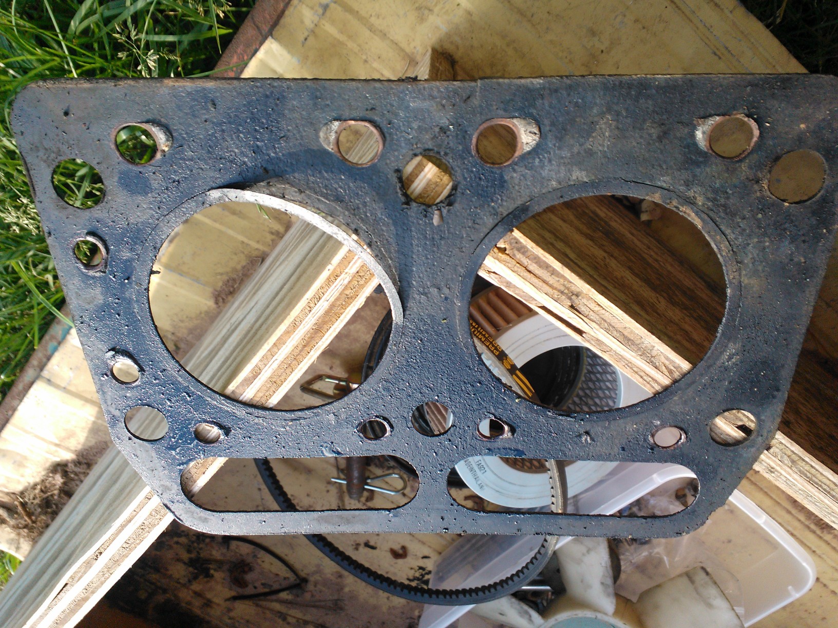

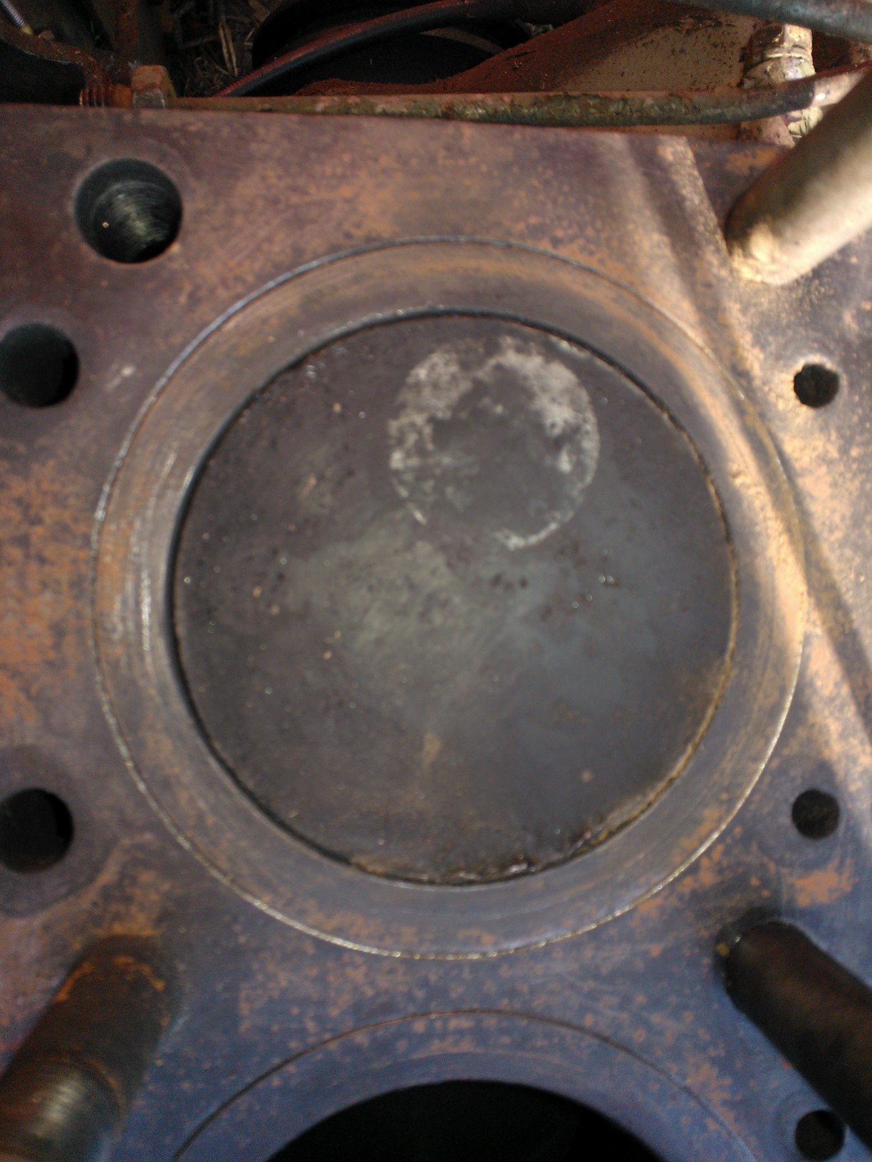

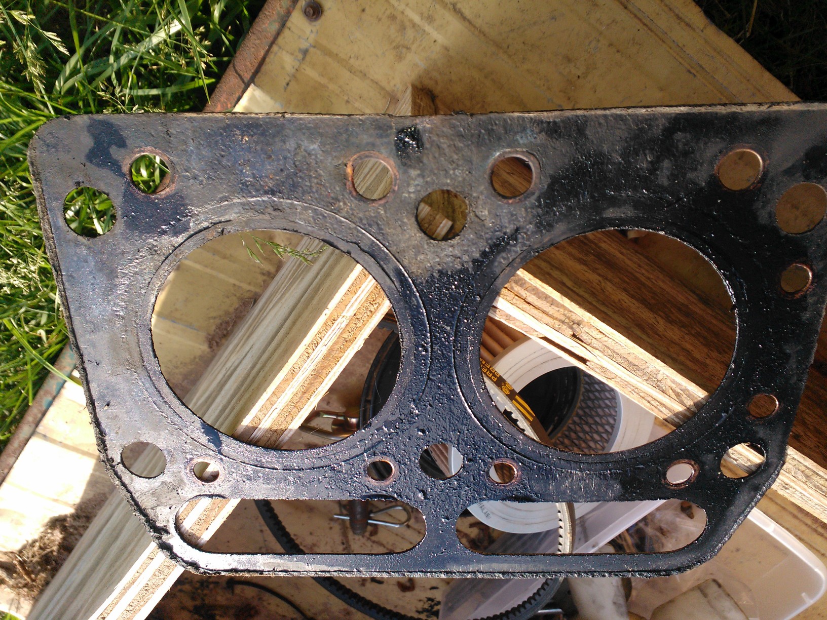

Someone's been in that motor!!!! Looking at the damaged to the Piston and from what I can tell from the Pic. of the Cyl. wear doesn't match the piston. I'd almost Bet money that Head wasn't Torgued Properly looking at the Carbon on both sides? The pics. are good and can be Deceiving so that's just IMHO.

No way I will ever know, but thats what I have been thinking. Im definately not the first in the last couple of years. Need to get it right this time. Still no word on the head from the shop.....Its driving me crazy.

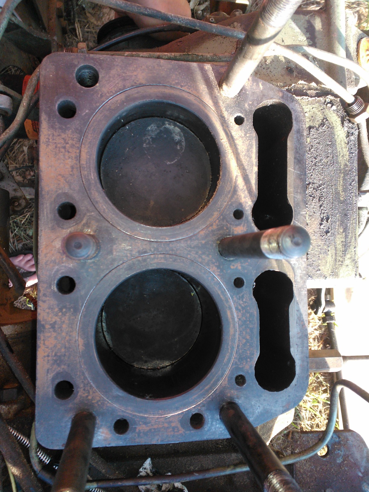

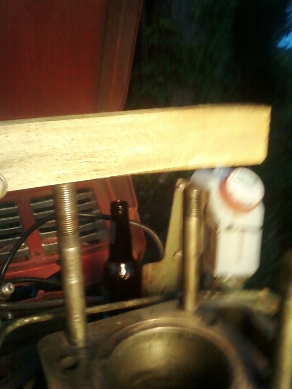

Ok more pictures. At first I thought the cylinder head stud was put in upside down. Now Im not sure if its the right part. There are six on the block. One is obviously shorter, is the one on the left front suppose to be longer? In the parts drawing it looks longer, but those drawings can be deceiving. When I removed the head the whole thing unscrewed. You can see the height difference in one of the attached pictures.

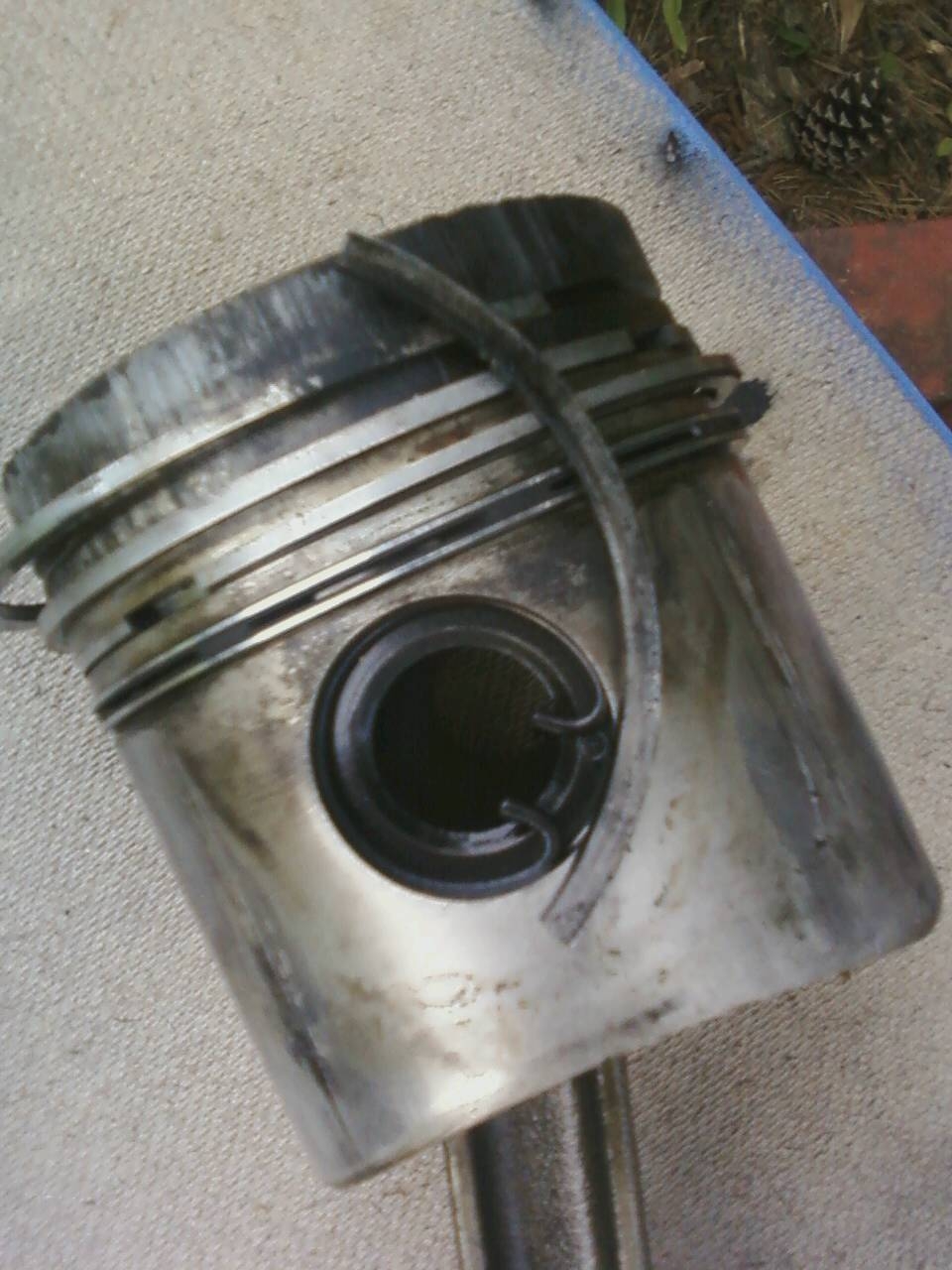

I didnt notice last night but the top ring on that piston was broken. I feel lucky- guess I could have some serious problems.
/ YM 1700 head gasket #26
The parts manual shows 4 studs with the same part number and 2 studs with differing part numbers. 3 different part numbers total. The one on the front left does show a quantity of one.

#27
Thats good to know, thought I might have a problem. I have a shop manual, need to get a parts manual. Does anyone have a trick to cleaning threads in a situation like the head studs. I have been threading/ pushing a rag in and out.
/ YM 1700 head gasket #28
When rings break they will wear the cyl walls something terrible and they also wear out the ring grooves in nothing flat so good thing you are putting new pistons in. The studs are different lengths on mine there is a step in one corner of my head so your stud arrangement is probably ok just guessing.
I use a tap and die if I can find one I have also taken a cutoff wheel and cut my own thread chasers out of bolts for bolt holes so as I dont take any metal out with a tap. If you have an extra bolt I could tell you how or post a pic but I doubt you will find one that size. A wire wheel is going to be the best thing just having clean threads is all you need an run a nut on and off several times.
Did you do any cleaning on that piston it looks awful shiny and nice? I am wondering if this engine was rebuilt and then severely overheated by the looks of the melted piston top above the top ring? just thinking out loud.

The piston is like it was when I pulled it out two nights ago. Didnt even wipe it down.
