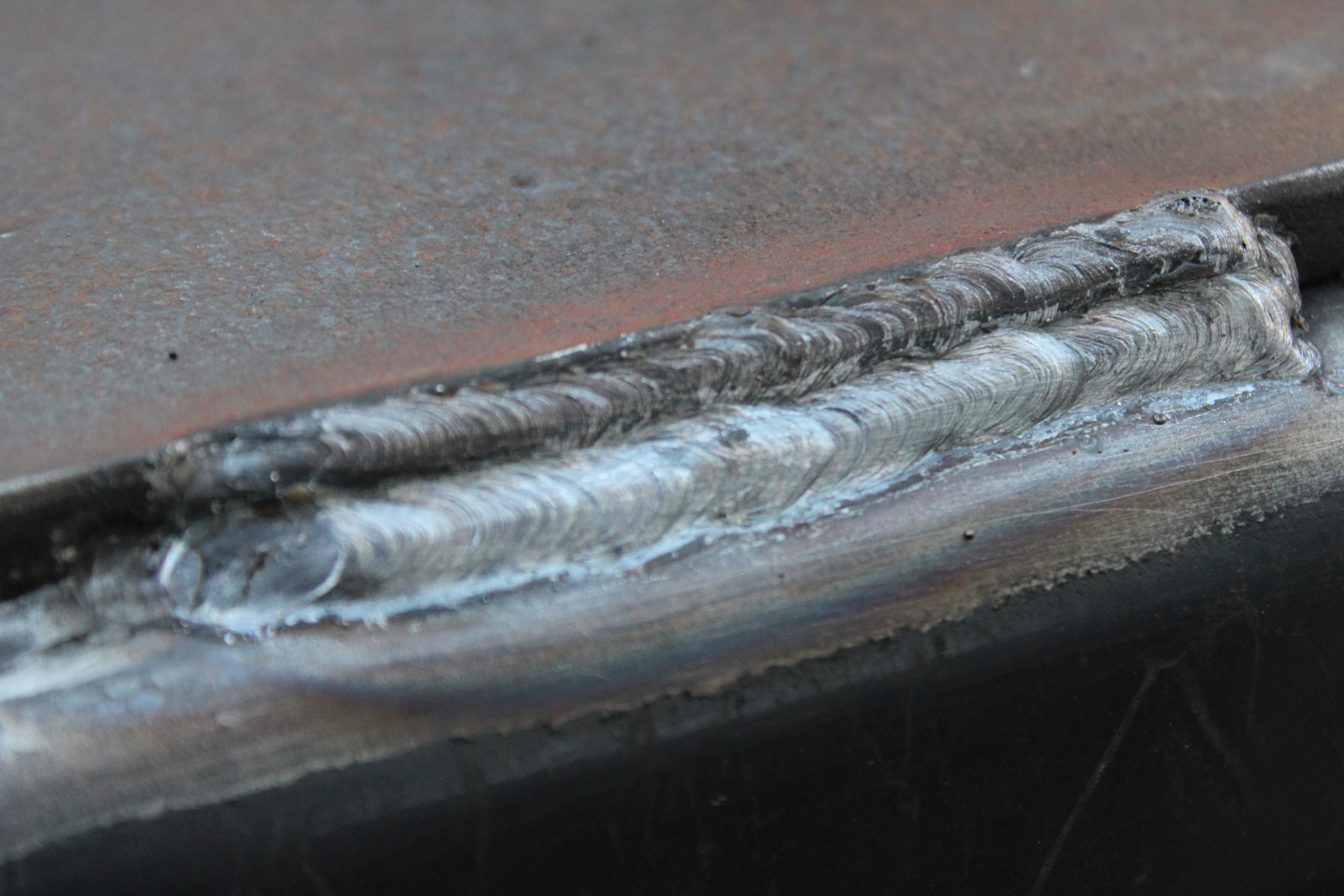

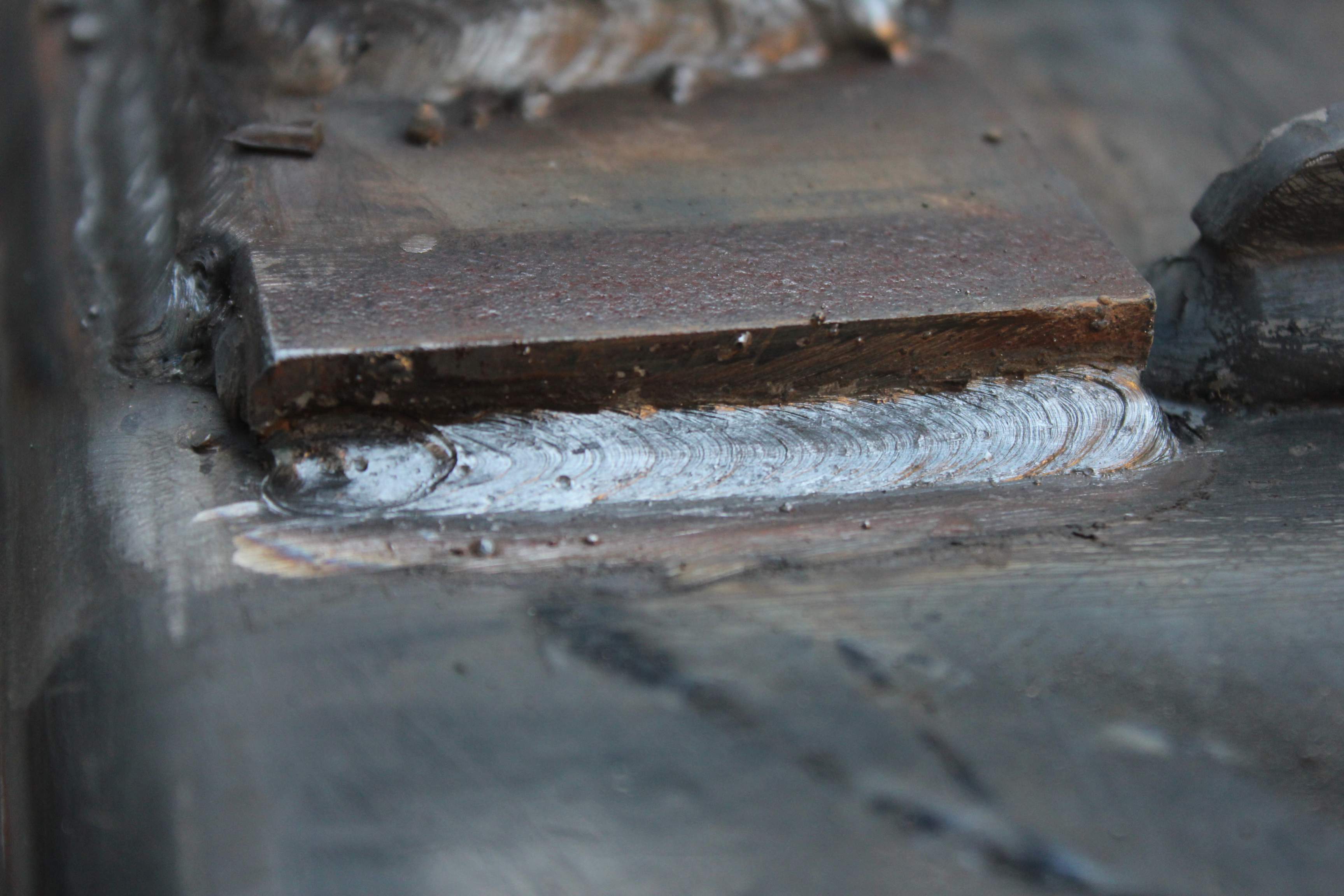

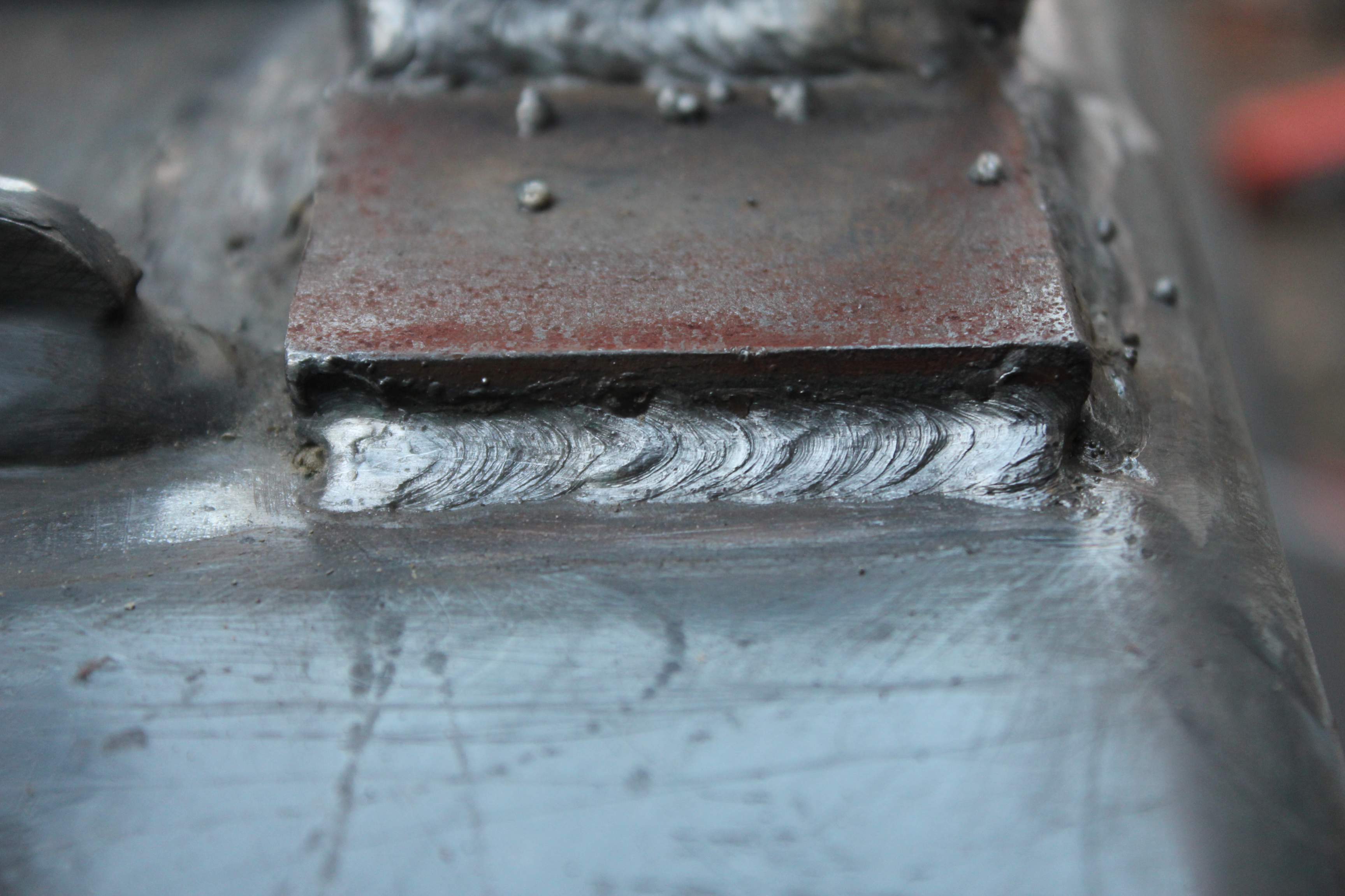

Here's a few photos from today's work. After grinding out nearly all of the 6011 welds and going over with 7018, I am adding a 2nd and 3rd pass, building up weld in the joint. I also welded the sides of the base plate and closed off the hooks per suggestions here.
I just got done putting the last set of beads on and grinding off a few little bits of spatter. Tomorrow's task will be putting on the receiver tube.

I have to say those welds dont look half bad. You are getting the hang of it. NOW if you can do that in all positions you will be on your way to becoming not a slow welder or a fast welder but a half-fast welder.
/ Yet another bucket-mod thread #54
Joshua, your welding is getting better and better.. Keep at it.. I am just a Half-"fast" welder myself, at best, on a good day.:)

Thanks, James and Gary. I think that first pic on the left is one of the better beads I've ever run. I'm right proud of it. The fact that that one was better than the others is more luck than skill, but the fact that I got even one looking like that says to me that there's at least a smidge of skill in there.
