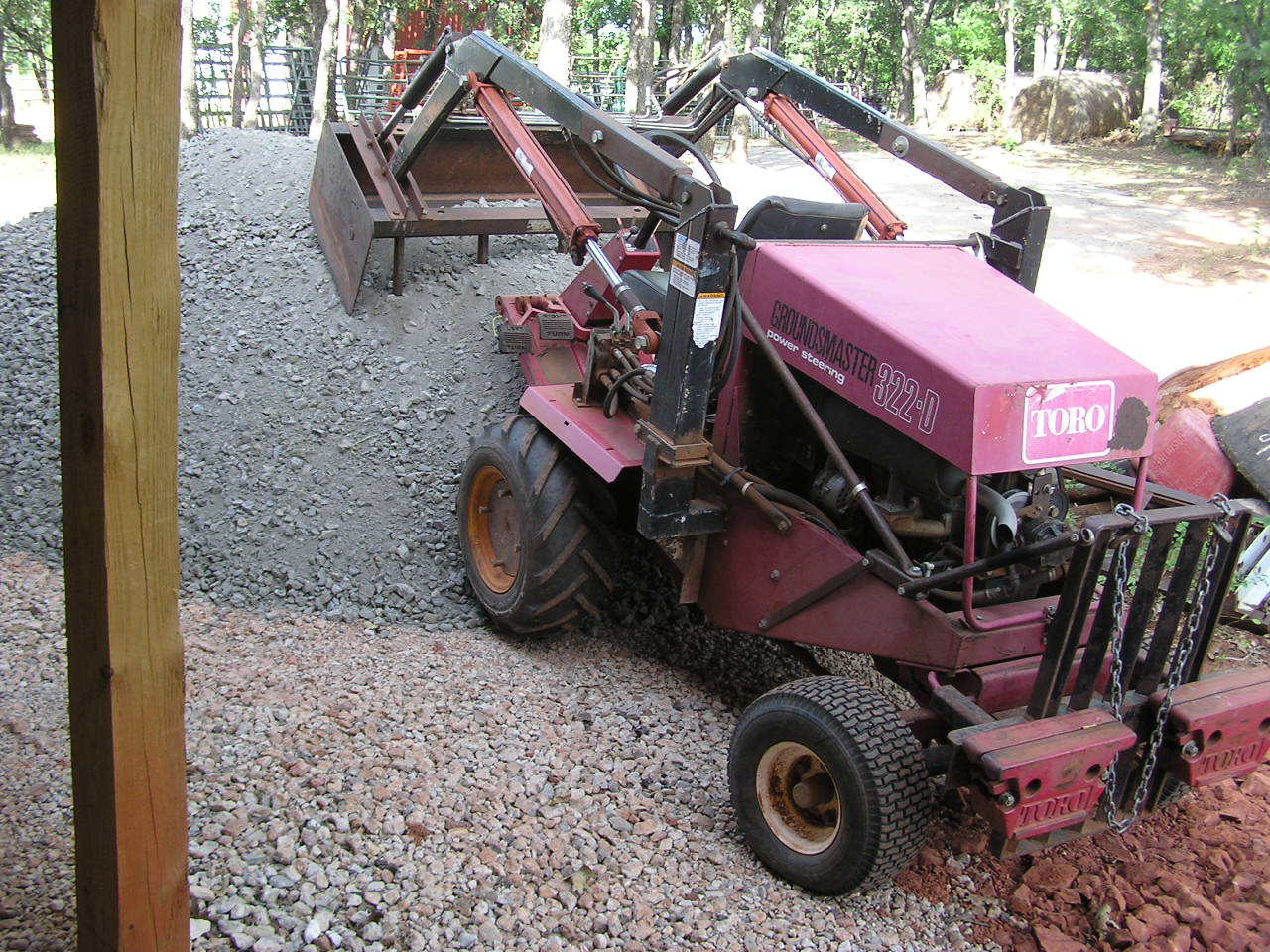

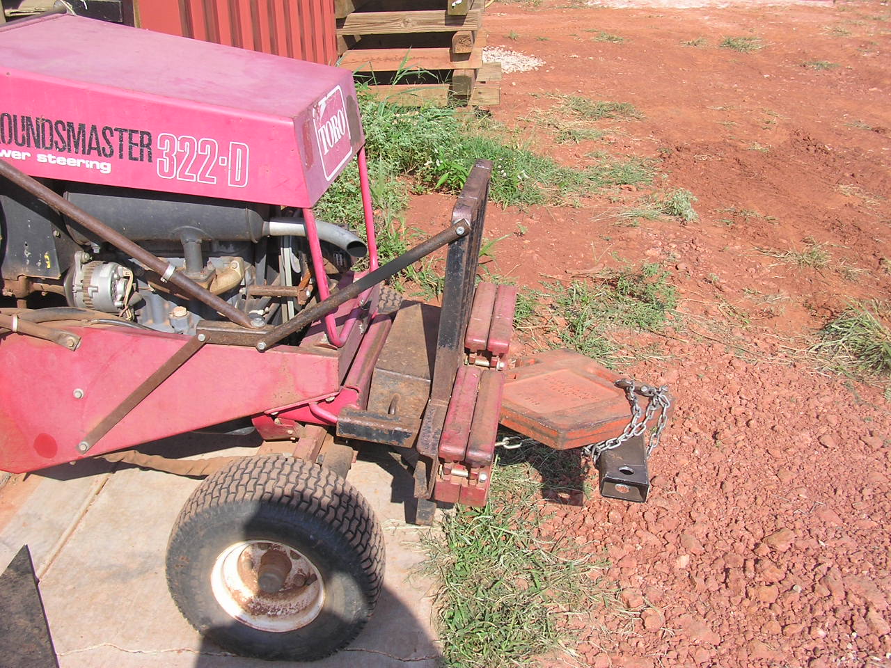

I had to put a smaller pulley on my pump to speed up the loader. It can lift over 800 pounds with 1150 psi.

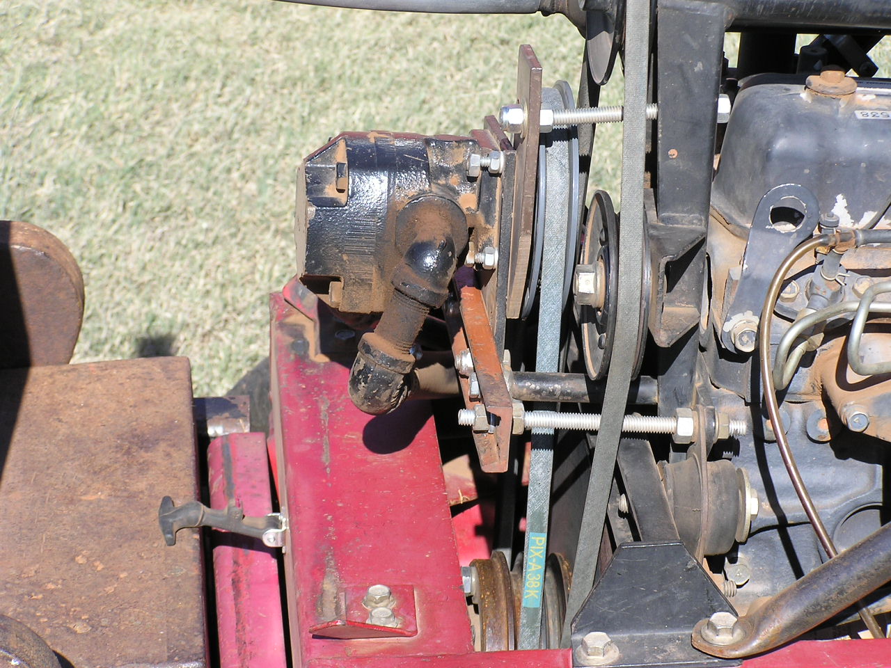

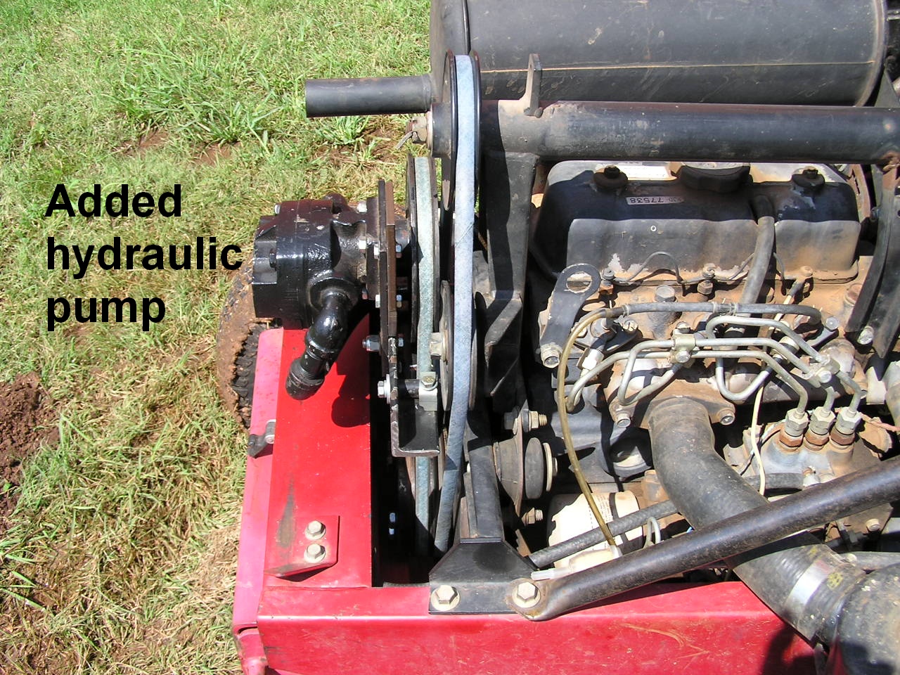

faxman you are correct i finally got to test the pump out and the pressure is fine but the flow is quite slow, are you using a proper hydraulic pump or a vane power steering pump?
It is the hydraulic pump that Kwik-Way used on the loader, made for a garden tractor.
I bought it at an auction 10 years ago.
You should be able to change pulley sizes to speed it up. It was made for much higher rpm's than your mower engine is turning.

finally have the hydraulic gear pump mounted with a pulley reduction drive, this was the only option i could see as the pump has to be turned clockwise.
