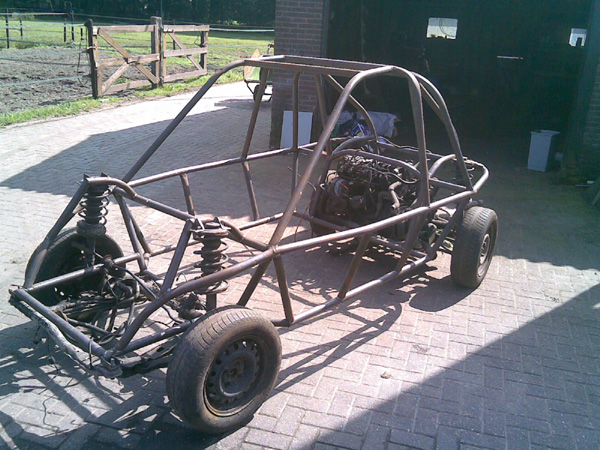

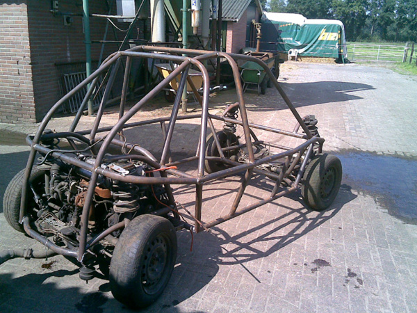

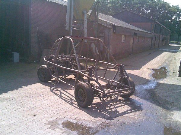

I made some little progress today, but as Neil armstrong said, a small step for men is a giant leap for the project itself ;)
I bent some pipes today and finished the rear frame. I didnt get far enough to get the spring struts in place, but i did get them carrying the buggy with help of two pieces of scrap iron tacked to the frame.
The buggy rolls on its own 4 wheels now !!!
I was able to roll it outside of the workshop, into the bright sun and take some pictures.
Now when it is moving on its own wheels, i am also able to roll it into the corner and get my hay wagon in the workshop. This is just a day of work and i dont want to postpone it untill the buggy is done.
Attached are some pictures, taken in the august sun: They are taken by the same Nokia cellphone as the others, but are a lot brighter and clearer than the previous ones.
Seeing the buggy rolling on its own wheels, is the kind of progress that encourages me to continue on the project with even more effort than before.
As you can see in the pictures, i havent locked the steering on the rear axle yet.

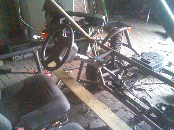

We made a bit of progress today:
I fixated the rear spring struts, and welded the first cross brace into the rear of the roll cage.
I also mounted the steering wheel, which on its own, was a quite simple task, however i had to get it in a position where it wouldnt collide with the pedal tray with brake booster. That took the most time, because the steering shaft needs to stick inbetween the brake and clutch pedal.
Monday i will get some more pipes from work, and weld supports for a floor pan, and also a mid tunnel between the seats, under which the electrics, clutch, brake and gear controls can go. But also to add structural strength in case of a frontal crash.
As you can see, i use an original Volvo steering wheel: People asked me why i didnt go with a fancy sports wheel: The reason is simple. The Volvo wheel is designed to decelerate a human body in a crash. The steering wheel of my friend's Honda CRX was totally bent and the steering column broke off. If the steering wheel and column didnt give, his internal bleedings would have been fatal.

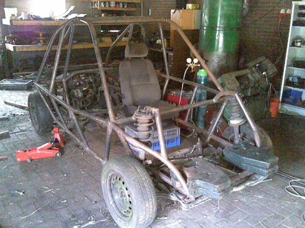

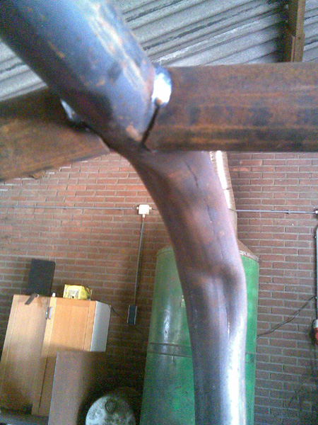

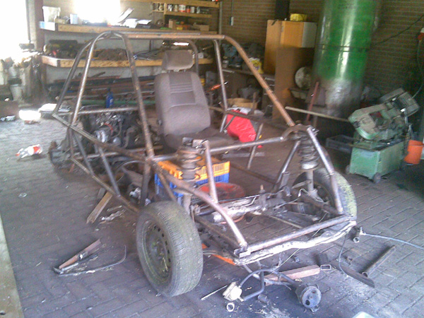

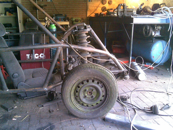

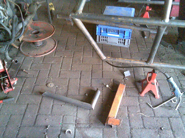

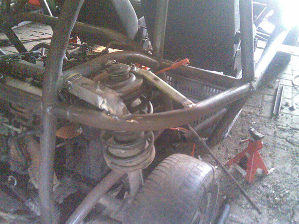

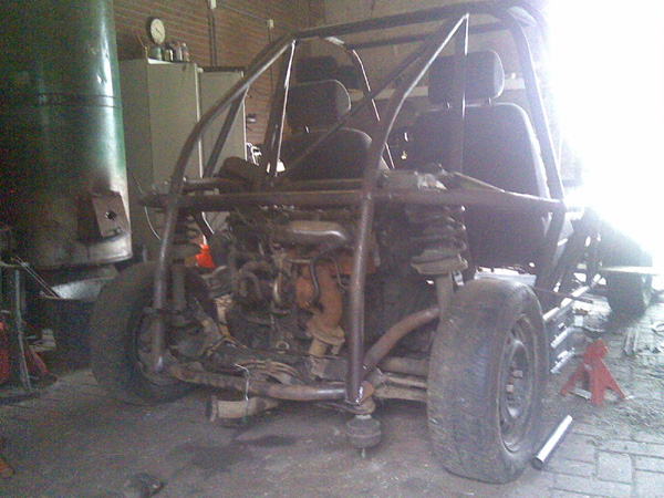

some more pictures taken today with some daylight.
first image shows the steering wheel bolted to a console with some scrap threaded rods.
It needs an extra brace but i need the pedal tray in place before i can determin where it can sit.
second image shows the mounting of the rear spring struts with angle iron. I think this also needs a pipe for bracing.
3rd picture is a rear view, it shows the diagonal pipe in the rear of the passenger cage, as well as the driveline. You can see a rusty turbo there... this one needs to get tweaked for some extra performance, i want at least 110 hp.
I expect the Diesel torque to be beneficial in long hillclimbs. 110 hp isnt as much as commercial VW bus based buggies have, but the torque will do the trick in offroad driving.
4th picture is a side view, i welded the 33mm (1" ??) brace pipes in place, which makes the whole buggy (not just look) a lot stronger.

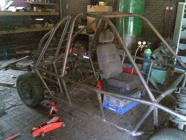

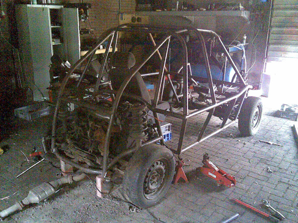

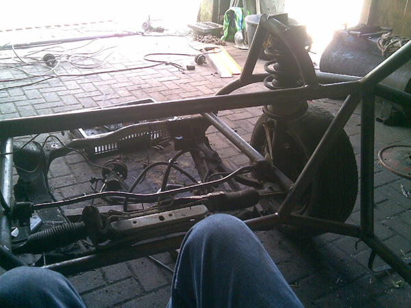

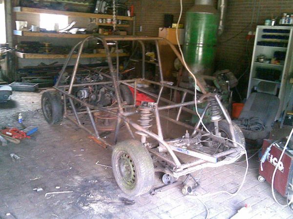

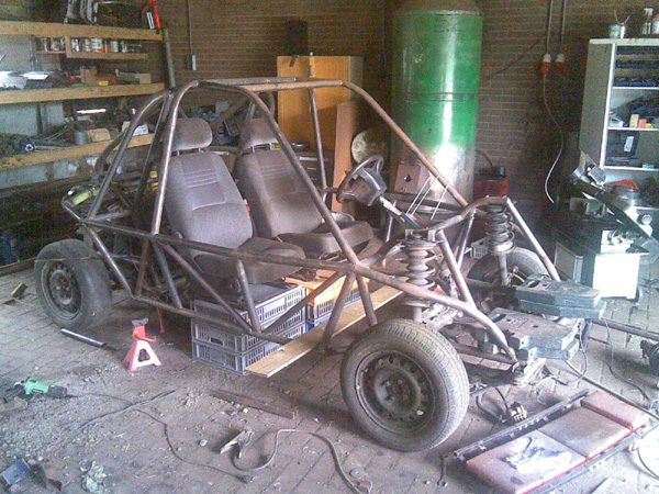

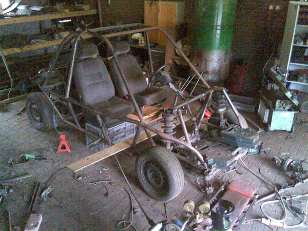

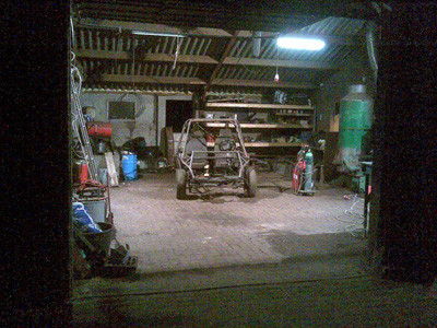

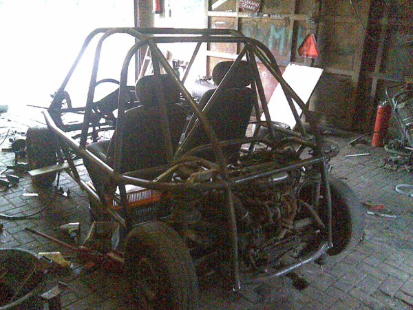

Some photos of yesterday:
photo 1 shows the work so far: seats mounted, and a lot of struts and crossbars added. Now i need to weld some strips against the pipe to bolt the plywood floor to, and i want to make a mid tunnel to mount the gearstick to, and run all the cables underneath.
Photo 2 shows the workshop after i added 2 500 Watt halogen lights: As you can see from previous photos, my workshop was a dark cave. It's amazing how much light 15 Euro worth of Halogen lights can give !!!
I just need to screw them to the roof beams in the highest part, so that they only shine their light down: When i put them to the wall and aim them at 45ー the lamps are still to bright in the edge of your eyes to work properly...

Renze, I'm glad to see your going to have some fun. Not to pour cold water on it but... I think your tube frame will rack and don't you need some triangularization in the corners in the horizontal plane?
Not trying to be spoiler of your fun but I have spent years playing in tube frame rides off road in Baja California, SOCAL, Arizona etc. (Would you believe we even have a little set of desert dunes called Little Sahara hear in Oklahoma.) I have seen an awful lot of frame failures in home brew rigs and not nearly all of them were welding problems. They were design problems. If you can get your hands on a copy of "Sand Sports" or a similar magazine you could see many examples of tube frame off road fun cars. Here is their URL:
Welcome to Sand Sports Magazine Online<meta name="keywords" content="Motorcycles,rails,sand,sand sports magazine,engine,tools,wheelie,speed, quad,atc,atv,offroad,offroading,jeep,dirt,vacation"> <meta name="description" content="Sand Sports Magazine preveiws and sales information">
All I have left these days is an air cooled '62 VW bug with wheel base shortened 14 inches and the body replaced with fiber glass beach buggy (Myers Manx style) It has a full roll cage over the people and another over the engine. Never rolled it so far but it should roll like a scarab hauling manure with all the overhead protection.
I haven't got a lot of engine work in this one so it doesn't wheelie. Fuel cell is in front, batt amidships. I have put some creature comforts on it since moving to Oklahoma. I have a removable surrey top for sun protection. It attaches to the roll cage. I have removable cloth doors with plastic view ports and snap in place curtain around the back. IT doesn't rain into the car much unless you drive fast or the wind blows hard. It is street legal and lisc for the street but IT is mostly used off road. It is good for running the sandy areas beside the local rivers when they are not in flood stage. I catch a little air once in a while on my land but try not to break it too much. So far I have had no major crashes with it but did have a rear axle break and fall off while towing it through Dallas Ft Worth area on its own wheels. Apparently the axle was cracked from my previous antics and just chose that time to finish cracking and fall off.
Back to your project:
An in-line style electric lift (fuel) pump is only a few bucks so getting the tank out front for helping with the CG should be dead easy. It isn't that your fuel tank is really heavy but when you take it off the back and put it in the front it helps nearly double. If you put the radiator out front and use an electric fan in addition to moving the fuel tank you will probably not have to move the seats to get a decent CG.
Best of luck, keep showing pix and HAVE FUN!
Pat
