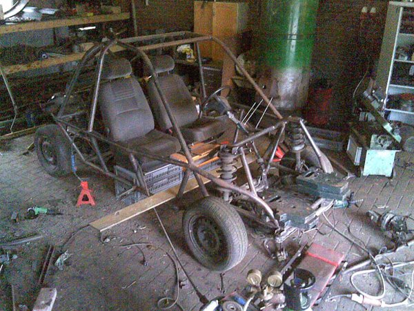

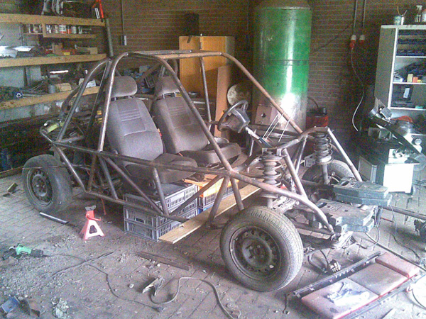

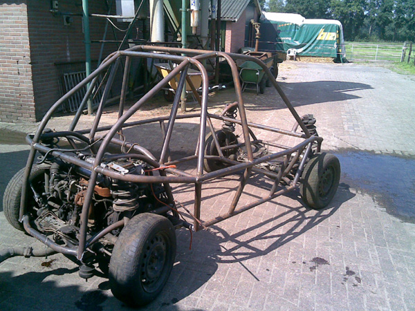

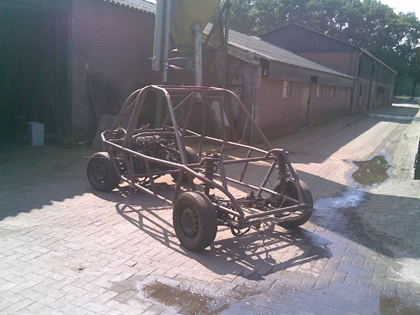

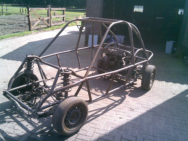

I need some ideas now:
last week i sawed some floor boards, and fabricated a piece of firewall to match the original mounting of the pedal tray.
I hung the radiator and battery in the front, just for mockup.
Now i need radiator hoses: i used garden hose once, to replace a cracked cab heater hose in the cab of our 5245. That didnt last long as it couldnt handle the temperature.
The engine is a cast iron block with aluminium heads: Which means i need the original all steel radiator, and an old, higher capacity, all copper Zetor radiator wouldnt work, as Galvanic corrosion would occur between the copper and the aluminium.
Anyways, what will work for water pipes ? Galvanised pipes will propably smudge their zinc coat all over the internals of the aluminium head, which may cause a heat exchange problem between the head and the water.
Stainless pipes are too expensive.
Will standard steel pipes work ? The block is iron too, so i dont expect any funny reactions in the Galvanic chain...
Can i just use steel pipes, or are cast iron blocks treated in any way to prevent rust, that standard steel pipes dont have ?
Or does cooling liquid have a chemical additive to stop internal corrosion ?

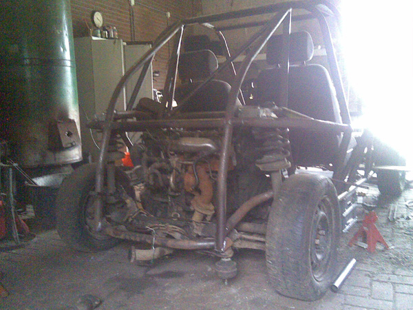

I know about the sacrifical anode used on boats (did anyone know that the sister ship of the Titanic lost its brass screw because of galvanic corrosion ??) but its not really the way i want to go... the zinc anode will spread itself through the cooling system.
Anyway, my problem is solved: My friend works at a big trucking and logistics company. He got 6 meters of rubber hose from their workshop, for free !
This way we only have to add non-conducting material to the cooling system.

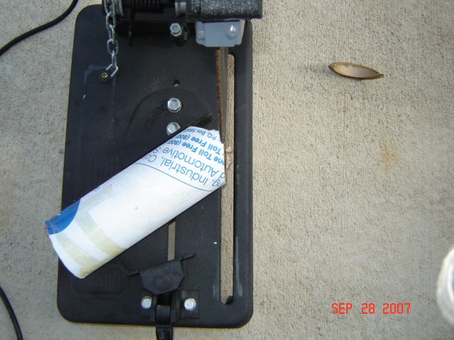

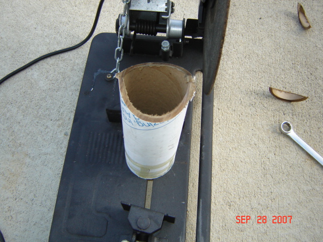

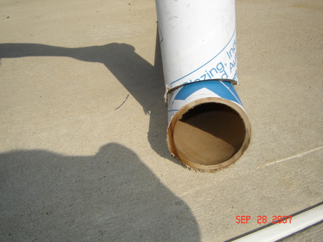

How to fishmouth a tube with a chop saw:
To make a 90 degree tube to tube fishmouth set your chop saw around 35-40 degrees. Align the end of the tube so your cut ends at, or just shy of, the center of the tube, & cut. Rotate your tube 180 degrees, align so the end of the cut is again at, or just shy of, the end of the tube, & cut (see pic #1). This will give you the rough fishmouth (see pic #2). Some minor grinding of the inside of the "points" may be necessary for a tighter fit. When finished, your tubes should fit together as shown in pic #3.
To make a fishmouth at other than a 90 degree angle, the inside angle will need to be increased & outside angle decreased.
Note: A 4" shipping tube was used for illustrative purposes.
