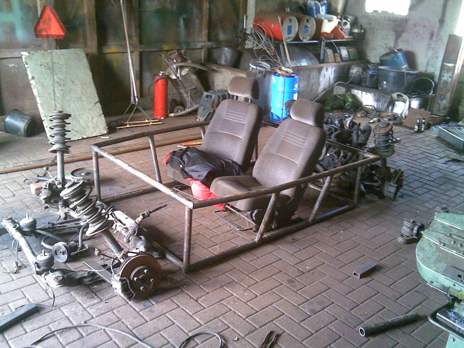

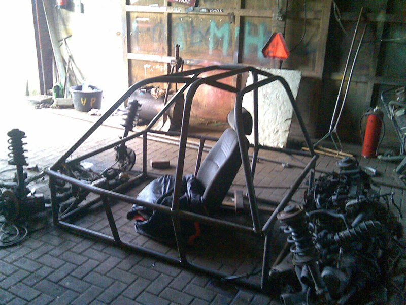

photo 1:
I spent about an hour walkign around, not knowing where to start, as i normally build trailers (built around 2 hot rolled steel frame beams) instead of buggies with an open cage construction.
Then i decided to start with the parts that allowed the most design freedom, which is the passenger cage, and later add the parts to mount both Volvo subframes, so i could better visualise where all the supports for the subframe mountings and spring mounts would go.
It turned out to be a good method, because within an hour or 2, i had what can be seen in photo 1.

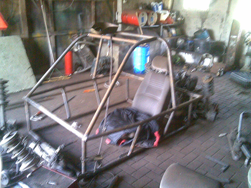

photo 2:
I used the hydraulic pipe bender to bend a roll bar over the spot where the seats would go. Unfortunately i had only 1 pipe die, which was for a 1" pipe, not for 1,5" so i pressed the pipe oval in the bend. To reduce the effect of making the pipe oval, i bent it in 3 or 4 places to make just 1 bend.
photo 3:
an extra hoop is added to the rollbar, and some pipes from the front part of the passenger cage to the rollbar are added.

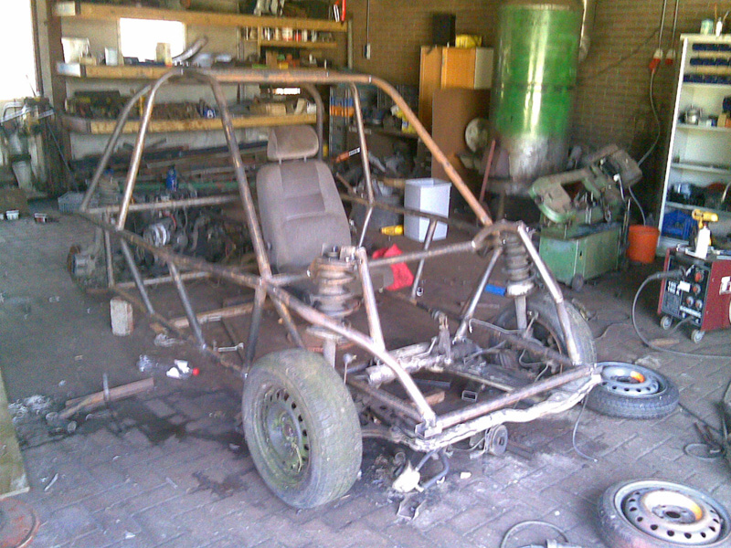

photo 4:
I've built the mounts for the front subframe, with steering housing. I had to bend the front quite a bit to work around the springs. I also had to chamfer off the front part of the passenger cage, because the front wheels couldnt sit there because they hit the lower front tube.
When i bolted some wheels on it, it really started to appeal.

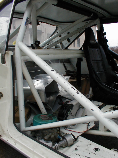

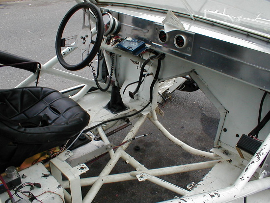

So far, it looks good. Only thing I can add to your basic structure is to remind you that TRIANGLES are strong, boxes are not. Small triangles are stronger than large triangles. It is stronger to pull a tube than push a tube, but your weld is more stressed in tension than compression, plus it's usually not feasible given things like ground clearance. If force pushes a tube (for instance the upper spring mounts) have tubes direct that force into the main structure. See attached pics for examples of triangles transmitting force to main structure (main hoop of roll bar).
"Ideal" weight distribution would be 50/50 given your short wheel base & intended use.

Renze, do you have a chop saw? Making a "fish-mouth" (to fit end of tube to side of tube) can be fast or slow, very precise or "close enough" depending on the result you want. When I worked in the fab shop I used a hole saw in an old milling machine to make fish-mouths if I wanted them tight. There are cutting jigs available (around $100-$200 USD) available that also use a hole saw. I have, after very little trial & error, learned to make reasonably tight fish-mouths with a chop saw & 4" or 4.5" (roughly 100 or 120mm) grinder. Once you figure it out, it should only take a couple minutes with the chop saw & grinder method. It's nearly impossible to use words to tell how to do it, but if you're interested I can take & post a few pictures showing how it's done. I built such roll bars from 1986 - 2000, so I know a thing or two about it. The car above I built for a friend. He's been drag racing it for almost 20 years now. It's heavy, at 2900 lbs (around 1400 kilos) but is over-built (safe!), fast, & consistent (9.0-9.1 seconds in the quarter mile at 148-149 MPH). Attached are a couple pics taken 2 years ago, above post pics were taken about 7 years ago.

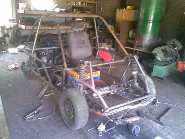

A photo from the drivers seat, you can see the Volvo subframe with a power steering rack and pinion housing, a powersteering pump on the ground, still connected with the hoses to prevent dirt from entering the system.
You can also see how the spring struts are connected to the frame. I need to put a connecting bridge inbetween them and solidify it by making angles.
The spring struts themself are bolted with 2 M8 bolts onto 2 angle irons.
I sawed a hole into the angle iron and then chopped off the angle iron in half with the band saw, so the result is 2 angle irons with a half radius.

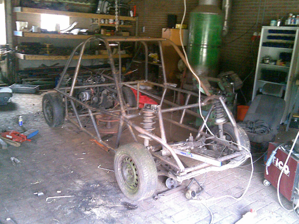

photo 3 shows an overview picture of the buggy, front part on wheels, rear end on 2 bricks.
the original Volvo seat is placed on 3 plastic butcher's crates, at about the correct seat height.
When sitting in the seat, i dont know how it will feel, i gues topping 200 km/h with this thing will be a bit more scary than when i did it with the car this motor comes from....
Anyways, i dont need to go that fast, when the cops try to catch me in the bush, i will quickly disappear out of sight and then be unfindable because i know the local forest better than any copper.. :D

Only thing that scares me is the bends you made with the wrong size shoes (VERY noticeable in your last pics). The kinks in the bend WILL be your weak point & WILL fold. A large X in the main hoop would be my first suggestion, but gussets at a 45° angle with 1-1/4" tube under those bends would be better than nothing. I would hate to hear that you put it on it's side & the cage folded over on you!
Your ties from the front to the main cage look good! Should allow some movement, plus in a hard hit should fold without too much distortion of the main cage.

A great thread and neat pics. I do have a concern about your battery placement. How do you intend to contain the acid if the battery gets ruptured?

dbdartman, yes i took that photo to illustrate the fishmouthing of the pipes, AND the deformation of the pipe in the bend, however i didnt mention it in the description.
I could correct the leg-to-leg distance of the rollbar by simply putting one end under my workbench and putting my 70 kg of body weight on it... I know that aint good, but i will at least weld 2 X-es into the structure: 1 directly behind the passenger cage, and one in the rear structure (i havent built that yet) that will run from the rear subframe mounts to the upper part of the rollcage. then i can extend the rigidity further forward by adding some crossbars in the`roof`
The ovaled pipes arent ideal, but i dont worry that much about them, sometimes, something turns "right" by going left 3 times ;)
