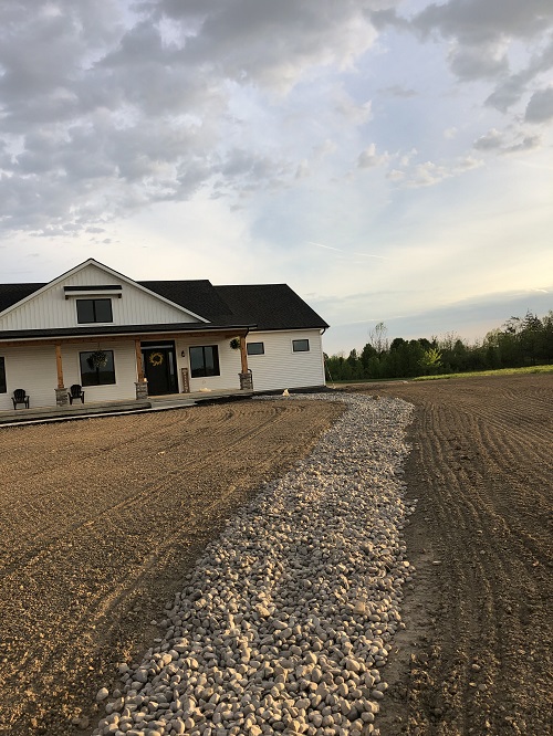

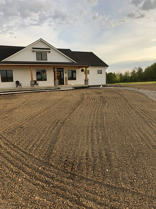

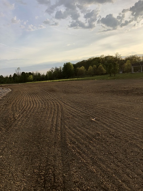

I had several posts about the best methods for yard prep before seeding, seeding, and then to cover or not to cover. In any case I picked up a used 6' Land Pride Pulverizer. Back history, we built two homes on an 11 acre lot this past year. My in-laws live on one side and are there part time between here and California. So, in early April I was able to get some practice in on their yard using the same method. Their grass came up nicely in about 2-3 weeks. It was very rainy and cool, so it took a little longer.
It has been so wet this spring that I have not been able to get mine done. Yesterday, it was just dry enough. I spent about an hour going over it to get the level, powdery, but firm consistency needed for a seed bed. I fertilized it with a starter fertilizer, and hit it heavy with a Kentucky 31 Fescue/Bluegrass mix. I then went over the entire area again with the pulverizer which covered the seed, and also packed it again. Pics below. It rained about an hour after I finished. It rained fairly heavy, but there was no washout this morning, and the seed was still just under the surface where I left it. Looking forward to the results. Forecast is cool and fairly rainy for the next week.

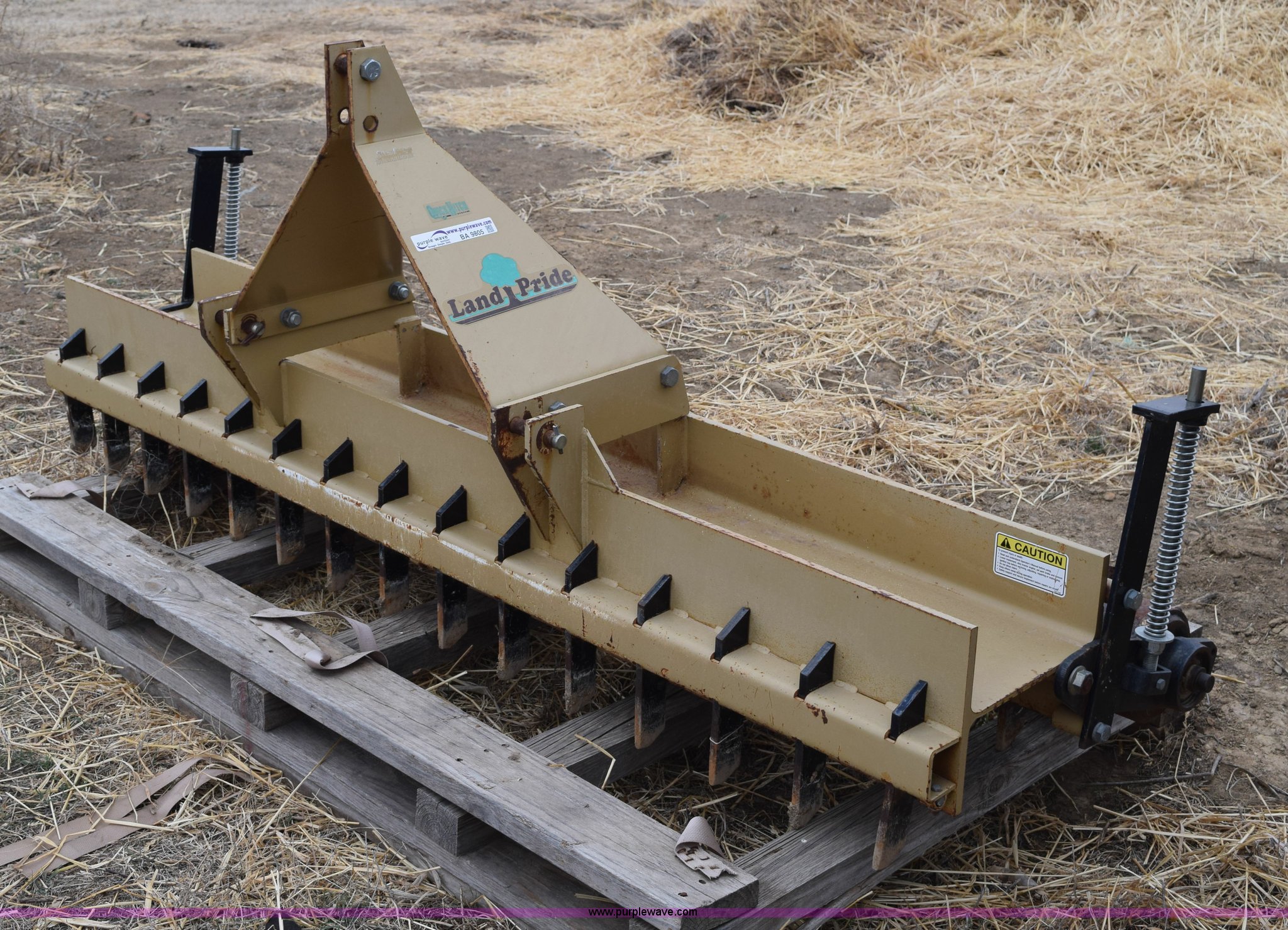

I don't know what a pulverizer is. Do you have any pics?

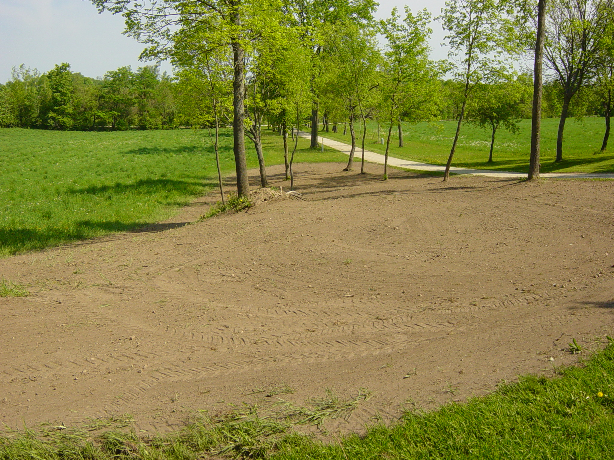

You might want to go over it with a roller. Those little grooves don't look deep now but wait till you start mowing. It will ride like a washboard. I went over some of my land with a landscape rake and it looked very similar. I have to mow with the grooves or it beats me to death.
/ Yard Prepped and Seeded - Just Before the Rain #11
And the wrong rain will bury the seeds in the valleys, leaving strips of grass growing. That takes a couple years to go away.
/ Yard Prepped and Seeded - Just Before the Rain #12
Agreed, I finished my yard with a spike harrow and it took many years for mother nature to smooth it out.
/ Yard Prepped and Seeded - Just Before the Rain #13
I suppose it depends on the soil, but I had a different experience. While I agree that flatter and rolled is always better, I have prepped areas that looked like the OP's at the end of my prepping. One year later flat as a pancake and all areas filled in with grass.
As always, one can't let perfect be the enemy of good enough.

After the rain we just received on Friday, and again on Sunday the lines you saw in my pictures have vanished for the most part. With temps in the high 70's and low 80's this week with rain every other day, I am hoping to get some germination soon.
I've decided to wait until Fall to seed my new build area. I wasn't ready early enough. Afraid if we get another mid Summer drought it would all die.
Looks just like this but a 72''
/ Yard Prepped and Seeded - Just Before the Rain #17
I've never saw one being used or in person. But now I remember having saw a pic of one like the one you posted.
Does the soil need to be pretty dry??
