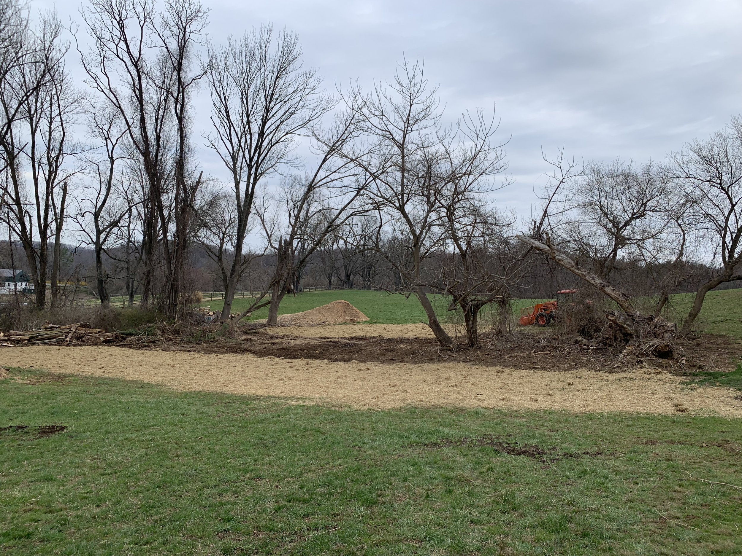

I'm new to my 47hp tractor, got about 15 hours on it this winter/spring. Working well. There is an acre or so of my land this Spring i'll need to seed. Right now it's getting leveling by bulldozer, and black dirt of being saved for me to put on top for grass. Working with my bucket, I just don't have the skill to get that dirt even close enough to level and ready for seed....

...Right now it's getting leveling by bulldozer, and black dirt of being saved for me to put on top for grass. Working with my bucket, I just don't have the skill to get that dirt even close enough to level and ready for seed. ...
1) use my tractor's bucket to dump the dirt around (result wont be flat but each bucket i can slowly dump just while reversing). My guess is about 100 yards to spread.
2) come by next with a landscape drag or here is slightly different model. I can pull this with my tractor or even my 18hp craftsman lawn tractor. With concrete blocks for extra weight, reviews tell me this implement works wondering on leveling.
3) finally, a chain-link harrow drag, throw the grass seed down, the hit it one more time to cover the seed.
Suggestions?
The OP needs to spread and level 100 yards of topsoil. Once it's level, he has a tiller. A drag, chain link fence , gate, etc. is the easy part. The OP is trying to get it level enough tp drag. I agree that a Harley rake would be a tool of choice. A box blade and landscape rake with guide wheels would be a good plan B.
