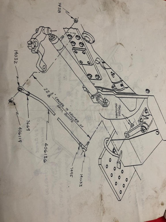

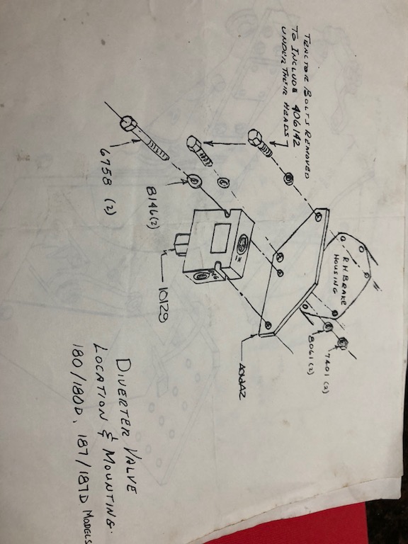

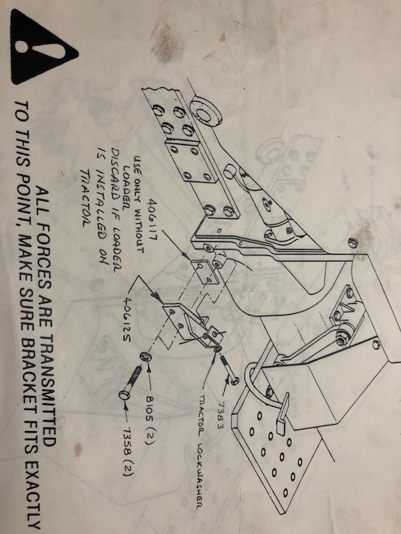

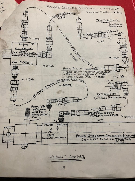

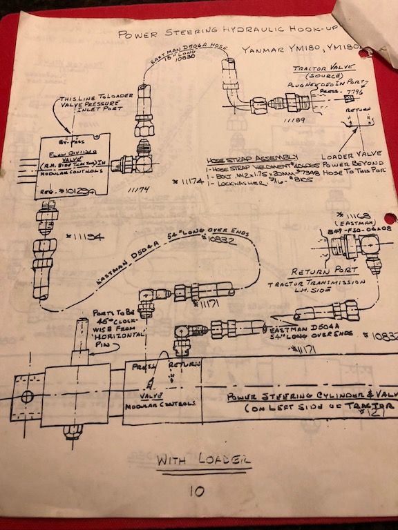

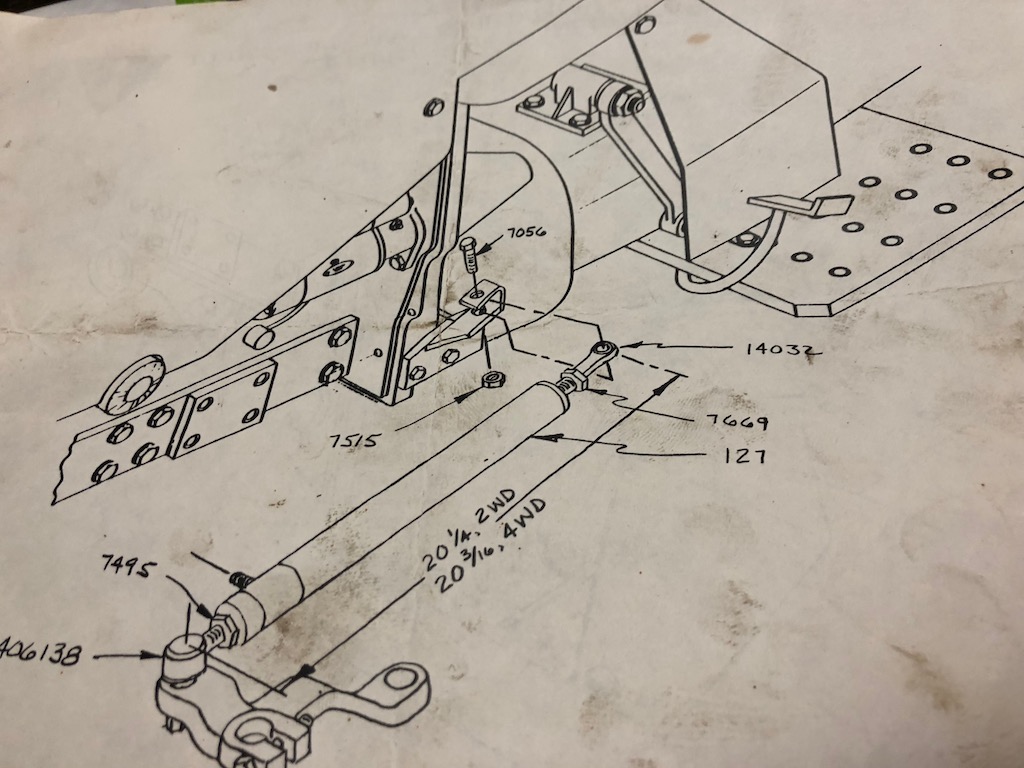

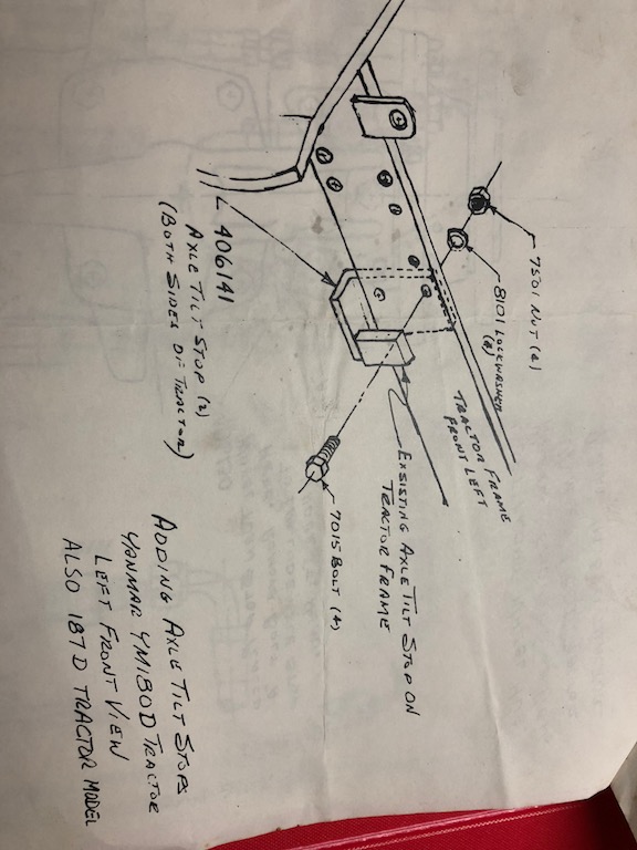

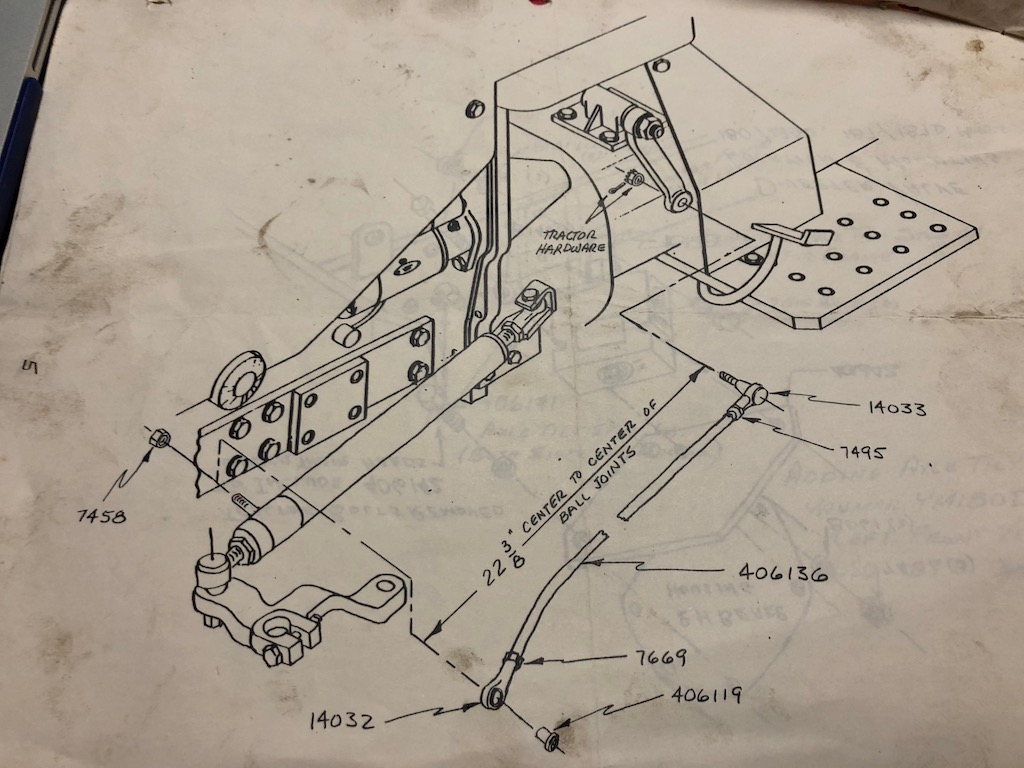

My 187d was equipped with the factory optional power steering kit. Owner worked for a dealer and so I have the factory installation instructions as well. At some point in tractors life cylinder must have leaked and it was removed and hoses bypassed. Recently Hoye started selling a kit and the cylinder/valve separately. I got just the cylinder/valve. Valve is about mid way down the cylinder unlike factory n which was at the far end. Other than shortening the pushrod from the factory steering kit and drilling one hole larger on the frame bracket it worked. For anyone wanting info let me know . (FYI their website says it has 3/4 “ hole and flare fittings. Mine showed up with 18mm and SAE.

Mark, thanks for taking the time to post those photos of Yanmar's optional power steering installation. I've always been curious about the history and continuing adventures of Yanmar's power steering.
BTW, the artwork in those pictures is really exceptional; they are an inspiration.

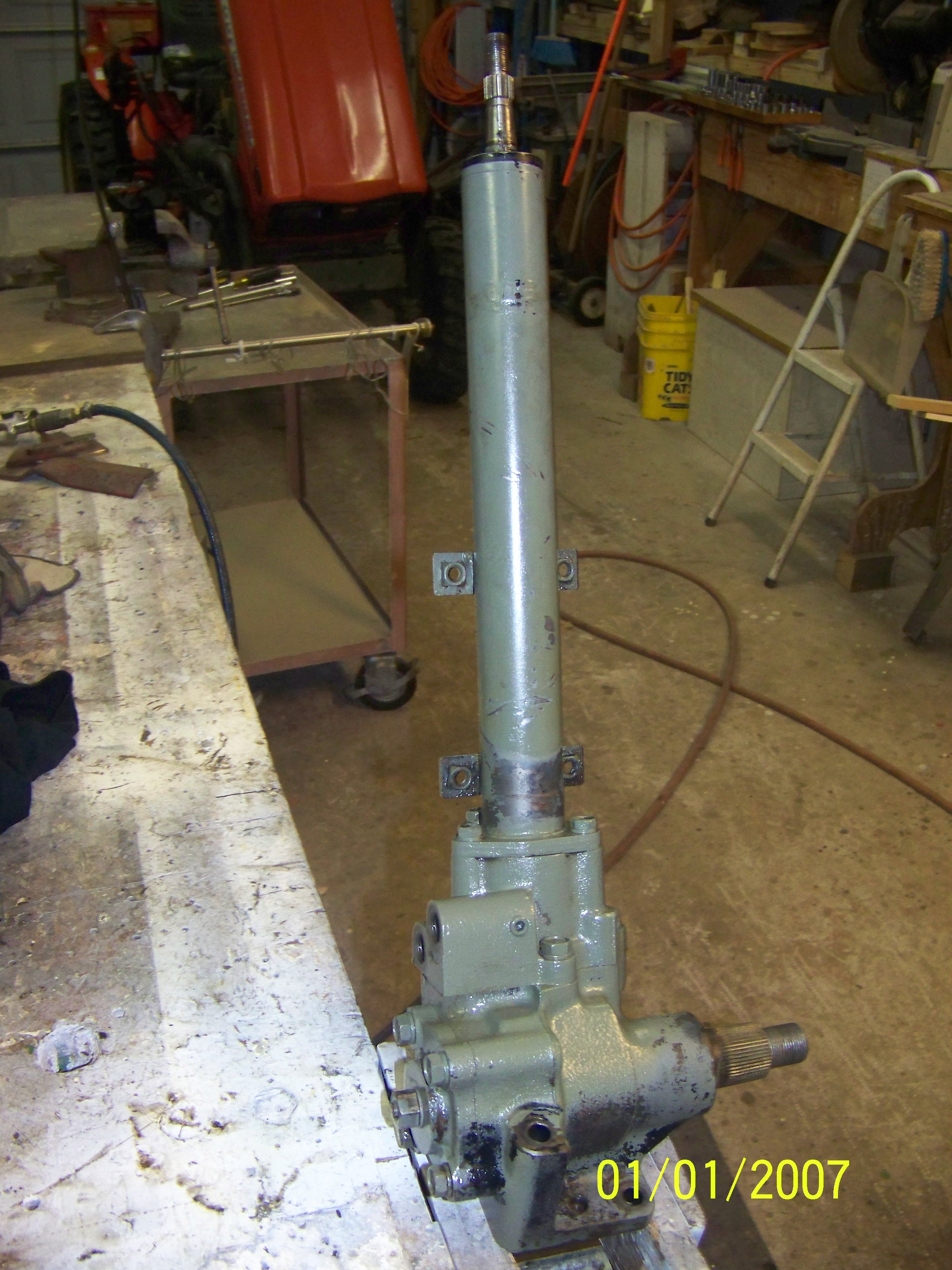

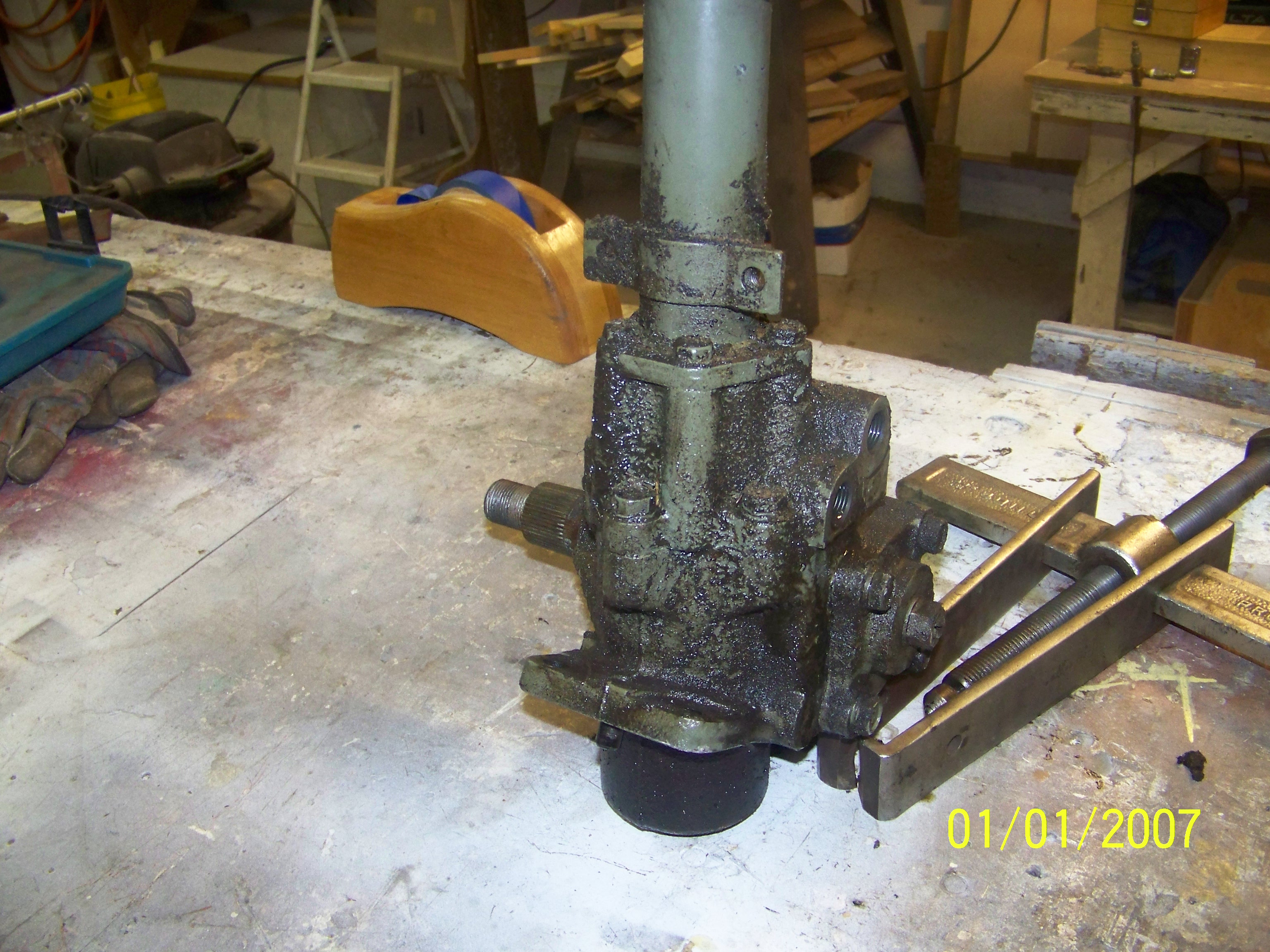

Just for thought. I consider those power assist and no doubt Yanmar installed. However, the steering wheel unit is what I really call factory power steering. Don't think any American sold had these but numerous greys did.

The US model YM336 used almost the exact same steering column system for power steering.

My 187d was equipped with the factory optional power steering kit. Owner worked for a dealer and so I have the factory installation instructions as well. At some point in tractors life cylinder must have leaked and it was removed and hoses bypassed. Recently Hoye started selling a kit and the cylinder/valve separately. I got just the cylinder/valve. Valve is about mid way down the cylinder unlike factory n which was at the far end. Other than shortening the pushrod from the factory steering kit and drilling one hole larger on the frame bracket it worked. For anyone wanting info let me know . (FYI their website says it has 3/4 hole and flare fittings. Mine showed up with 18mm and SAE.
Interesting. You have the later system built by DuPro, see Gjamtrac's description of the difference, above.
It seems the Modular Controls version with the little control cylinder on top of the primary cylinder is what is on most YM186's, then around the time YM186 was superceded by YM187/YM180, the dealers started using the DuPro kit.
The Modular Controls owner/service manual has been posted here previously but your post of the DuPro manual is the first time that manual has been seen here - I think. Thanks!
