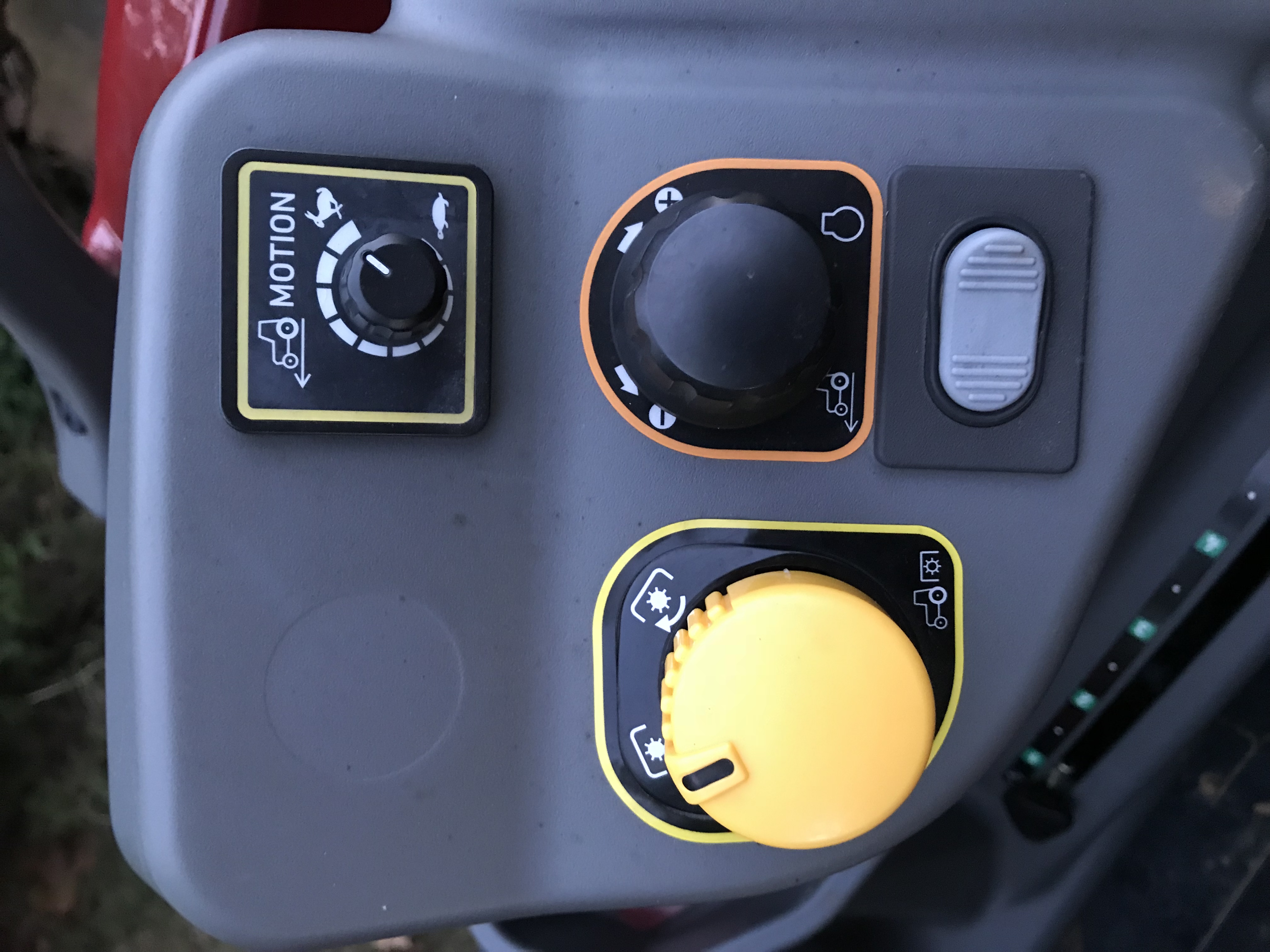

How quickly can you actually change direction? With 2-pedal or even rocker-pedal hydro, you can change instantly... No lag. I remember a complaint with the NH CVT machines was a lag between actual directional changes
/ Yanmar YT359C #36
It is instantaneous or gradual all adjusted by a knob on the fender.
Top motion knob is reverse lag. Sometimes you want fast - other times slow.
Bottom knob is cruise. You can set it for ground speed or engine rpm.
Yellow is PTO engagement
/ Yanmar YT359C #37
Thanks.
What's the blank circle cut-out for? Is there another option available?

I ran some trials on hills and really did not notice any roll beyond the amount allowed with the motion knob. I feel very confident as I reverse either direction that it does what I intend.
