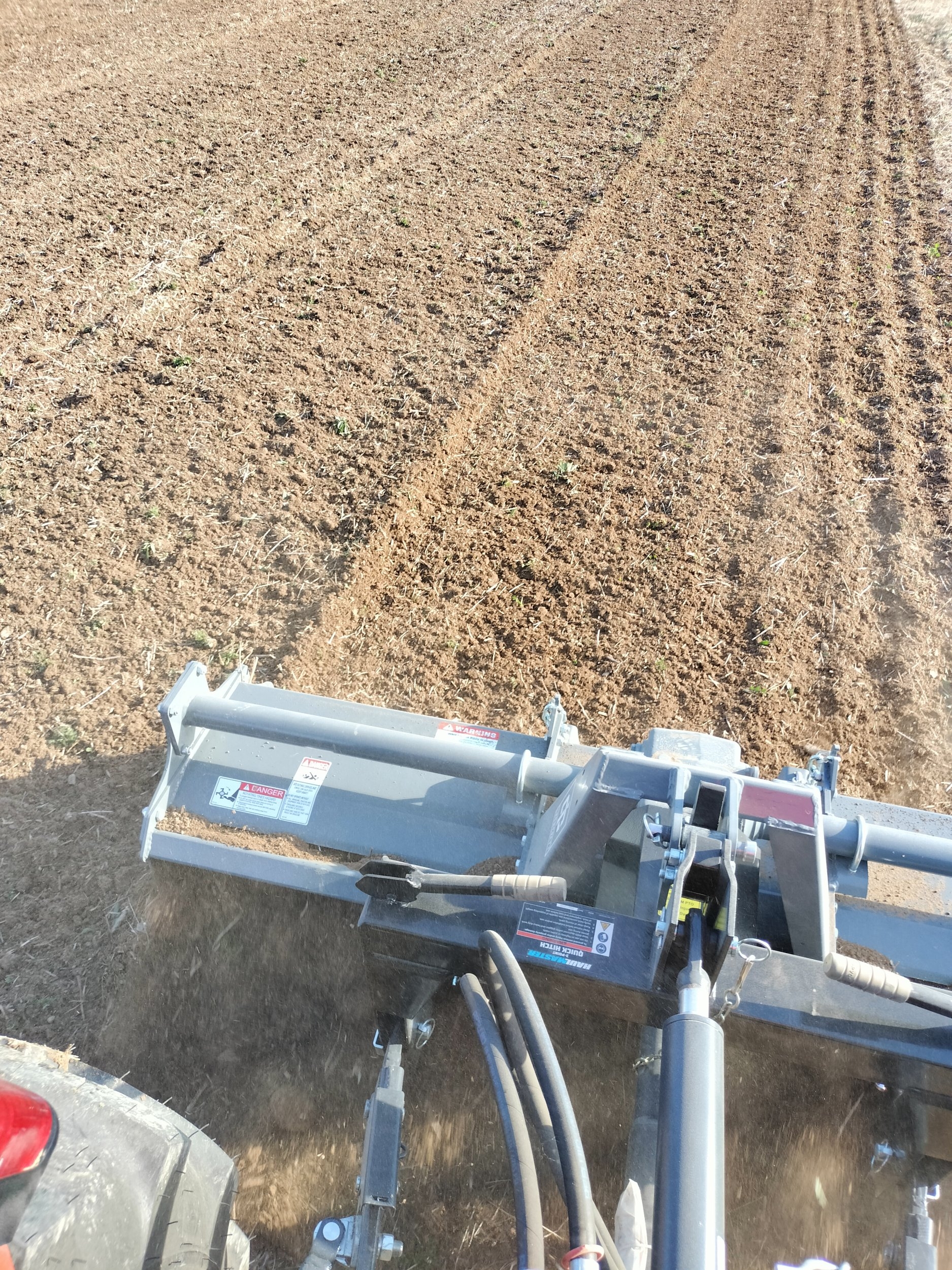

/ YT359c top link! #19
Hi Desertsasquach,
I would appreciate knowing what you decided on as I am a bit new to this and want to get a top n tilt for an open station YT359. I don't know what the "next longer length" item would be when looking at the top kits. Also would like to know what restrictors I would need. Just learning about this, so a little confused.
You would be better off with 2 1/2" dia cylinders and 1 1/2" dia rods IMO.
That is what I recommend for your model, similar to those pictured.
If you are not using Pat's quick hitch, then you want something with a working length close to 20"-29" for a top link.
Side link should be built to provide an equal amount of tilt angle to both sides using a 5" stroke cylinder.
You can get a quote here if you like.
