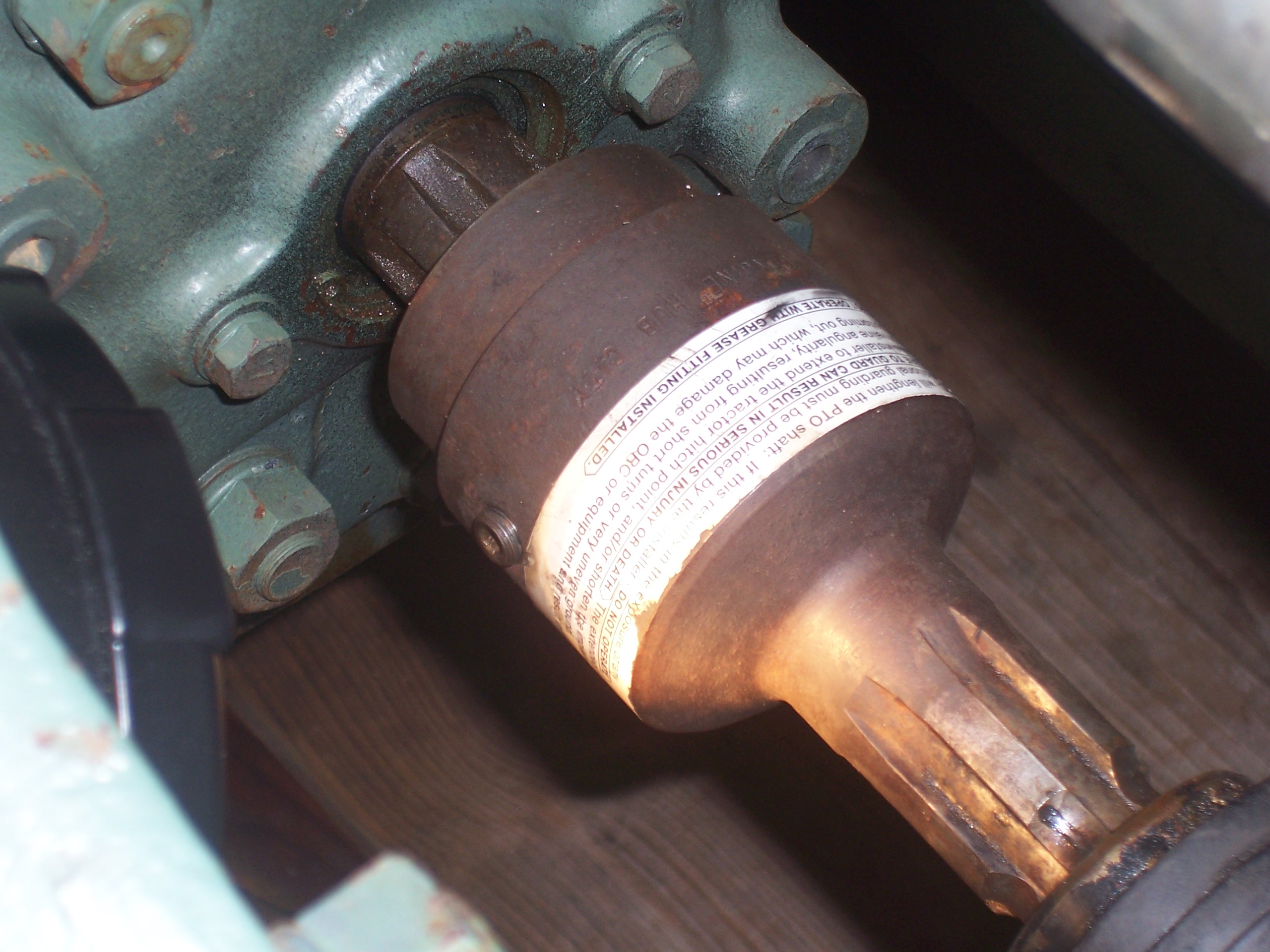

If it's has the same Overun clutch as I do there is a ( PIN) still in the shaft. The same length as the inner portion of the overun clutch so the outer part will spin around it.Look hard at the pic and you can see the O/C that is attached to the shaft and guessing it's the same. I bought my Ym 2000 as is also an now that I have it in good working condition I've started to work on the cosmetics. Just using spray paint that Hoye has also it's starting to look pretty good.

It looks the same as far as I can tell. I guess I will leave it on, but I do want to know how to get it off. Your cosmetics look terrific Carey. What do you do to prepare the parts before you spray em? Any sanding or priming?

Like others said thats the oerrun clutch. you will have to push the release button on the drive shaft, thats kind of under the colar. To remove the overrun clutch with the shaft still connected (what you were trying to do) you will have to drive that roll pin out.

No, I left it on there for the time being. I do not understand how to get the O/C off and havent had time to get a good look at it yet but will get on it when i get back in town. I guess there is a release of some kind under the collar?
/ Yanmar YM1700 #31
I'm guessing this is what you have. If so Your going to need a alan wrench to remove the alan /screw cap and remove the Grease Fitting/Zerk. After you remove that use a 1/4 Drill Bit and line up the outer holes to the Roll Pin or the inner part of the O/C. It goes through the PTO shaft. Use the drill bit to tap the Roll Pin through the outer part of the O/C. Pull it out and it should slide right off ;) Here a better pic and the alan cap the Grease zerk is already off on the other side

Yep, thats what I got. Ok so I will take out both the allen screw and the grease fitting and then drive out the roll pin that is inside the O/C until it comes through the outside of the O/C. I think I understand.
/ Yanmar YM1700 #33
Good wasn't a waste of time ;) You should only have to remove 2 either 2 alan or 1 of each which ever ones are directly across from each other so your punch can go in one and the pin comes out the other. It can be a PITA. getting them lined up so do yourself a big favor and clean it up good so you can see the holes next time ;)

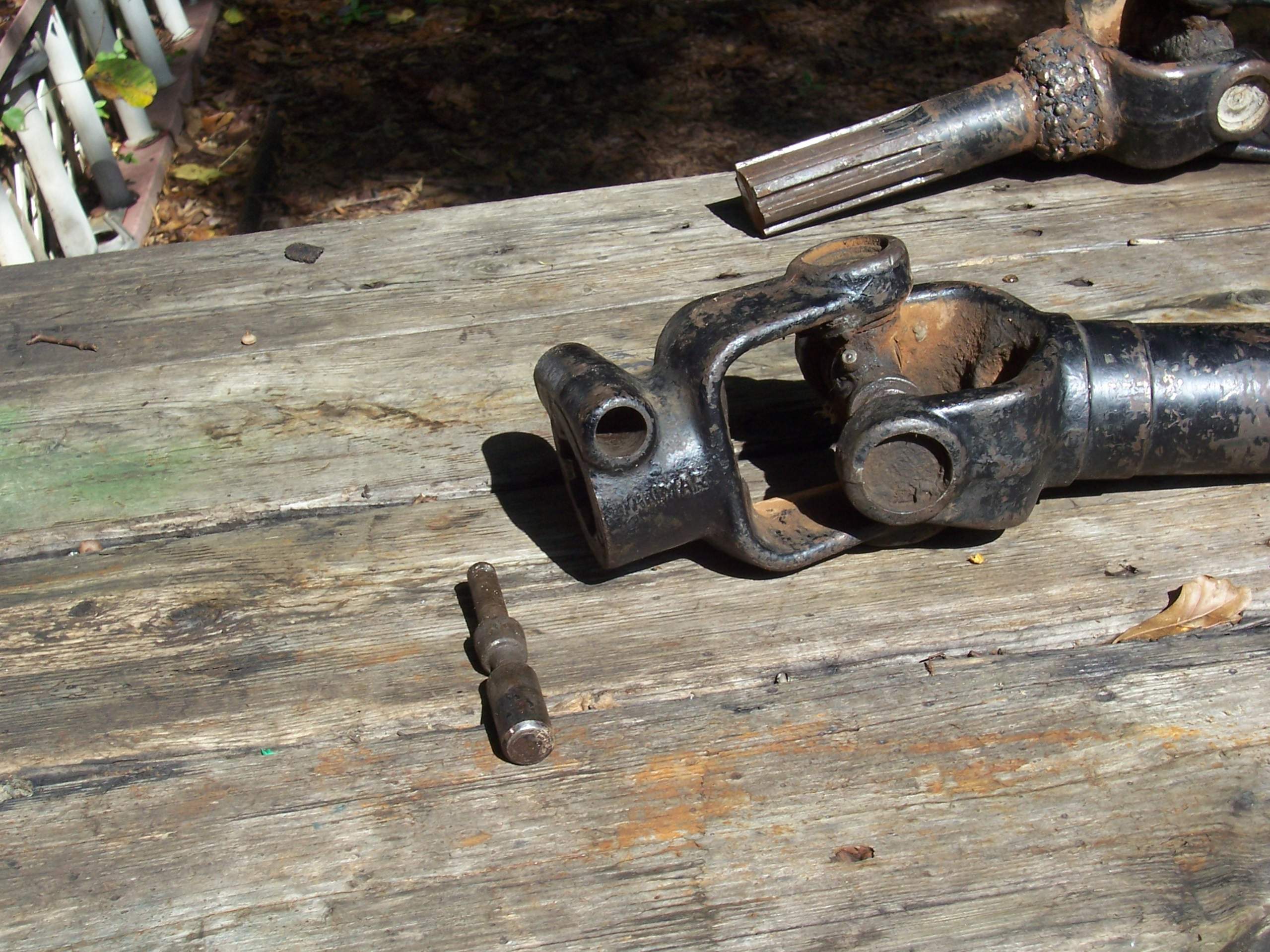

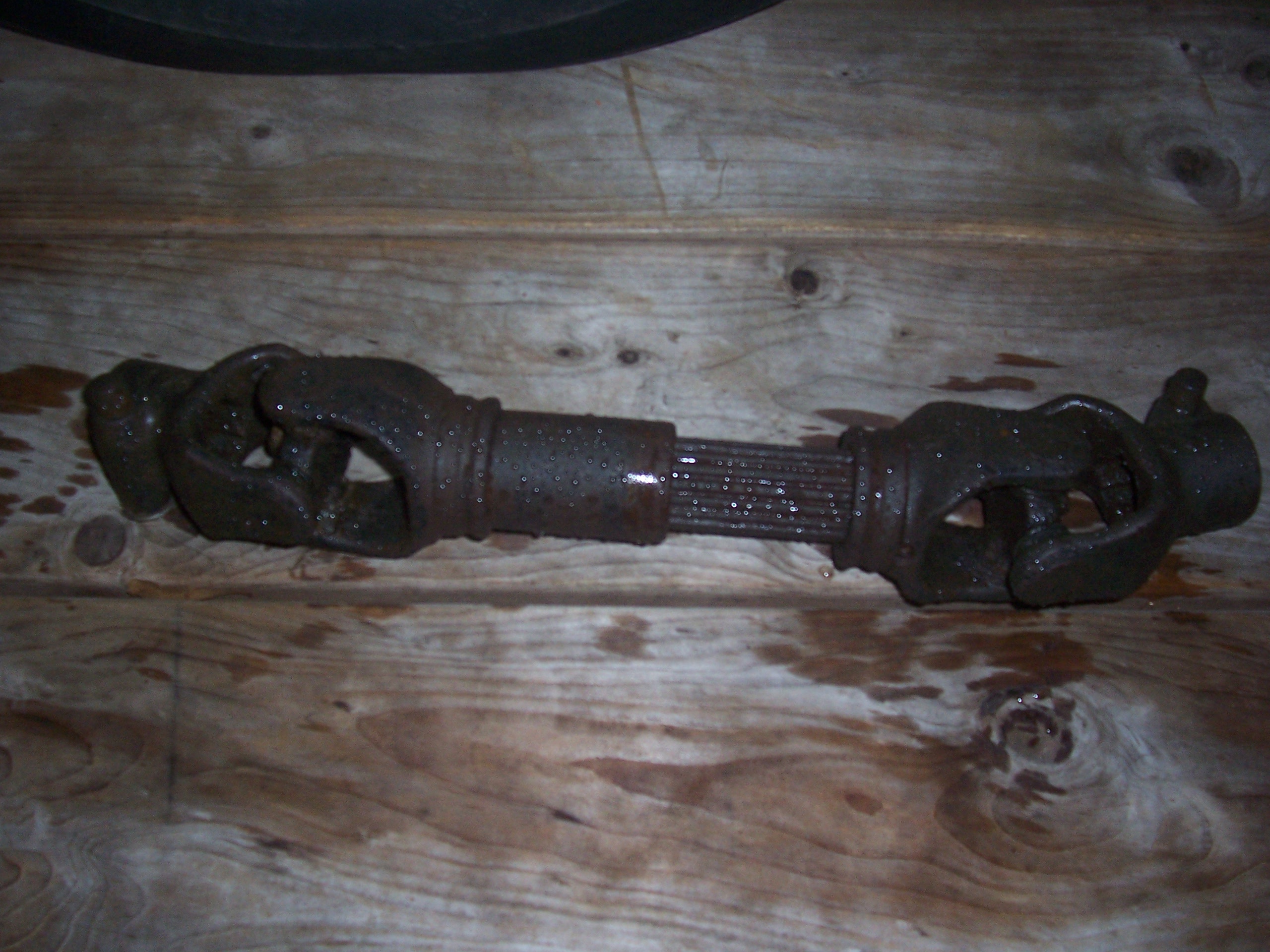

Your just about have to and or get use to shortening Pto shafts. I've had to on every one of my Imp. My Tiller that is the only one I have to remove it for and not going to cut up another PTO Shaft and go through all of that BS. again. It still was to long having to cut both sections. :mad: They finaly sent me another shaft after makeing the one in the pic. fit but still without the O/C which I can live with not really needing it with the tiller so I just keep everything handy to remove it. If I tilled much more than our garden probably be doing it anyway to try and add a slip clutch. I'm not sure this is the correct one either :confused2:
