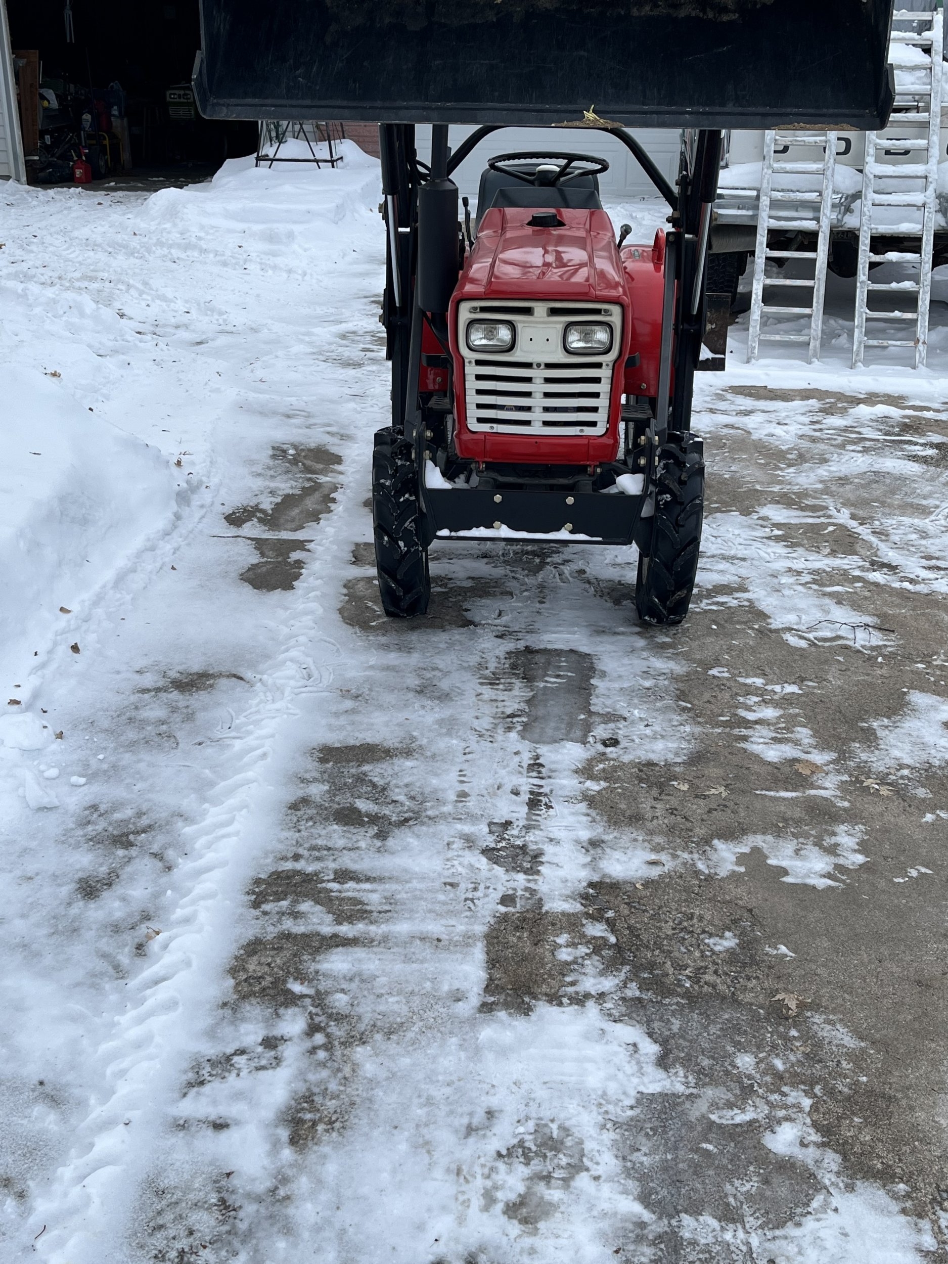

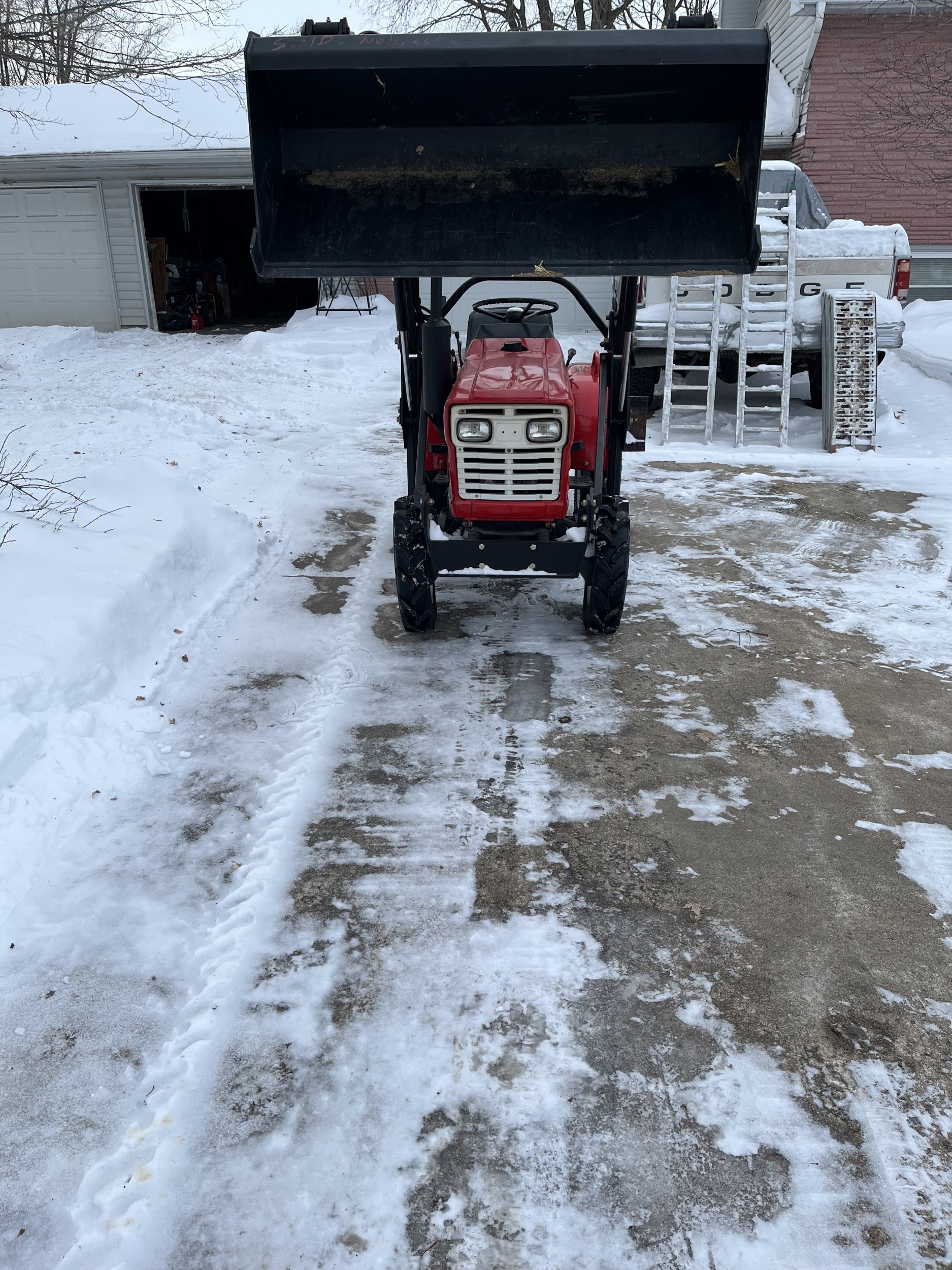

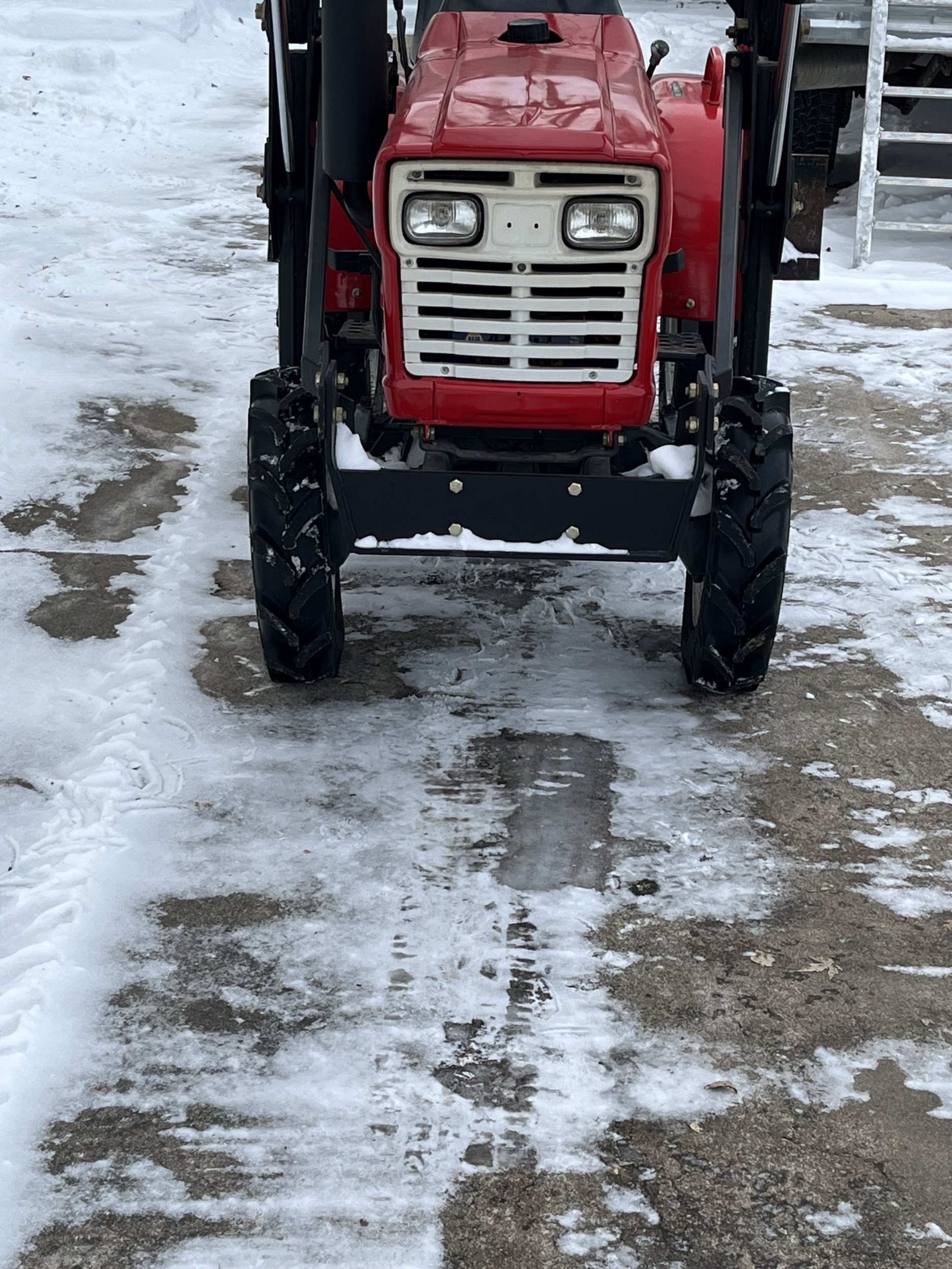

Hello everyone, its been a long time since I have been on here, but I am needing some help with how to adjust the toe and camber on my YM1510d. Do any of you have instructions on how to do this, pictures are always nice too. The tractors toe is "in" on both front wheels, and I believe it has a little "negative" camber. I will have to look at the camber again to make sure of that. I will try to take a picture if anyone is interested. I bought the tractor a little over 3 years ago, and that is how it was when I got it, I haven't used it much do to our fire and move, but need and would like to use it soon.

I didn’t see this until I got back home otherwise I would have taken some measurements. However I was able to get it started so I could move it and take pictures.
Let me know what you all think.
/ Yanmar YM1510D Camber & Toe Adjustment
#9
The pictures don’t seem to show to much of the toe in, but when I’m on the tractor it appears to be worse.

From a couple thousand miles away, that camber doesn't look that out of whack to me, ;) (but what do I know), though the toe-in isn't really visible... I would be more concerned if when you had a front wheel jacked up off the ground and could rattle it (bad bearing or kingpin wear).
Is there some tractor operation that leads you to think something is amiss? Normally, if the toe-in is badly off, you have tire scrubbing, hard turning, or if you have toe-out (the wheels are pointed out), no straight line control to speak of.
Basically, in a tractor both (slight) toe-in, and negative camber, gives a zone of stable operation, but too much of either when generates tire wear. Cars...well life is more complex due to performance and suspension factors, but generally the same until you get to race cars. Race cars and performance vehicles can have things like positive camber due to anticipated down force and other factors. Speed changes the tire shape/height, and potentially the load, affecting camber. Generally, as toe-out is unstable so it is used only in race cars for performance (hyper responsive steering).

Thanks for the post Peter. It appears to be positive camber with slight toe-in from the pictures. When I am on the tractor the toe-in appears to be worse almost as if the right front tire (sitting on the tractor) is being pushed in as I am moving forward but appears to be less when sitting still as in the pictures, that is one of my concerns.
I will have to go back out and lift the front end up in the air and see if there is any rattling coming from either wheel.
