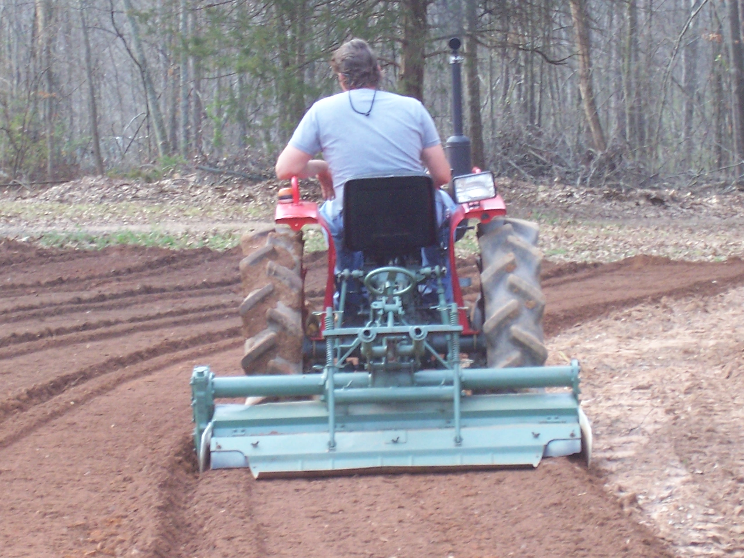

I have a 2000 and use a RS1400 with it and I've used a L2800 a good friend owned. You should be fine. Most of my flaps are missing I never had a problem or had a need to make them bigger. Works great for me ;)
