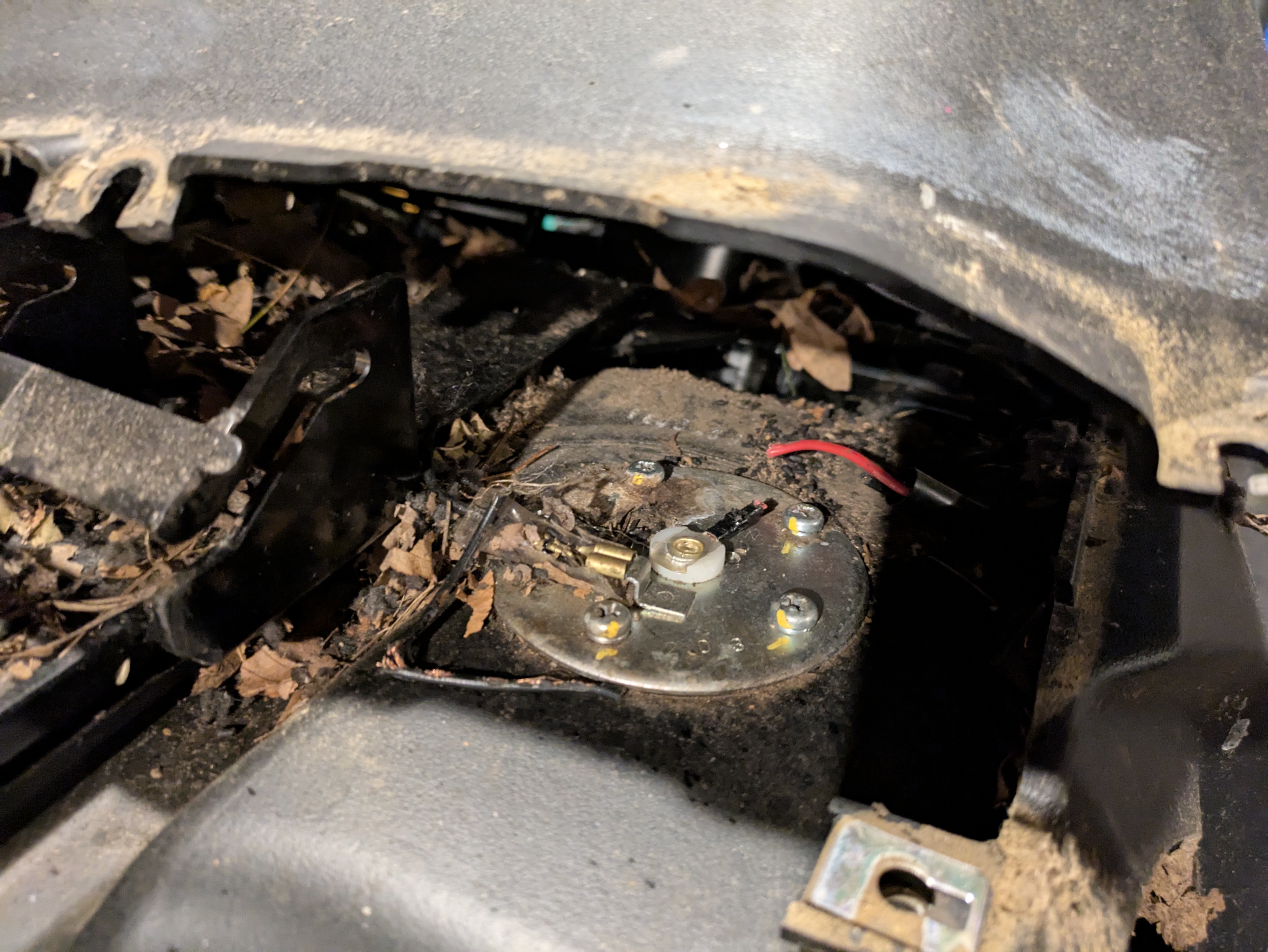

can anyone tell me why my fuel gauge is flashing? it's full! when I first got the tractor it didn't flash but now it's constant... I'm on my third tank of fuel and I don't know why it's flashing or how to make it stop, any help would be very appreciated!

Maybe an electrical connector has come off the fuel gauge.
More rare, float has come off, is anything floating in tank?

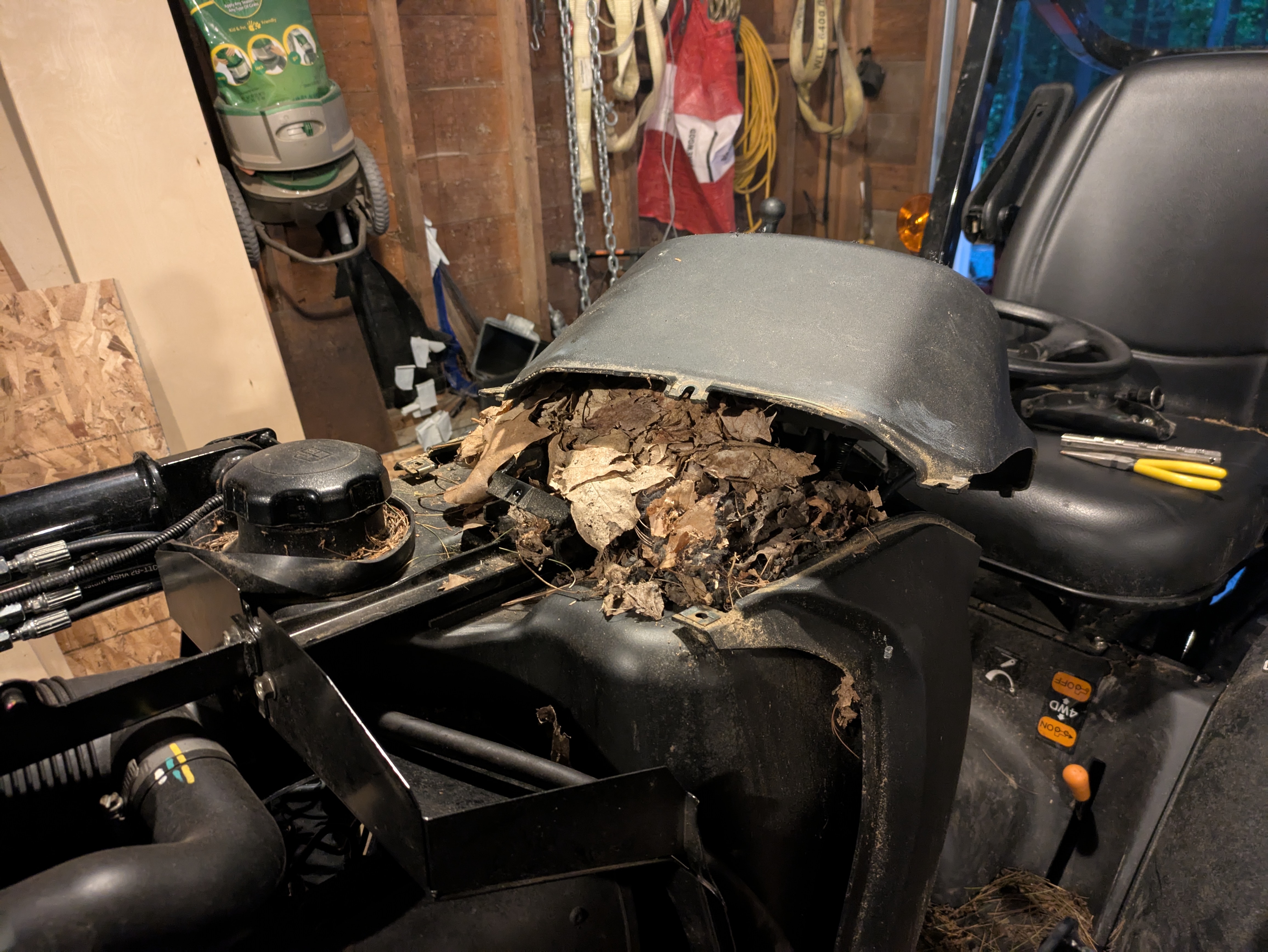

I found that my problem was 2 chewed-through wires from the fuel level sensor on the top of the tank underneath the dash. So, I can confirm that a fault from the fuel level sensor causes the flashing full fuel on the LCD. Makes sense, actually -- I just wish that it was included in a manual somewhere. Maybe the engineers thought that it was too obvious to write down? Ha.
