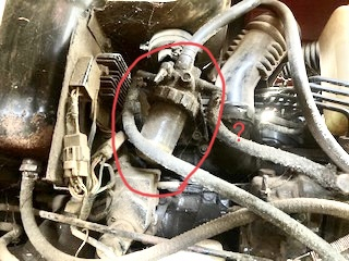

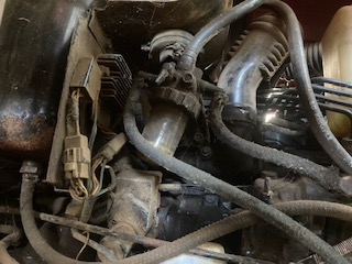

It's probably time to change the fuel filter on my Yanmar FX32D. I see that Hoye has a filter for that tractor, but it looks like it's going to be too big. I measured the glass that it fits into, and it measures about 3" tall and 1.75" wide. The Hoye website has one that is 3.5" tall and 1.9" wide. I've attached a photo of the glass filter canister. (By the way this looks kind of small for an engine of that size.) I wonder if what I have is not original for that engine.

I can't seem to see where the filter is in the image.

Why not just delete it entirely and install a Racor filter base and Racor spin on filter instead? Considering the filtration capacity of the Racor as well as the water blocking attributes, you'd probably never have to ever change it again. Did that to both my Kubota's and eliminated the OEM bowl filter entirely. Nice thing about a Racor is you can drain off the contaminates via the clear bottom of the filter when necessary.

Great idea, I was thinking of something similar if I can’t find a replacement bowl. I’d just have to figure out the mounting, which should be pretty simple given its current location.

Some Ebay listings sell the element / bowl / o-ring together, as a kit. You might buy such a set (or maybe a previous owner did). I think any of the similar bowls will mount on your housing.
When I bought the YM240 (US version of YM2000) in 2003 it had some prior owner hacks that I remedied to get it back to stock. The fuel filter had been replaced with a cheap disposable filter.
I went to the importer/wholesaler of VN 'refurbs' and bought the correct filter assembly off a salvage YM2000.
Then I discovered that their warranty return 'refurb' with the blown engine had been refurbed(!) with a fuel filter bowl and element that Yanmar never heard of.
After I bought the proper element and bowl listed for my model, it then conformed to the factory parts manual so buying elements has been simple ever since.
