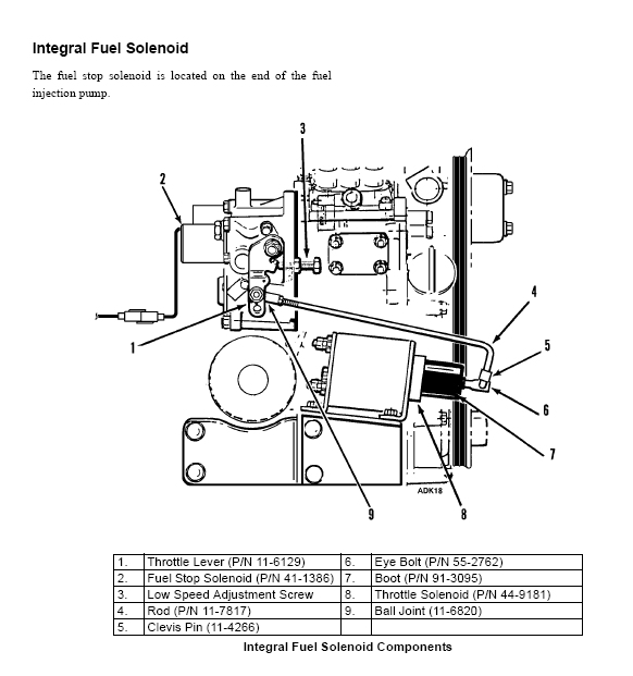

I found a small fixed speed 3 cylinder Yanmar Thermo-king diesel that has no throttle lever for speed adjustment.
Positive ?, reason I ask is that all the TK 3.74 that I've worked on had a lever for speed control and a separate fuel shut-off solenoid.
Like this pic from a TK manual.... yours not the same ?

I've only seen the engine in photos, it doesn't have any levers on the injection pump but there is a closure plate where the lever would be.
The flywheel end has a PTO shaft with pulleys on it so I can't see the flywheel.
The owner said it is fixed speed with no adjustments.
I would think (hope) it could be changed with little effort/cost with parts on e-bay.

Well somethings up then cause if it was indeed on TK refrigeration unit it WOULD have a high/low speed lever.
See if you can find out the model unit it came from and I'll dig up a manual.

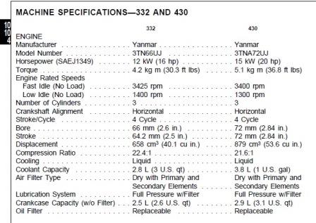

Can anybody help find the HP and torque rating on this engine. Also is it similar to any other non thermo king yanmar engine. Thanks
/ Yanmar, converting fixed speed Yanmar to variable speed. #8
Looks like its only 12.6 HP? Why is this so heavy?
/ Yanmar, converting fixed speed Yanmar to variable speed. #9
The HP rating is likely at a lower rpm than L&G engines. Once you figure out the throttle/governor issue and raise the speed the HP will also go up.
