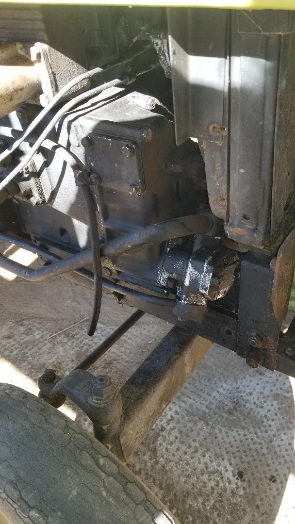

The cover with the 2 allen bolts are leaking. it is the part above front axel that is painted Gloss black with the paint coming off and some kind of rubber round boot on the bottom. tractor oil pump.jpgtractor oil pump.jpg
/ Yanmar 240 What is This? #2
My guess is a hyd pump....

I need to find a gasket, the front cover is leaking and I can't find the image on the net.

The cover with the 2 allen bolts are leaking. it is the part above front axle that is painted Gloss black with the paint coming off and some kind of rubber round boot on the bottom.View attachment 683343View attachment 683344

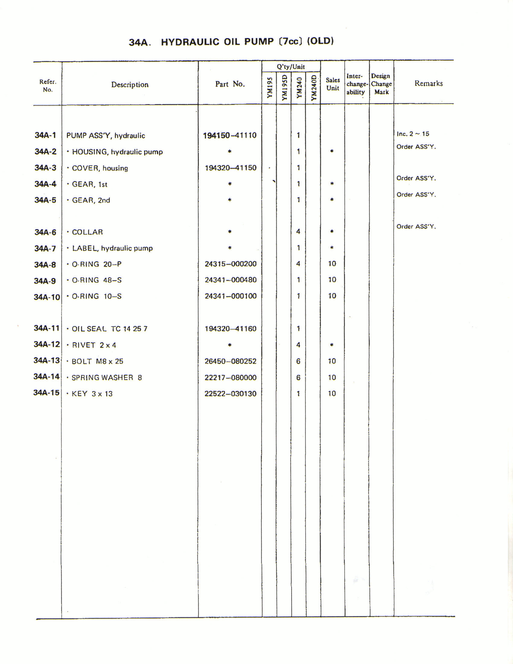

It's the Hydraulic Pump 7cc
Pg 172 thru 176 in the YANMAR YM195 YM240 PARTS MANUAL 000Y00T2381.PDF Over at the Yanmar Tractor Owners Group on GroupsIO.

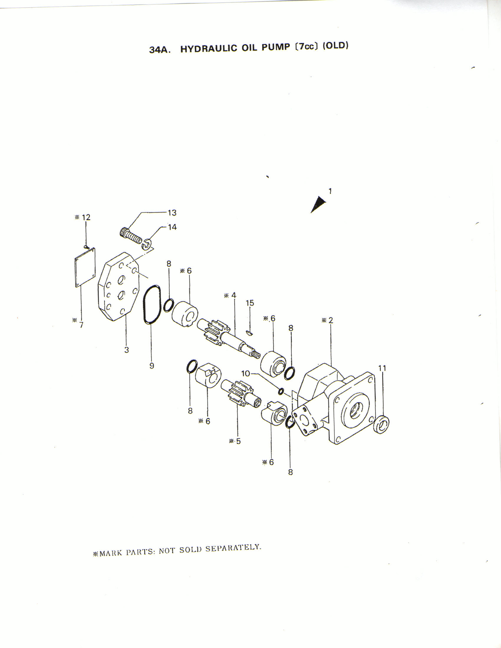

It looks like it going to be a tough one. All aftermarket pumps switch over to a different cover with 4 bolts.
/ Yanmar 240 What is This? #14
I think that cover may have 6 bolts, 4 being recessed.
/ Yanmar 240 What is This? #15
Winston, that's what I was thinking too. That's what the exploded diagram that you posted seems to show. And there are 6 listed on the parts count.
Where did we get into aftermarket pumps and different bolts? This should be a straighforward fix. I'd say "easy", but nothing old ever is.
rScotty
