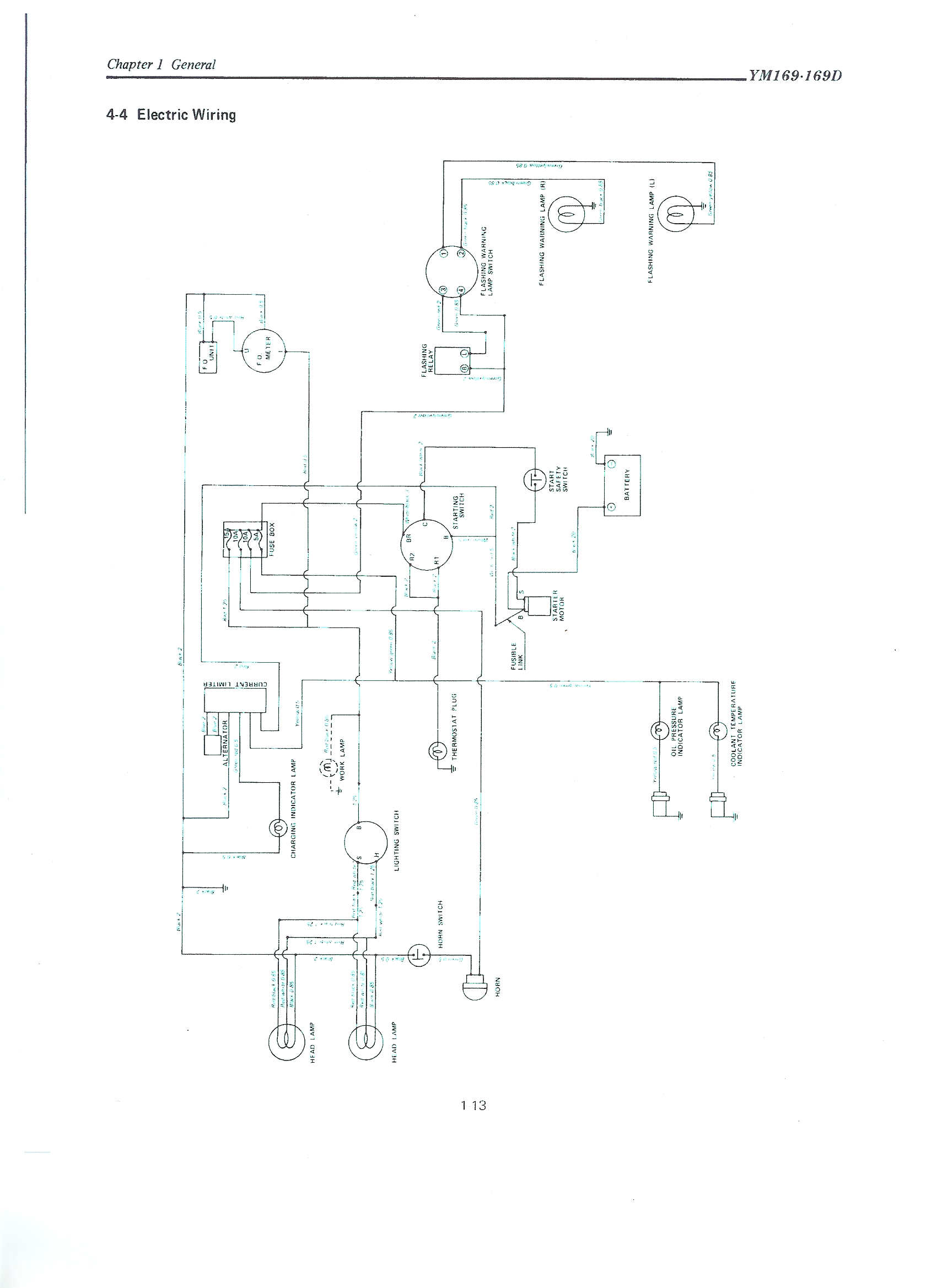

An English translation of that electrical schematic would be of great assistance in troubleshooting
Here's the schematic for earlier, simpler YM240 with everything identified in English.
https://www.tractorbynet.com/forums...0d-volt-reg-wells-vr728-557466-yam240elec-gif
I don't know if the YM1601 in this thread has a conventional automotive alternator and regulator but that's what's in this YM240 schematic, so that might be a major difference.
Things like headlights, horn, clutch safety switch, thermostart should be similar. If the YM1601 schematic has an 'extra' warning light in the dash that might be a battery-water-low warning, used on some models.

If you left the regulator unplugged throughout your testing of the battery voltage, there is why you show consistently the same battery voltage. The dyno will send unregulated voltage to the regulator.
I agree that you have a short in a wire! Probably a bare wire against metal. You had a heat feedback to the one wire from the regulator by looking at the picture of your connector. Start by tracing that wire from the connector to its other end. We know it had a lot of heat in that wire. For that reason you may want to replace it completely as insulation is likely melted and resistance of that wire compromised (increased).
Then trace the wires from the 5 amp fuse.
Good luck. And ask for help when you need it.

I have done so much automotive electrical repair on the past 40+ years, that thinking about it is just not an issue. Unfortunately when a failure happens there is never a single one issue. But there are common hints. The burnt connection is one of those. Those connectors while state of the art in the late 70’s and early 80’s, are far behind todays connectors, but then so are the electrical requirements of that tractor. That all aside, signs of heat/ burning are good indicators of the initial problem. As you say, it could be a cut through insulation where it has rubbed on a sharp metal edge for 35+ years or a longer rub through from the vibrations.
Also unfortunately the melted connector could be unrelated to the 5 amp fuse being blown.
Electrical issues requires lots of patience and time as well as knowledge. The good part on these old yannies is almost all of the testing can be done with a test light. A digital multimeter was unknown when they were built, it was analog volt/ohm meters all they way back then.

Both the 1601 & 169 are 3cyl 16Hp. Tractor Data. So it would almost have to be close. Forgot I had this one so it's worth a post. I do have the whole manual for the 169 but the file for it is to big to download on here. I was able to get the Dia out though. If it works and you want the manual for the 169 then message me and try to email it to you. There only a couple Yrs. aprt in production with the same body stlye so I'm thinking it should be it.

I had that Manual on a old zip drive. And just happened to find it. Get your Reg. Dyno/Alt going. Rewire/check that circuit. The Starter and solenoid didn't match. But Hoye does have a pic. of them and the solenoid looks the same so you should be Okay there. From my parts book and Hoye's parts every thing matches up the same :thumbsup: The Dyno. Alt. Regulator. Key switch are the same. Starter Solenoid just because it not the exact one for some reason from the looks it wires the same so your good there. Get those circuits checked rewired etc. and you got it. Plus now you have a Wire Dia. and manual so it shows how they wire. Big+...........

As I have never in person seen a US model Yanmar tractor of this vintage, my only concern on using a wiring diagram for an Japanese model, would be US specifications that may not have been included on the non US models.
Again the Japanese YM’s electrical are straight forward enough that if comfortable with 70’s and even early 80’s automotive wiring, you should have no trouble following the wires and making needed repairs.
I encourage replacement of any wires that seem to have issues for several reasons. These wires are largely not protected beyond the insulation on the wire (no looms for the most part). And any wire that has been exposed to excessive heat has an increase in resistance.
Having expressed the concern on the US model diagrams, they are still the best guides we have.
Also you might wish to purchase the manuals offered by Hoye.
Again you can do it with just basic knowledge of 12 volt electrical circuits.
If you hit spots you have questions about, ask questions here and if you can post pictures.

Update, I have removed the tape from the wires that were under the console. I traced the wires from the 5amp fuse and the dummy lights/gauges. No sign of damage or defective wires. I decided to tape everything back up and move on since the tractor runs fine. I am waiting on an hour meter cable to arrive and will reattach the sheet metal. If the problem is magically fixed when I start it back up so be it. If not, I will add an aftermarket temperature gauge and continue on. Thank you all for helping me along.

I went back and looked at the original post. There you had a pictured posted of your voltage regulator with the wire harness connection with 1 melted contact. It is possible that your problem may be internal to the regulator. Or it could be that the connection inside that connector provided too great of resistance. Prior to replacing the regulator, I would do the following and I would probably bypass that wire connection within that connector if the following shows no issues.
However, I strongly suggest you trace the wire on the other end of that connector to ensure that it is in good condition.
Yes that encompasses many factors but start with a good close visual inspection. If anything hints at failing this, replace that wire. If visual inspection does not reveal any issues, do a resistance test on that wire using a multimeter. (There are youtube videos that explain this if you are not sure how to do this). A wire that has gotten hot will have greater resistance. Compare it to a wire of the same gauge and same length if it provides anything but no resistance.
