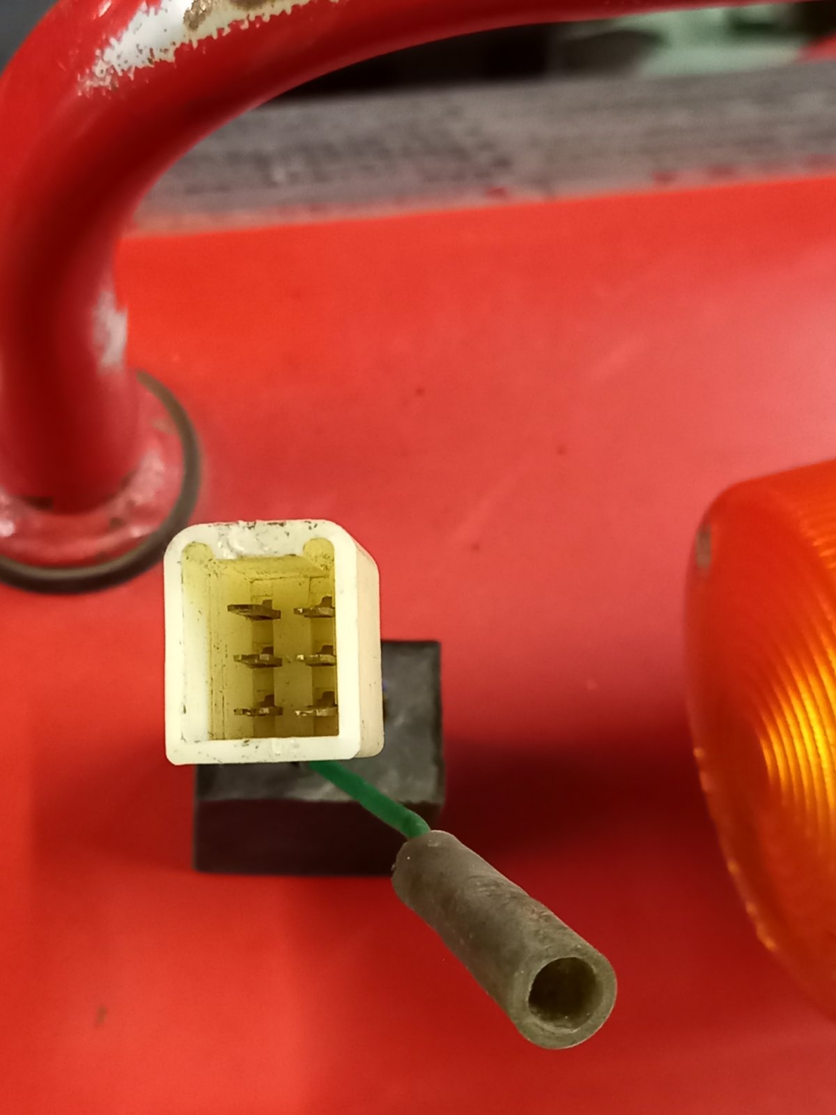

If you left the regulator unplugged throughout your testing of the battery voltage, there is why you show consistently the same battery voltage. The dyno will send unregulated voltage to the regulator.
I agree that you have a short in a wire! Probably a bare wire against metal. You had a heat feedback to the one wire from the regulator by looking at the picture of your connector. Start by tracing that wire from the connector to its other end. We know it had a lot of heat in that wire. For that reason you may want to replace it completely as insulation is likely melted and resistance of that wire compromised (increased).
Then trace the wires from the 5 amp fuse.
Good luck. And ask for help when you need it.

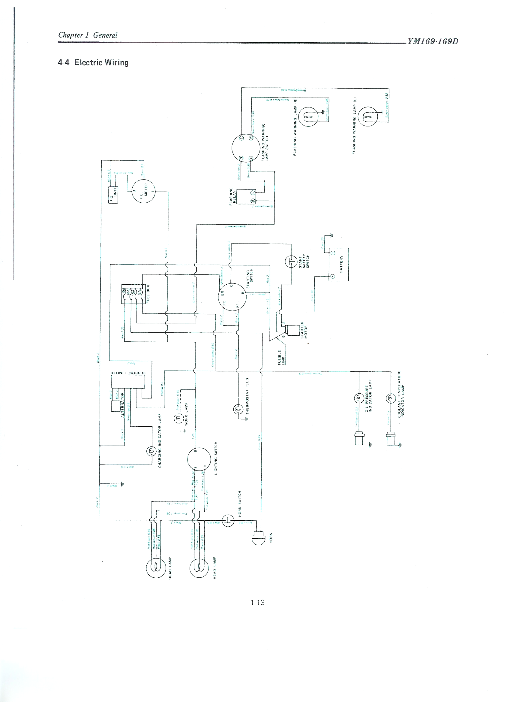

Here's the schematic for earlier, simpler YM240 with everything identified in English.
https://www.tractorbynet.com/forums...0d-volt-reg-wells-vr728-557466-yam240elec-gif
I don't know if the YM1601 in this thread has a conventional automotive alternator and regulator but that's what's in this YM240 schematic, so that might be a major difference.
Things like headlights, horn, clutch safety switch, thermostart should be similar. If the YM1601 schematic has an 'extra' warning light in the dash that might be a battery-water-low warning, used on some models.
Both the 1601 & 169 are 3cyl 16Hp. Tractor Data. So it would almost have to be close. Forgot I had this one so it's worth a post. I do have the whole manual for the 169 but the file for it is to big to download on here. I was able to get the Dia out though. If it works and you want the manual for the 169 then message me and try to email it to you. There only a couple Yrs. aprt in production with the same body stlye so I'm thinking it should be it.
