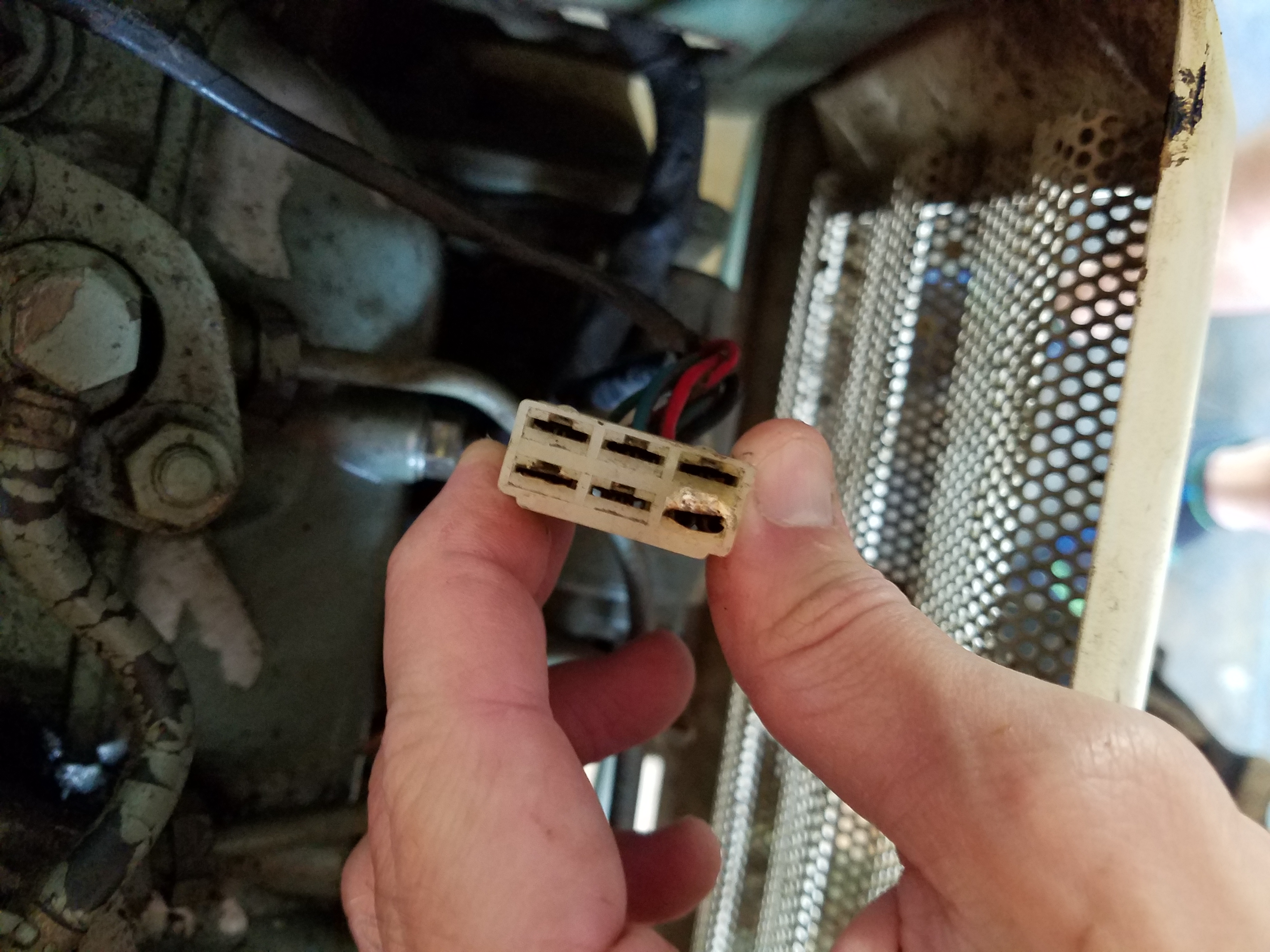

I have a 1601d diesel with 1500 hours on it. This summer I have had some issues starting the tractor. I replaced the 10 year old battery and cleaned the terminals. I had lost the dummy lights and fuel/temp gauges earlier this summer, but the rpm gauge worked as did the lights, horn, and turn signals. Trying to diagnose the problem, I replaced a blown 5amp fuse. I had the ignition turned on and was tracking wires when the voltage regulator started smoking and was extremely hot. I turned off the ignition and dumped water on it to cool it off and prevent a fire. I have removed the voltage regulator and been running the tractor as needed since, always putting the battery on a trickle charger. I have since lost the rpm gauge. The 5amp fuse will blow each time the tractor is turned on however. I had a mechanical inclined friend look at it and he noted the generator has a small amount of play in the bearing. He thinks this is causing a short and is the culprit of all the problems. So am I doing permanent harm by running the tractor this way? Is it worth the expense to replace these two parts? Am I missing some other problem here? I have posted the burnt wiring harness to the voltage regulator for reference (one of two blue wires is the burnt terminal). As always thank you for looking and replying.

On more thought on your electrical issue the initial problem may have been the regulator and it was sending too much for your 5 amp fuse. However, by the looks of of your connector for your regulator, you may well now have issue with the wires that show signs of extreme heat/melting.
Again if you are comfortable with electrical work, check the resistance of these wires.

I was just looking close up at your posted picture of your regulator connector. 4of 6 look great. 1 looks ok. Then the one melted one, I would not wish to use, but bypassing just the 1 is easy enough to do with with 1 each of matching style male/female connectors.
Have you determined if you blow the fuse with your dyno unplugged?

With the regulator smoking and the melted connector, his problem is like in one of the 2 either the dyno or the regulator. Off hand I am not sure where the melted connector point goes to. If it is from the dyno to the regulator his problem is likely the dyno. If it goes to his fuse that is being blown,his problem is possibly his regulator. But that wire being shorted out may be the problem as well. A voltage test, ohm test as well as close visual inspection is in order.

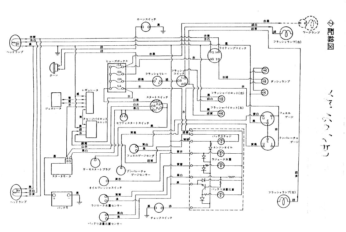

The 5 amp fuse appears in the schematic posted earlier to only go to about 3 items.
Fix the short first, you can disconnect the individual components if the wiring all looks good.
Disconnect the first one install a fuse and turn on the switch if it holds you are good to that point,
reconnect after switching off go to the next component and repeat, once the short has been fixed then address the next problem.
Such as carefully inspect that over heated connector and repair or bypass that connector.
An English translation of that electrical schematic would be of great assistance in troubleshooting
