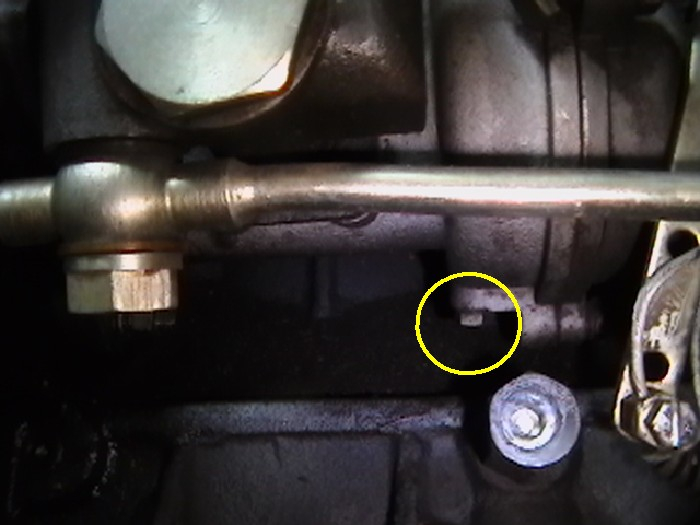

You use the same lube oil that you use in the engine (SAE 15w-40 with an API rating of CK-4). I'm looking for my pic of the oil drain plug, but the fill point is usually the mushroom shaped vent on top. There is a 8mm hex head tattle-tail plug on the side that is to be removed during filling to indicate when it's full. As an alternative, you can suck the oil out through the dipstick tube.
Yellow circle is the oil drain, right at the end of the governor. Not easy to get to that's why I suck my oil out with an extractor.

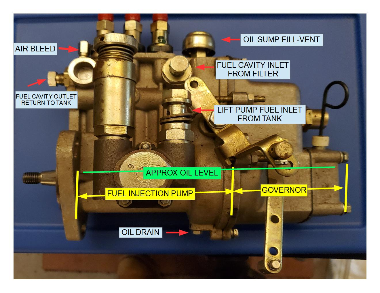

   / YANGDONG Y380 ENGINE REVS UP HIGH IDLE #17
I dug out my spare fuel injection pump assembly, and I was anxious to try out a new Open Office program because MS Visio doesn't run on WIN 11, so here is the result:

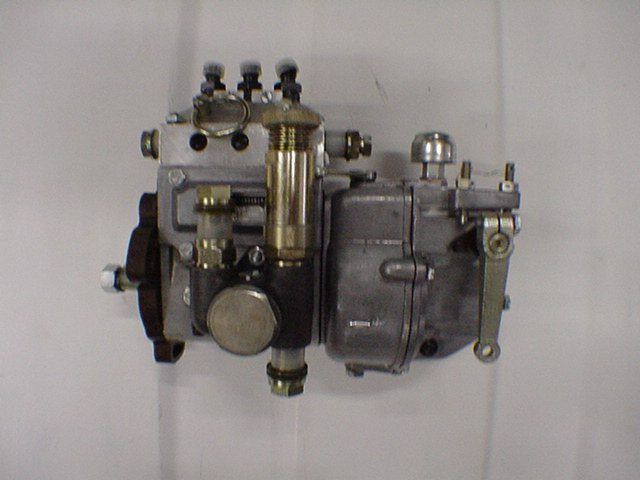

   / YANGDONG Y380 ENGINE REVS UP HIGH IDLE #18
Before I go too far, which fuel injection pump do you have? Left or right?
#19
Left pump
   / YANGDONG Y380 ENGINE REVS UP HIGH IDLE #20
Left pump
Ok, on these two models it's very possible that they are oiled from the engine's pressure system. Check to see if there is a hose leading from the injection pump to the engine oil filter base, or to the side of the engine block.
