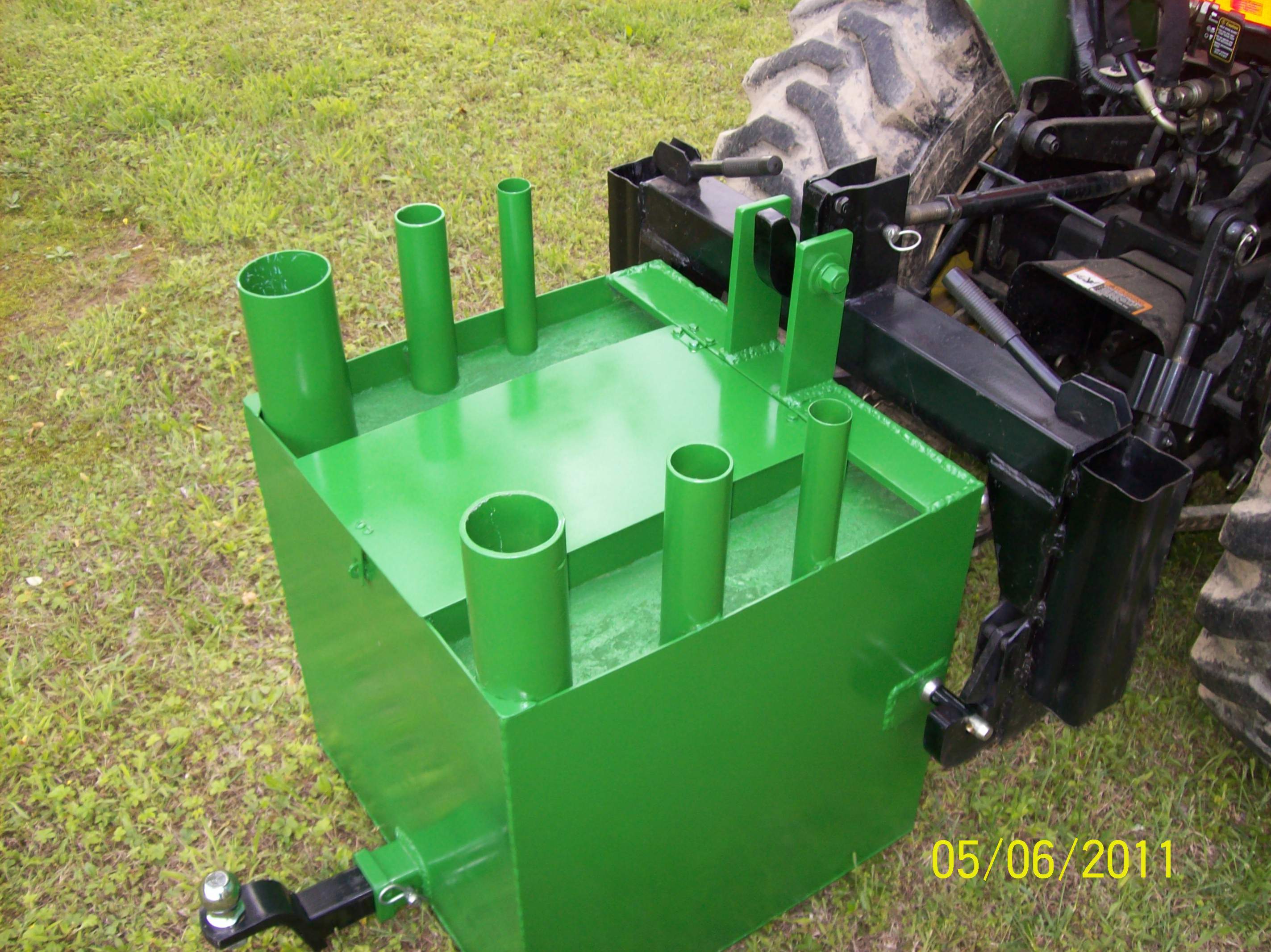

You might think about rounding/ smoothing off the top inside edge of the pipes. Sharp edges there seem to wear a groove in the wooden handle of tools as they bounce around, & make 'em weaker. Just a little thing to think about, maybe not a big deal.
Thanks for the info'!!!:)
Now I know why a couple of them have a ''ring around them''!!!:D

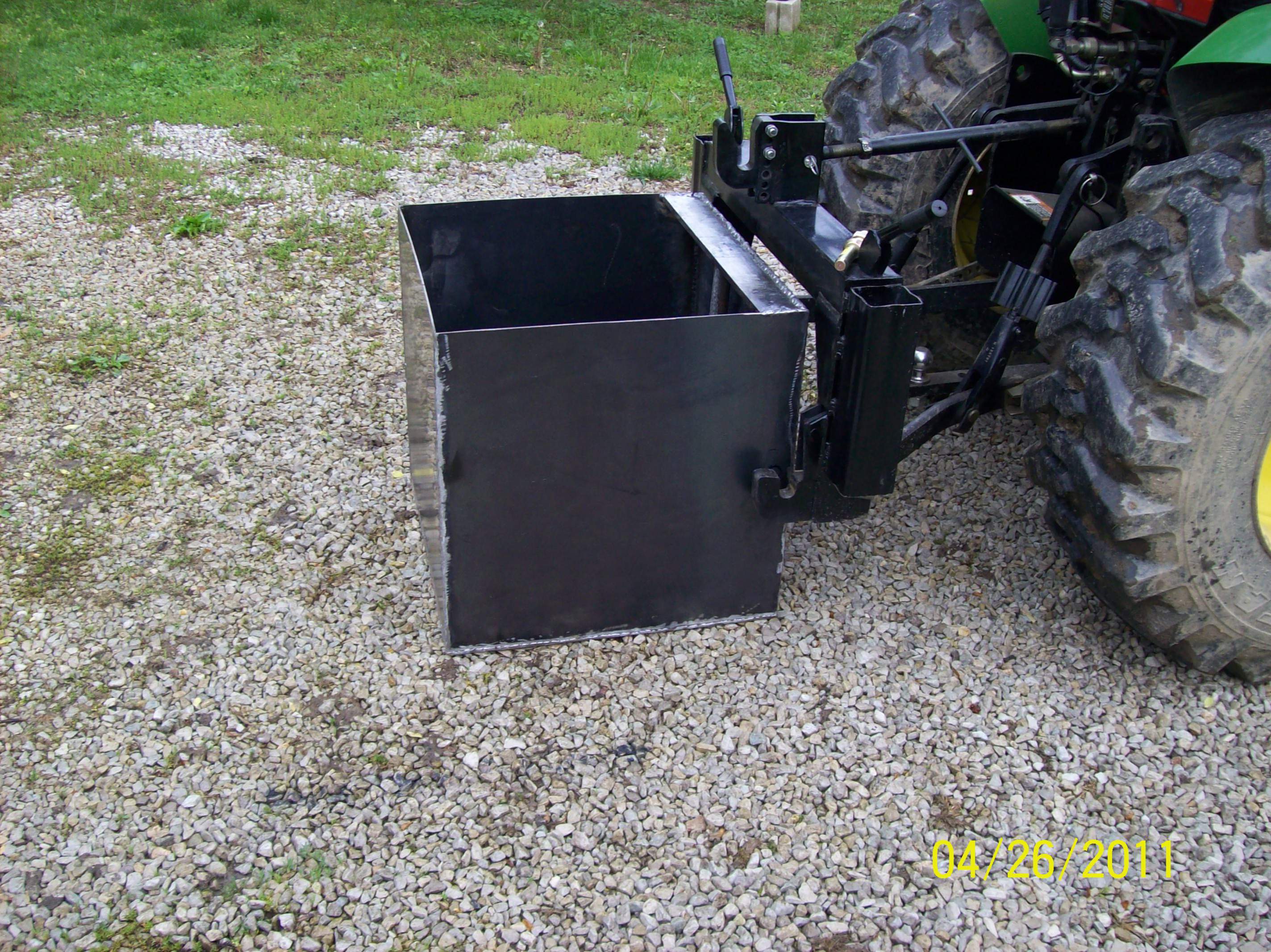

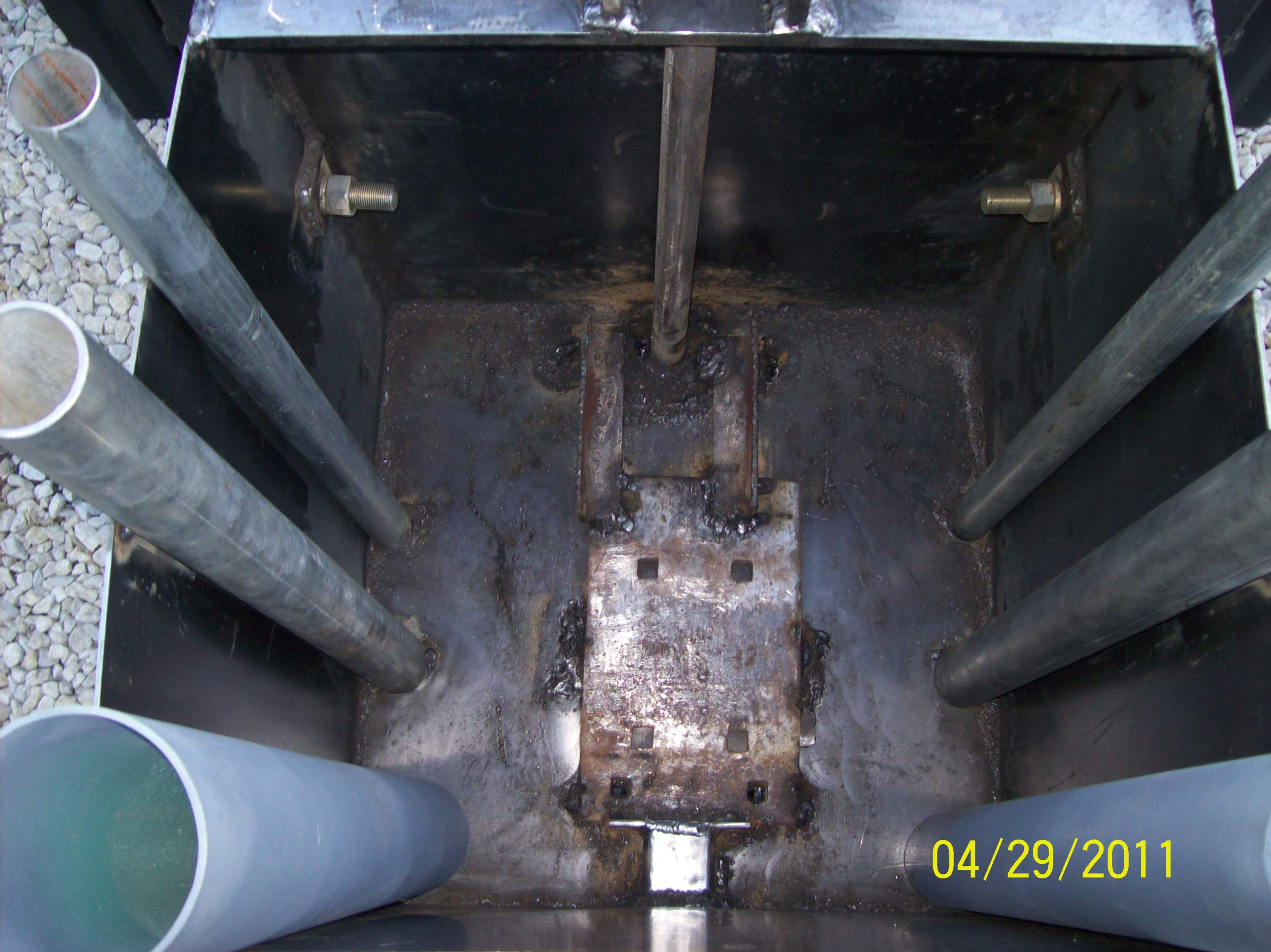

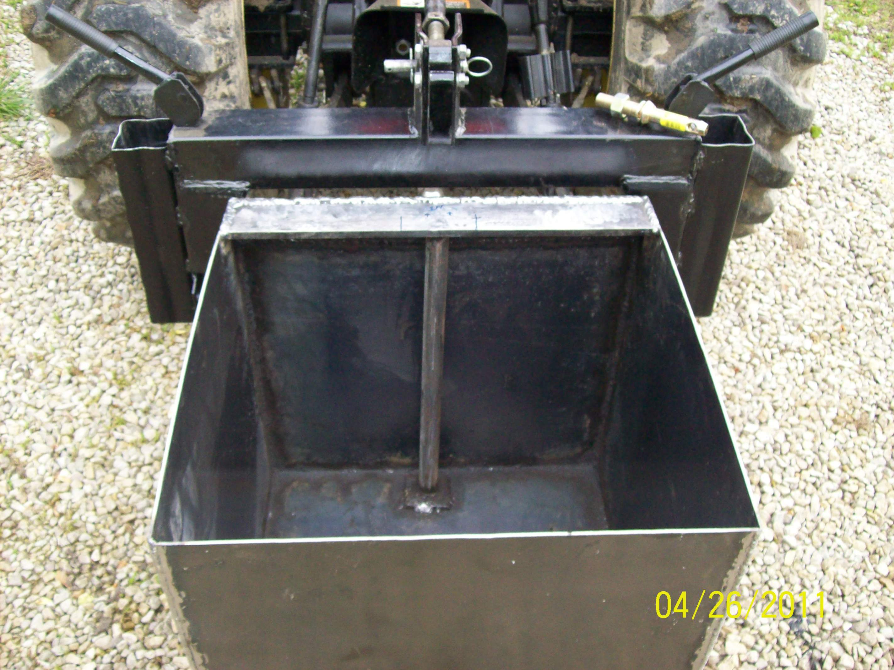

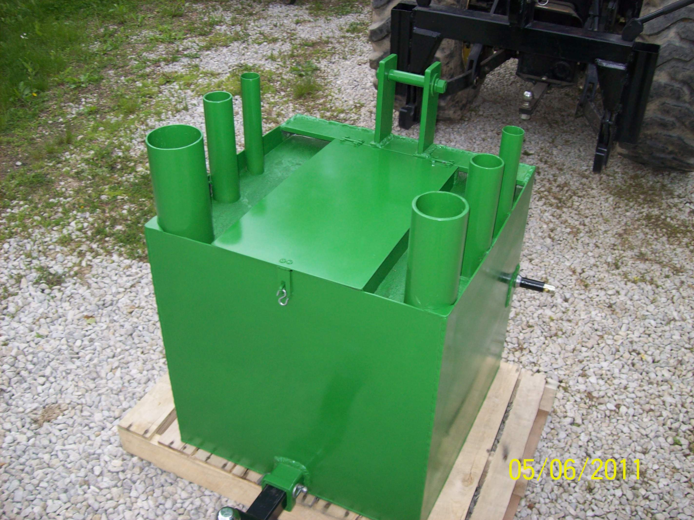

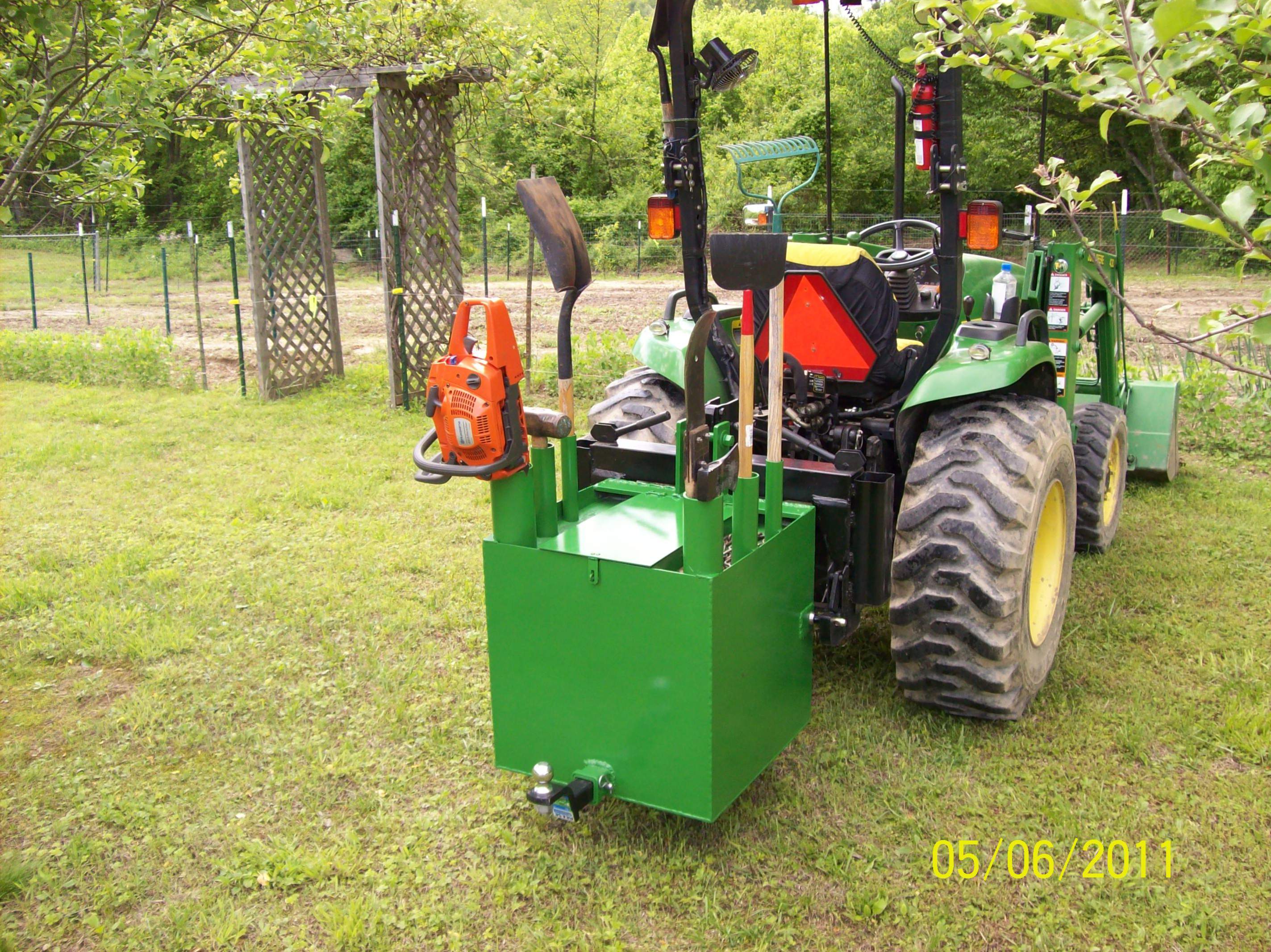

I built my BB last year.. It's 2'x2'x2' and weighs 1,446 lbs. without any tools or chain in it!.. I made it to fit my HF Quick-Hitch!
I put 6 pipes to hold rakes etc', chain and I put in a large PVC pipe to hold my chainsaw!... I also made a ''storage box'' so I can put small items in it like wrenches and other tools!... And I put a hitch on the back so I can pull trailers!:)
Here's a few pictures...(I do have pictures of the whole build)
Bill

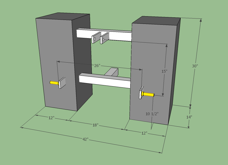

Following some of the many good tips from this forum, I decided to go with a concrete filled ballast box for the 3PH, to help when the FEL is picking up big loads.
My three requirements are:
1) I want to keep it as tight to the back of the tractor as possible for maneuvering around.
2) It needs to weigh about 1200 lbs to provide adequate counterweight.
3) I want to make it work with my HF quickhitch so I can pick it and drop it easily. I really only need it when working with the grapple. The rest of the time it'll sit on a couple dollies.
I know there's 100 different ways to add ballast (i.e. counterweight), but I talked with a local fabricator and he is willing to build a metal box for $150, and the concrete place across the street from him is willing to fill it up for free with leftover mix, so this turned out to be the easiest way for me to do it.
I drew up a (overly complicated) sketch of the box for the welder, and I'm posting it here for any comments or suggestions before I have it made. Any further thoughts on this much covered topic?
HH
I can't get your drawing to open. Computer tells me this type of file is risky, but even with the risk it will not open. Suggestions???
You'll need Adobe Acrobat Reader.
If you have it (Adobe Reader) and it still doesn't open, you may need to update Reader.
