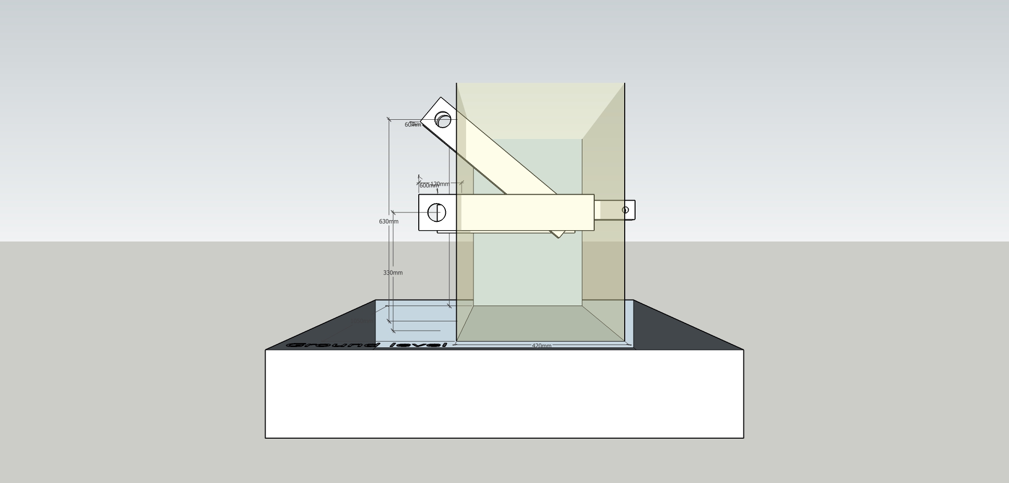

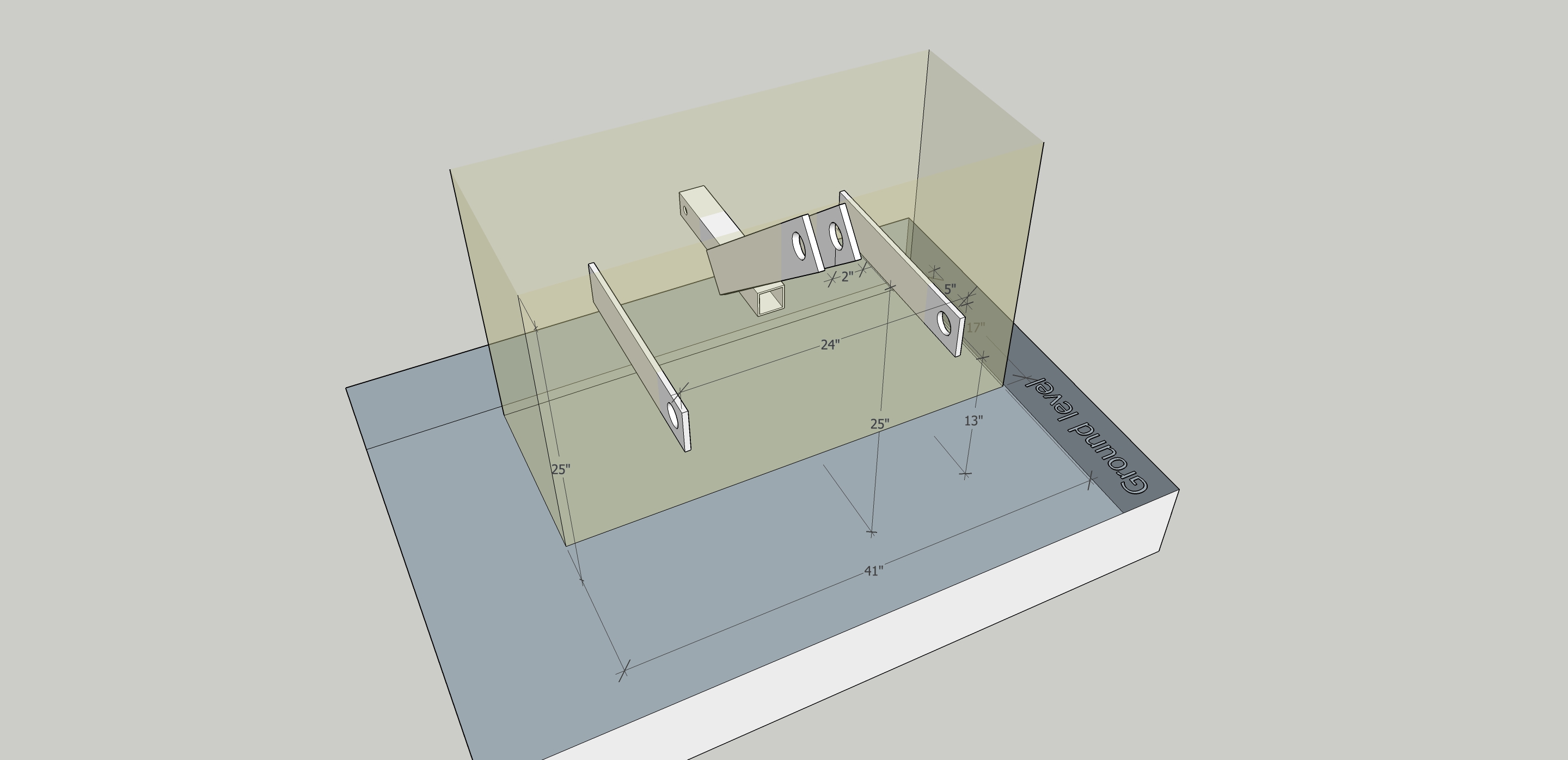

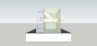

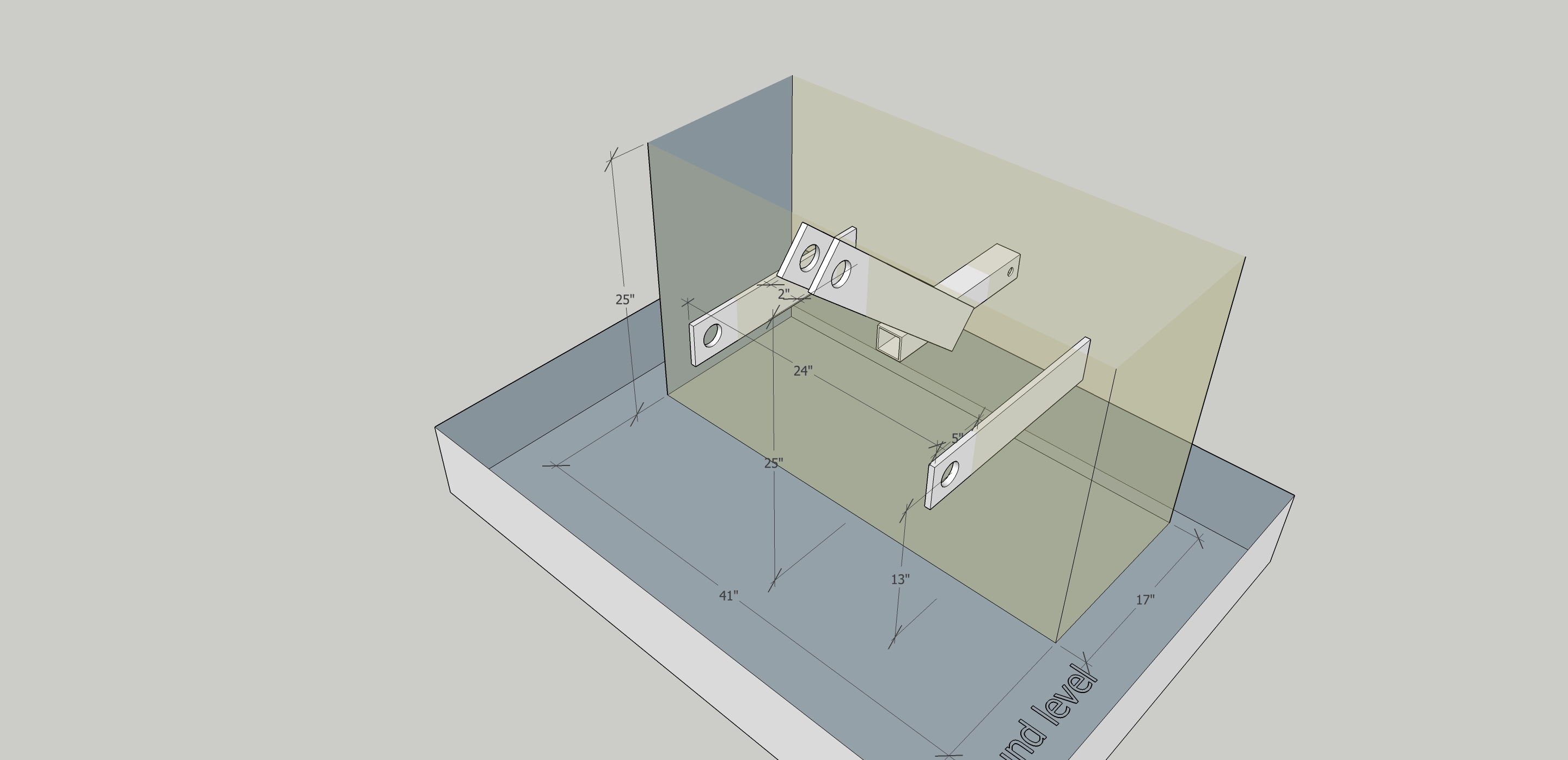

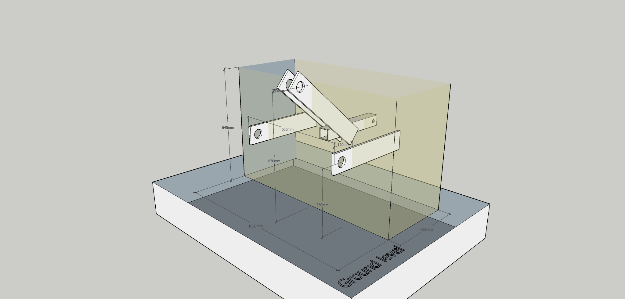

These Sketchup drawings have the basic information about the counterweight I have planned. I have produced copies with metric and with imperial units.
They don't show the internal bracing, pullout prevention bits and pieces, etc. as I am nowhere near skilled enough in Sketchup to include those details.
I plan to fit as many brake rotors as I can into the block.
The estimated final weight will be around 830kg (1800 lbs). Is this too heavy?
I would be very grateful for any feedback on the design, before I make the irreversible commitment of pouring the concrete.

Have you calulated ground clearance with the 3pth all the way raised? With the lift pins starting at 12” off the ground you MAY have a limited clearance on rough ground. Something to consider...
   / Ballast - Any merit in this idea?
#38
Have you calulated ground clearance with the 3pth all the way raised? With the lift pins starting at 12 off the ground you MAY have a limited clearance on rough ground. Something to consider...
Good point!
I don't have easy access to the tractor, as it is on a weekender property an hour and half drive from home. But, I do recall the highest point for the lower arms being 700mm (27"), although my recollection might be wrong. That would give me a vertical range of about 14".
I used the lowest point based on when the upper link arm is about 2" above the PTO cowling and with the upper and lower links as close to parallel as possible. My thinking was that this will create a parallelogram that will keep the top of the block level when it is raised or lowered.
I have this in mind, in case I want to put a tray on the block, to carry items. Of course, the terrain varies, so the block won't always be horizontal - in fact it most often won't be, so the whole concept might be a bit stupid.
Perhaps it would be more prudent to not hassle about parallel arms, have the lower linkages a few inches higher than their lowest possible position and have the upper linkage about 2-3" clear of the cowling.
Does this sound like a better option to you?
