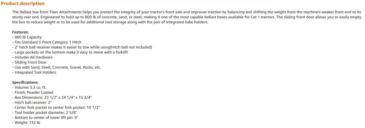

I wonder if the difference in the ad (that I saw anyhow on palletforks.com) which showed 5.3 and the 5.6 above is the box dimensions versus the actual volume being it has a couple tubes for tool storage.
Regardless, > 5 cu ft would get you to ~800 lbs of concrete.
Unfortunately the add is wring in saying "Engineered to hold up to 800 lb of concrete, sand, or steel...". They clearly mean that the box can take the stress of holding that much. Bad wording to make someone think 800 lbs of sand can actually fit in it.
   / The Real Problem With the Titan Ballast Box #12
NO - - ruffdog is right. I finally got the web site to open the spec sheet on the GREEN BOX. Must be because the green box is specific to JD that it is a slightly different dimension.
What ever - does not make much difference - 5.3 or 5.6 - not even Houdini could get 800 pound of sand in that space.
To get 800 pounds its either going to be concrete or start loading on chunks of railroad iron.

I got my Titan ballast box painted and attached. I had 700 pounds of sand waiting. The ads say it has an 800-pound capacity, and they say you can fill it with rocks or sand.
Guess how much sand it holds?
I have 350 pounds in the box right now, and it's nearly full. I believe it would hold 375. Add 375 to the weight of the box, and what do you get? Answer: 505 pounds. That's not 800 plus 130. It's not even 800.
Based on figures from a person who knows a lot about sand and concrete, at best, concrete would weigh 1.5 times as much, so I could conceivably get 560 pounds in there. That brings the total weight up to 690. That's a best-case scenario. It could be a lot less.
In order to equal the manufacturer's stated capacity, I would have to use metal. I could combine metal and other materials in order to avoid buying hundreds of dollars' worth of steel, but there is no way to do it without metal, if the figures quoted to me are right.
Gravel would presumably be the worst thing to use, because it would contain a lot of air.
I kind of think the ad should say something like, "Capacity (sand): 375 pounds." It never occurred to me to take the capacity of the box, look up the density of sand, and see if it would fit.

Most steel weighs about 480 lbs/cubic foot.
I have no idea what etc. weighs.
Would you have complained if it broke when you put 5.3 cubic foot of steel in it? (about 2,544 lbs).
I read that ad as like a trailer ad - My trailer has a 12K capacity.
