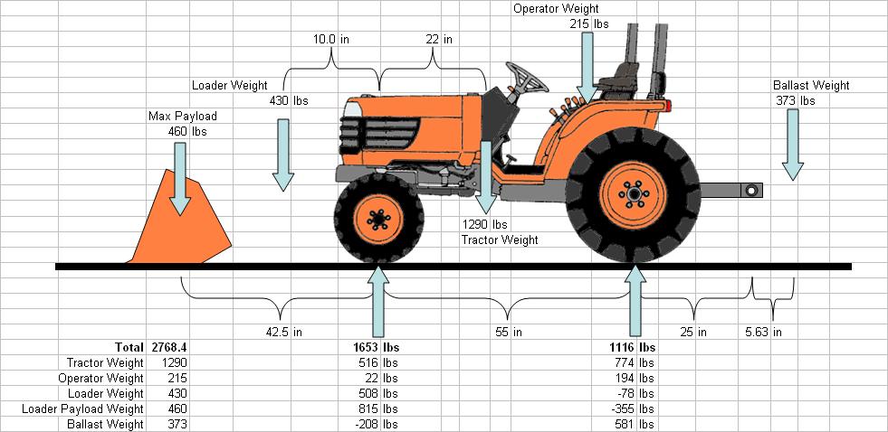

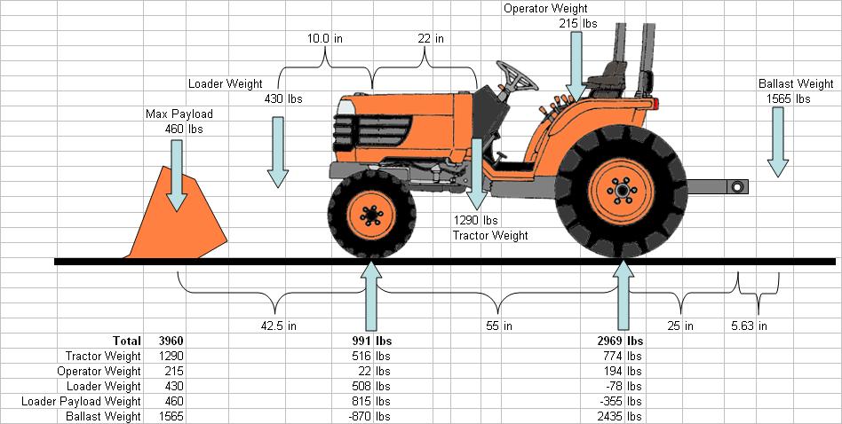

I've been running numbers for my Kubota BX to put a weight box on the rear. I was surprised by how much weight is carried on the front axle with a full loader. I think the "at least 25% on the rear axle" makes sense. You have to hang some serious weight on the 3ph to get the front axle down to 25% of total tractor weight with a max bucket load. I think, in most cases, this would exceed the rear axle weight limit and lift the front wheels off the ground when the bucket is empty.
Attached are some picks from my spreadsheet for planning ballast weight. It takes into account tractor weight, operator weight, loader weight, load in bucket and ballast. I don't have filled tires, but that wouldn't affect front axle loading anyway.
  • First pic is weight distribution with full bucket and no ballast.
  • Second is weight distribution with full bucket and ~370 LB ballast (Little BX doesn't take much)
  • Third is with ballast large enough to get front axle down to 25% of total weight. This requires 1565 lb ballast! Note the rear axle loading is 2969 lb!!! This exceeds the rear axle limit. This amount of ballast also exceeds the dry weight of the tractor and 3ph limit.
I can't say these numbers scale up for larger tractors, but my guess is they're in the same ball park for percentage of axle loading. Based on the sketches from Hazmat's other thread, I think they do.
