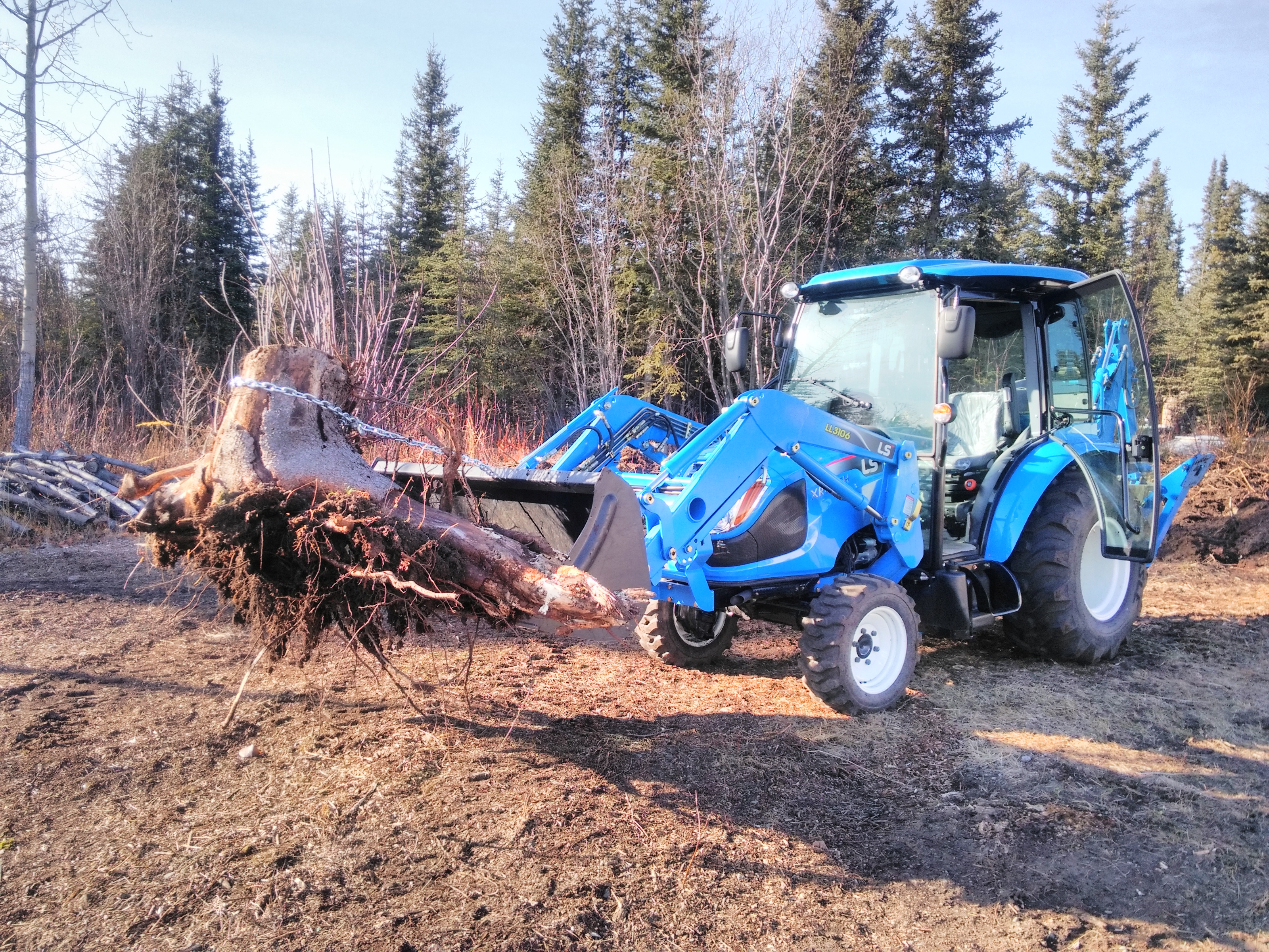

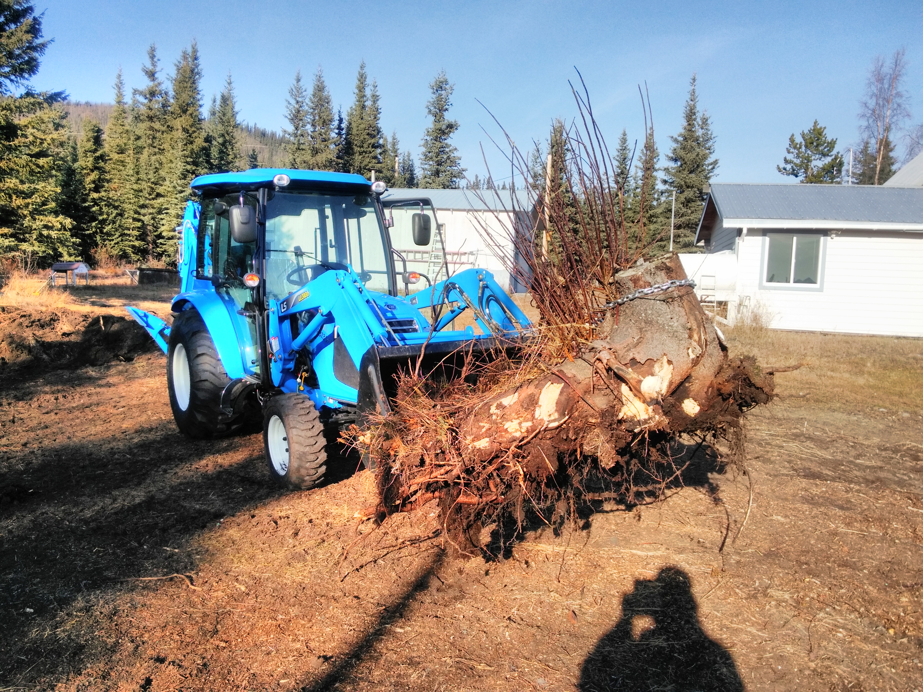

XR3135H. First Regen today@ 24hours. Duration of regeneration was 20 minutes. I was on the backhoe digging up stumps and the engine was running 2200rpm. The engine pitch changed slightly and the exhaust smelled funny. I was finished for the day so I parked it and idled it down (now @1100rpm). When regeneration was complete the regeneration lights on the dash went out and the idle speed dropped to 800rpm. Done Deal! IMG_20170821_191533.jpgIMG_20171009_150226_hdr.jpgIMG_20171009_150203_hdr.jpg
New Box Blade and a couple of Stump shots. Love It!
