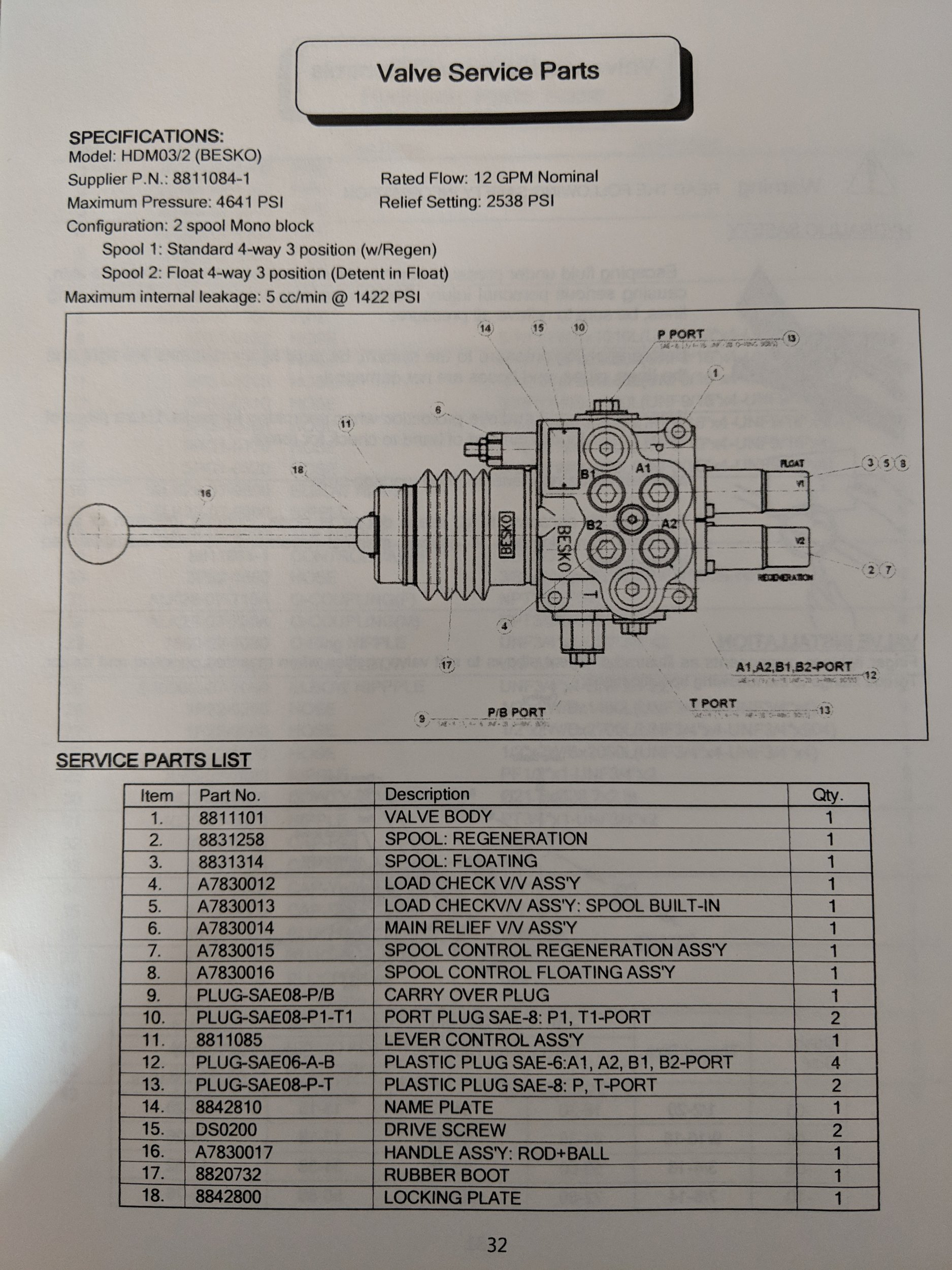

Hi Tom,
Well, today I charged up the battery and went thru the lock-out switch and starter circuit everything checks out still nothing I flip up the seat and start looking around in aggravation I pull off the wires with the seat switch one spade terminal looks crusty I grab a wire brush remove the crud from the terminals and the wire terminals put the connections back on flip down seat and turn the key on the damn thing started. Now I will move on to the hydraulic issue. It's a stuck spool on the bucket twist or rotation. I will try a disconnect on the lines first. If you have a detail on the front loader valve or hyd. flow diagram. would be great.

   / XJ 2025H lock out switches #27
Hopefully I can find some info. Info on the loader valve itself is about nil. Besko loader valve 801z1-8000 on mine. Have you removed the boot on the valve itself to clean and lube up the works?
When connecting hydraulic hoses: Loader down/retract cylinder, yellow coupler (1). Loader up/extend cylinder, green coupler (2). Bucket up/retract cylinder, red coupler (3). Bucket dump/extend cylinder, blue coupler (4).

Tom,
Thanks again I have a besko loader valve 801z1-8000 too. I checked the connectors blue and red a bit cruddy but clean up and reconnects ok. The boot and linkage are again cruddy but working ok. Still nothing no dump yet. I will research the valve before tearing it down. Research is sketchy at best it's a 2 spool valve not too much there. It will come apart and likely to find a stuck cross flow issue.
Scott
